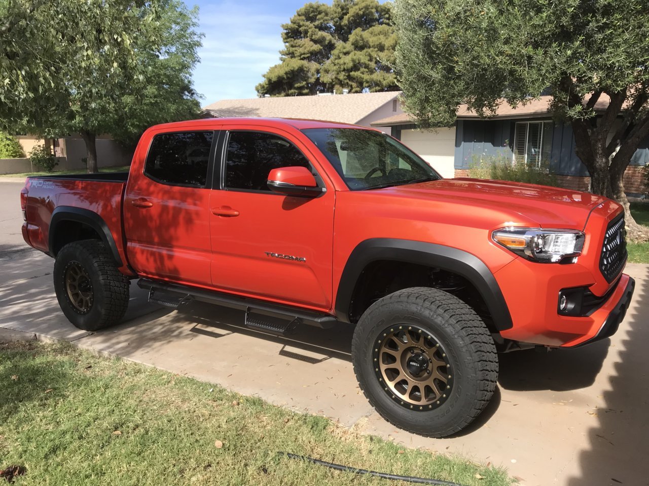

    285/65-18 Nitto Terra Grappler G2, Method 18x9 -12 offset, leveling kit. Had to trim a bit off of the inside of the front bumper/wheelwell, need to take the heat gun to the rear, still rubs there slightly, but no rubbing on the cab mount. E47AFAE3-82CA-48E0-8A08-DA7A8FE3DA74.jpg

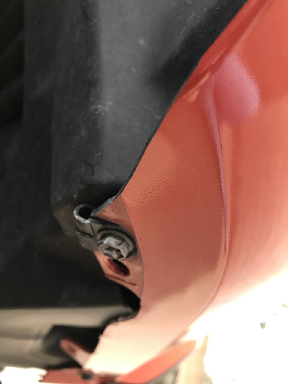

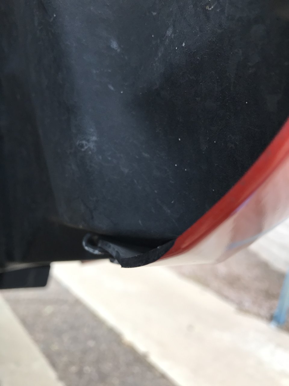

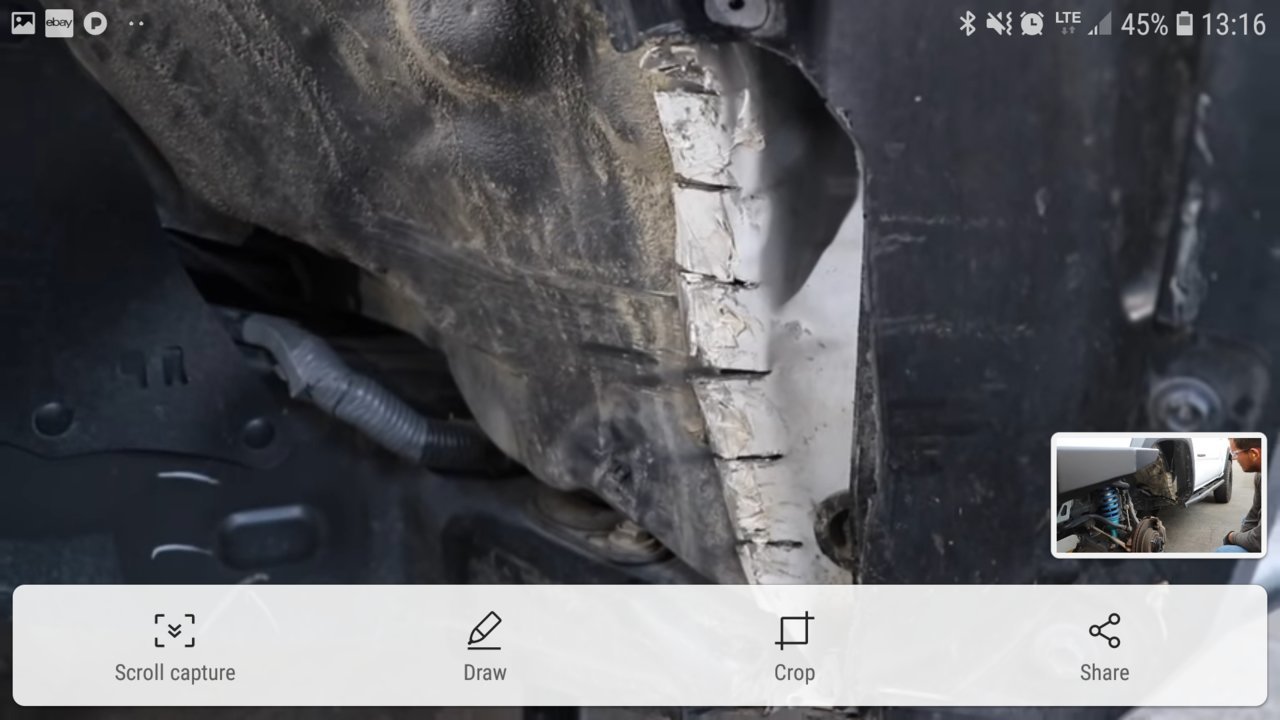

    Just had to remove a little off of this corner, then pulled the fender liner forward a little and repinned it.IMG_5347.jpg IMG_5348.jpg

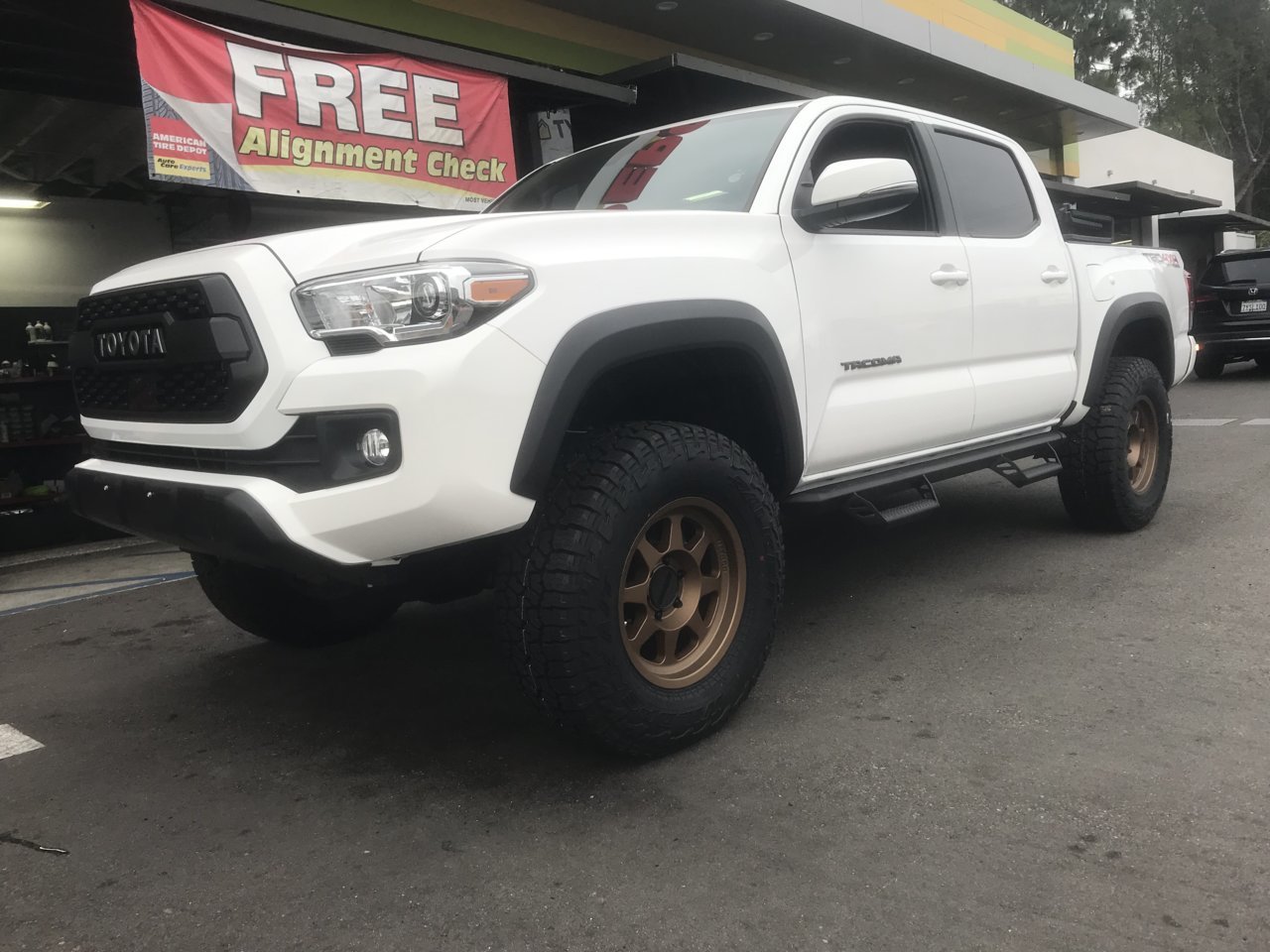

    Level , bfgoodrich285/75/16,cold air , matching lettering interior , pro grille , led out .ect
    I own 2018 Trd off rd 4*4 ,I had the 265/70/16 factory , I went with a 2.5 in front and 1” in rear , that pretty much leveled truck giving a great stance , then I put the bf good at ko2 285/75/16 gave me 2” additional lift , no rub at all , even better look , could not be happier with my lift on a budget .

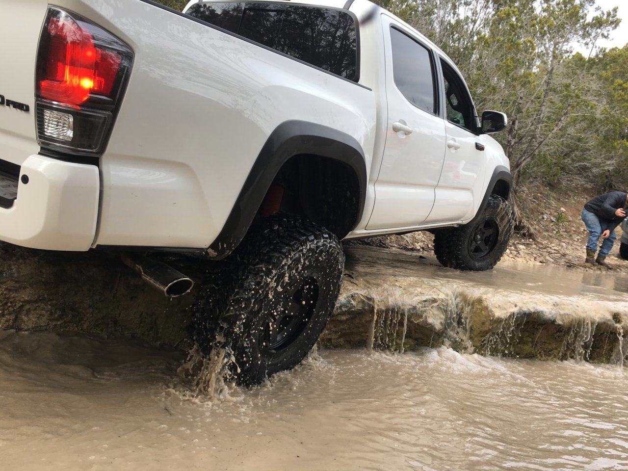

    285/75/16 mud terrains here with - 12 offset wheels. Never had any rubbing until I went onto some tough trails, then it barely rubs the mount. IMG_0936.jpg
