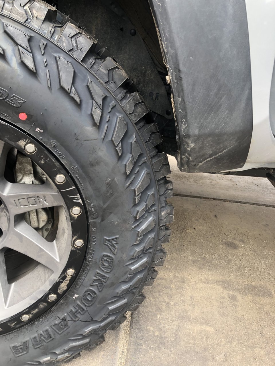

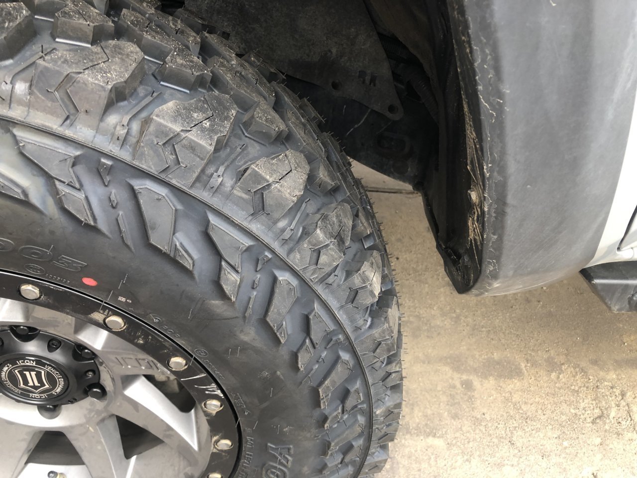

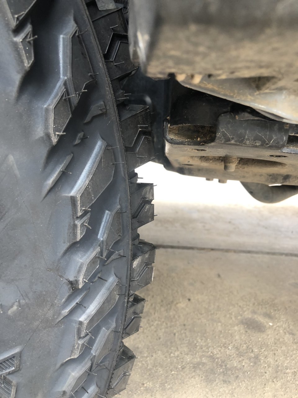

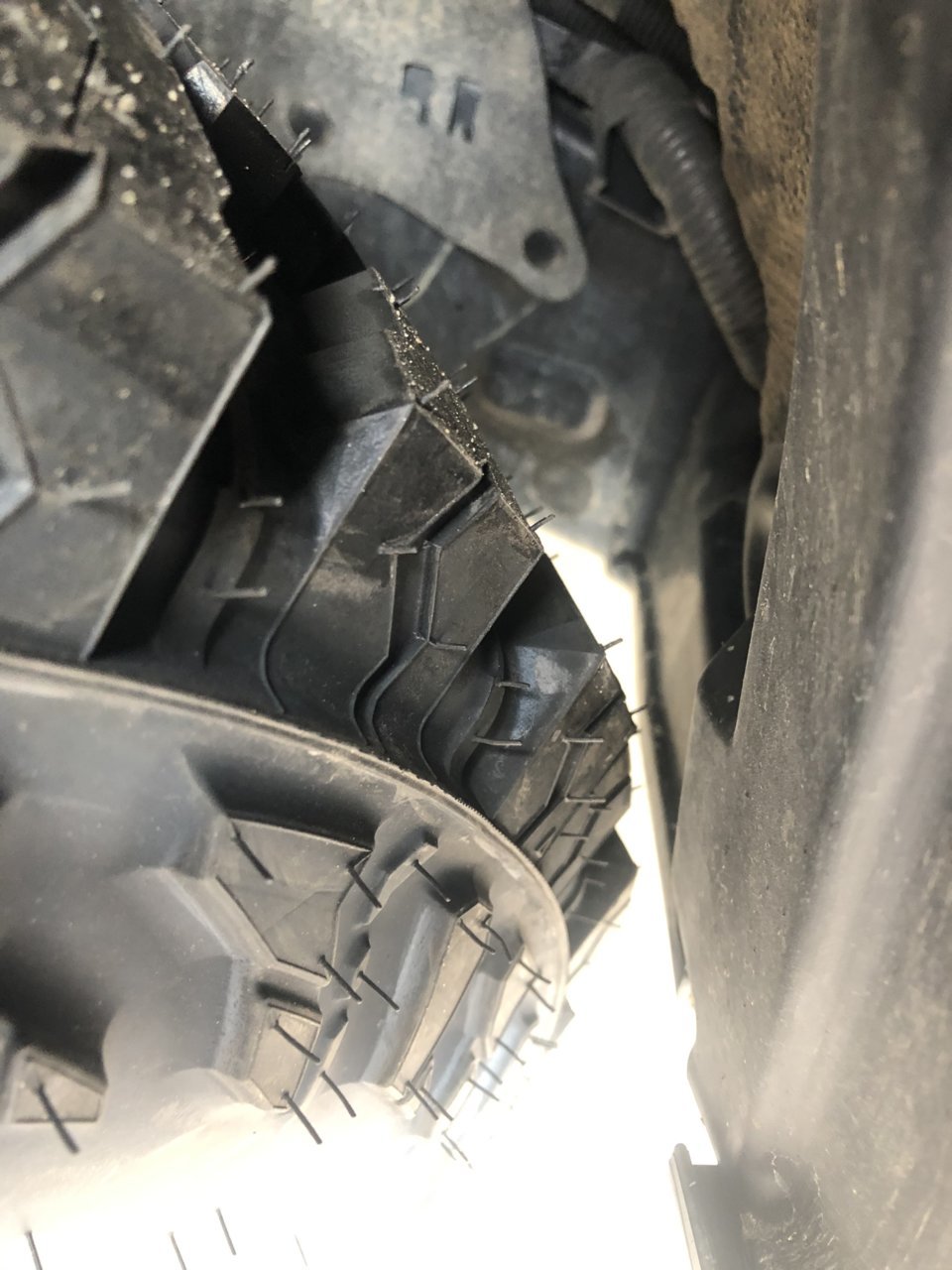

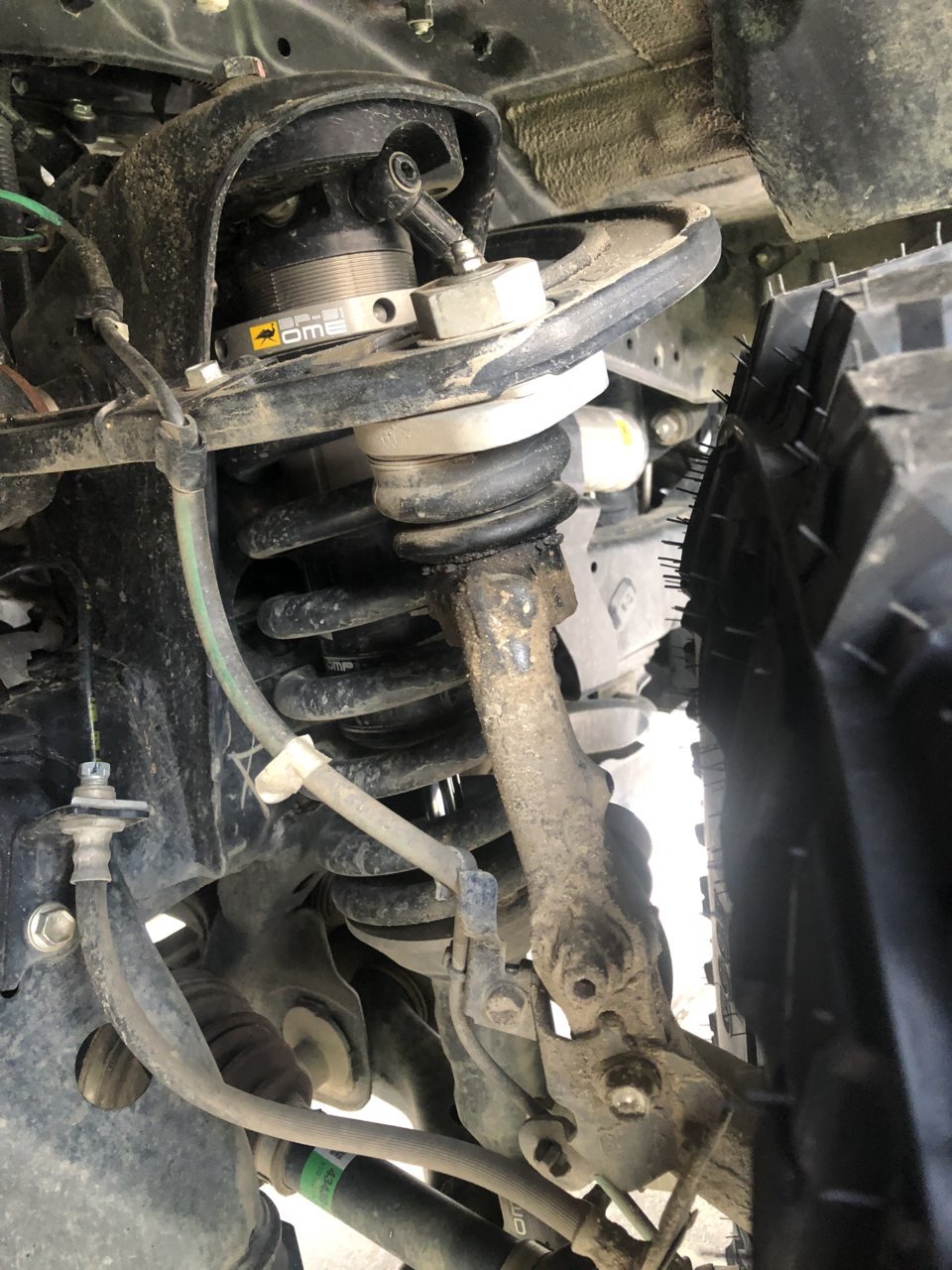

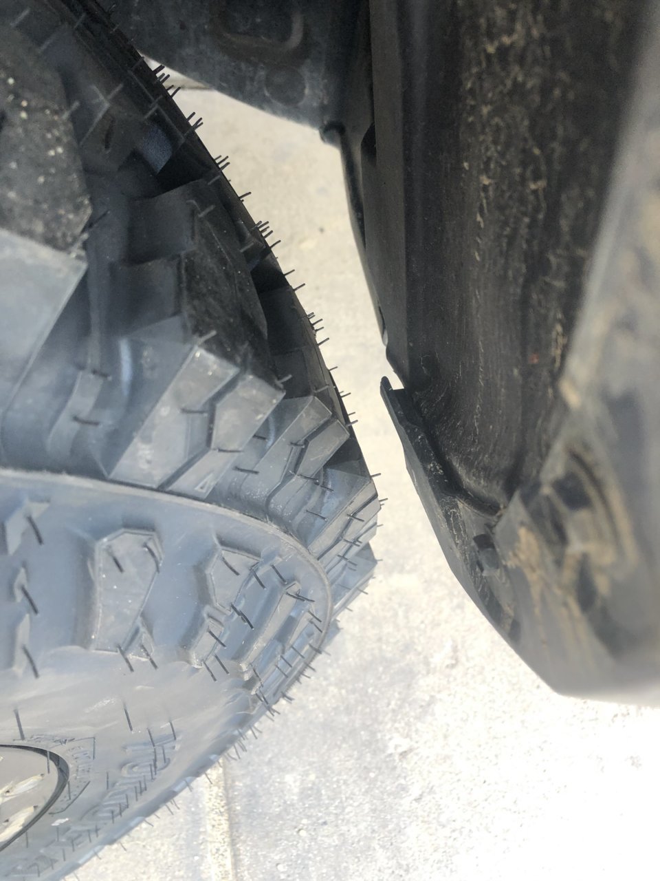

    ICON Rebound : 17x8.5 : 0 offset
    Yokohama Geolandar 285/70r17
    OME BP-51 Full suspension with extra heavy OME Leafpack
    SPC UCA
    C4 Fabrication Hybrid Front Bumper
    Not sure if I need a CMC but what do you all think. Even if I stuff, the tire seems to be at its max distance to the CM as shown in the pick. I need to go out and flex it a bit.
    - update : airing down may be an issue. Will cause the overall width to grow.
    $400 quote for a CMC - seems the highest I’ve seen so far.

    Yep,
    17 x 8.5 : zero offset
    285/70r17 Yokohama Geolandar MT
    SPC upper control arms
    Wheeled pretty hard for 2 days and got pretty stuffed.
    Light rub on plastic when I punched it around a corner with an incline on the other side, already taken care of with small dremel.
    Other than that, if I dont punch it I dont rub.
    No CMC!!
    Nice

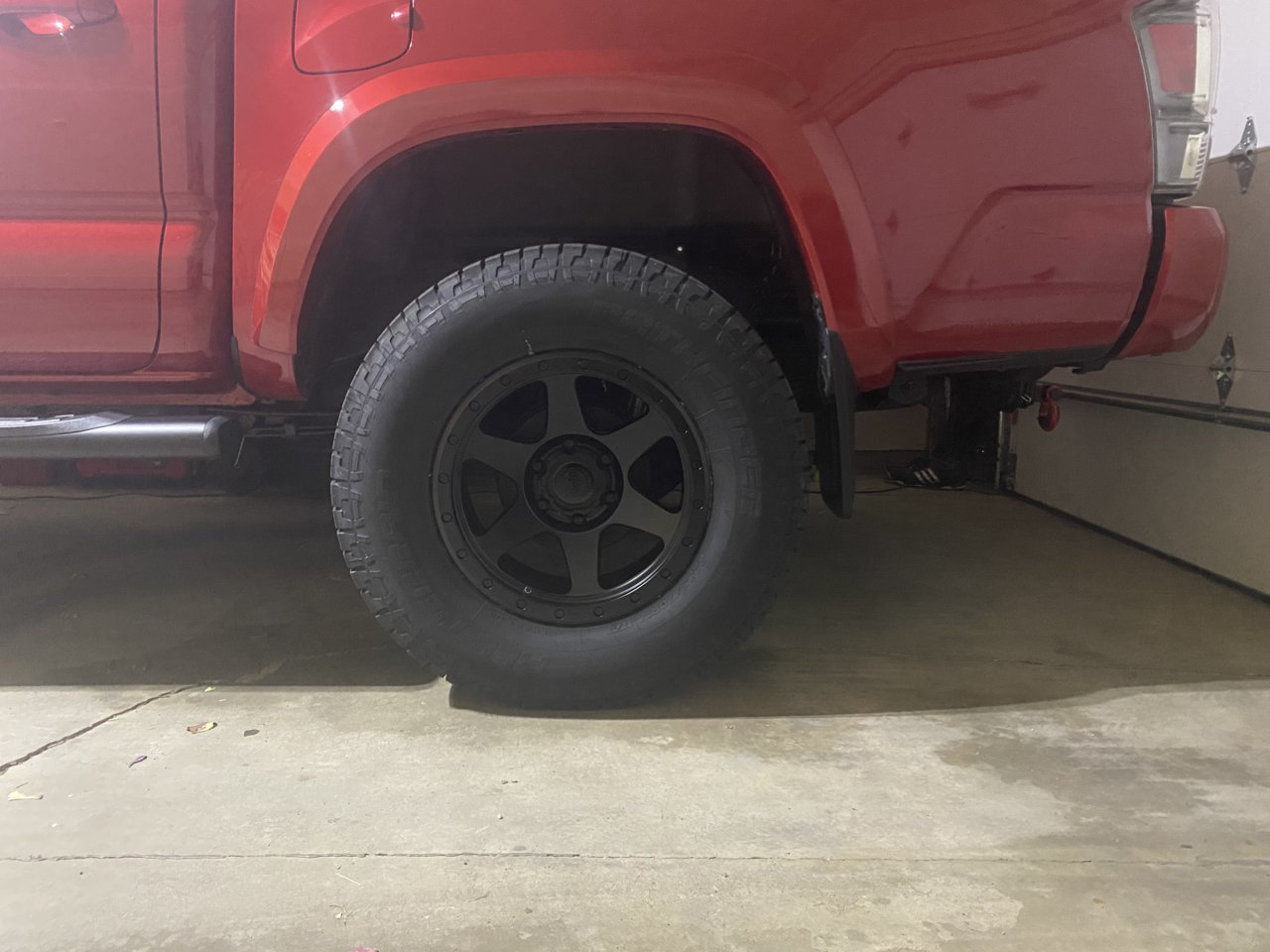

    Bilstien 5100s all around with fronts set to highest level and OEM springs. 2 inch AAL in the back. I have 285/70r17 Pathfinder Tires (Discount Tire exclusive) and -10 offset wheels. No CMC. I did have to re-mold some of the fender plastic using a heat gun though. It would only rub when I was at half lock and going over a bump though, after re-molding, no rubs.
    0845AFD3-242C-48B1-AD7A-92D01BFA326E.jpg 08E360D0-1074-4ADE-B30F-AFE6A2075A48.jpg

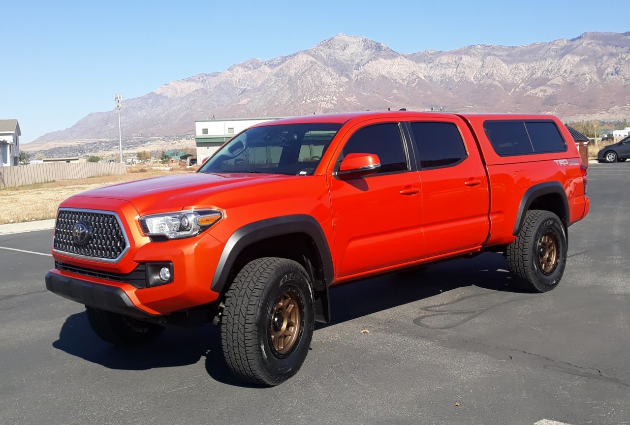

    17 x 8.5 KMC wheels, yokohama 285-70-17 geolander, 3" lift, 800 watts of alpine, leer shell, front & rear cloud cameras,
    2018 TRD OFF ROAD DCLB 3" front 2" rear lift with camburg uppers OEM Bilstein, stock springs, 17x8.5 zero offset KMC wheels, 285-70-17 Yokohama Geolander A/T GO15 tires
    Been on 3 wheels @ full lock very slight rubbing on OEM mudflaps..........with self clearancing option.

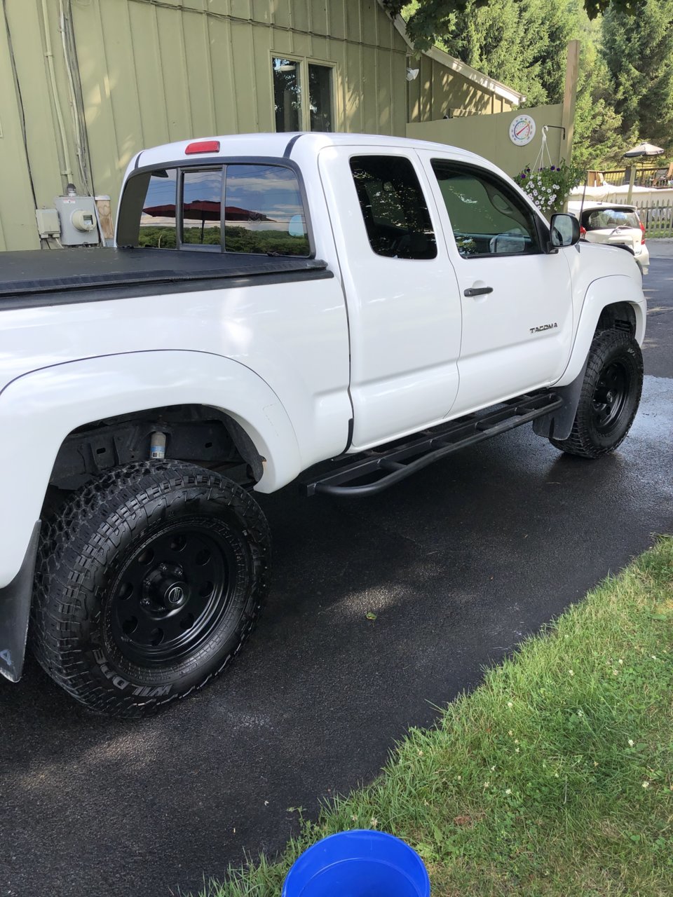

    2nd Gen 285/70 17 2.5” lift no CMC 17x8 wheel 4.5 backspace . Only rubs mudflap in reverse at full lock .

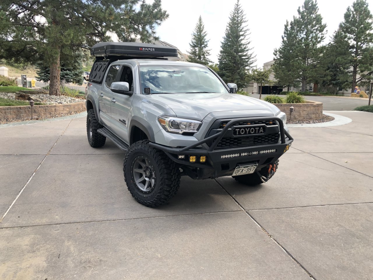

    Bilstein 5160s SPC Upper Control Arms RCI Bed Rack Smittybilt Overlander XL Tent

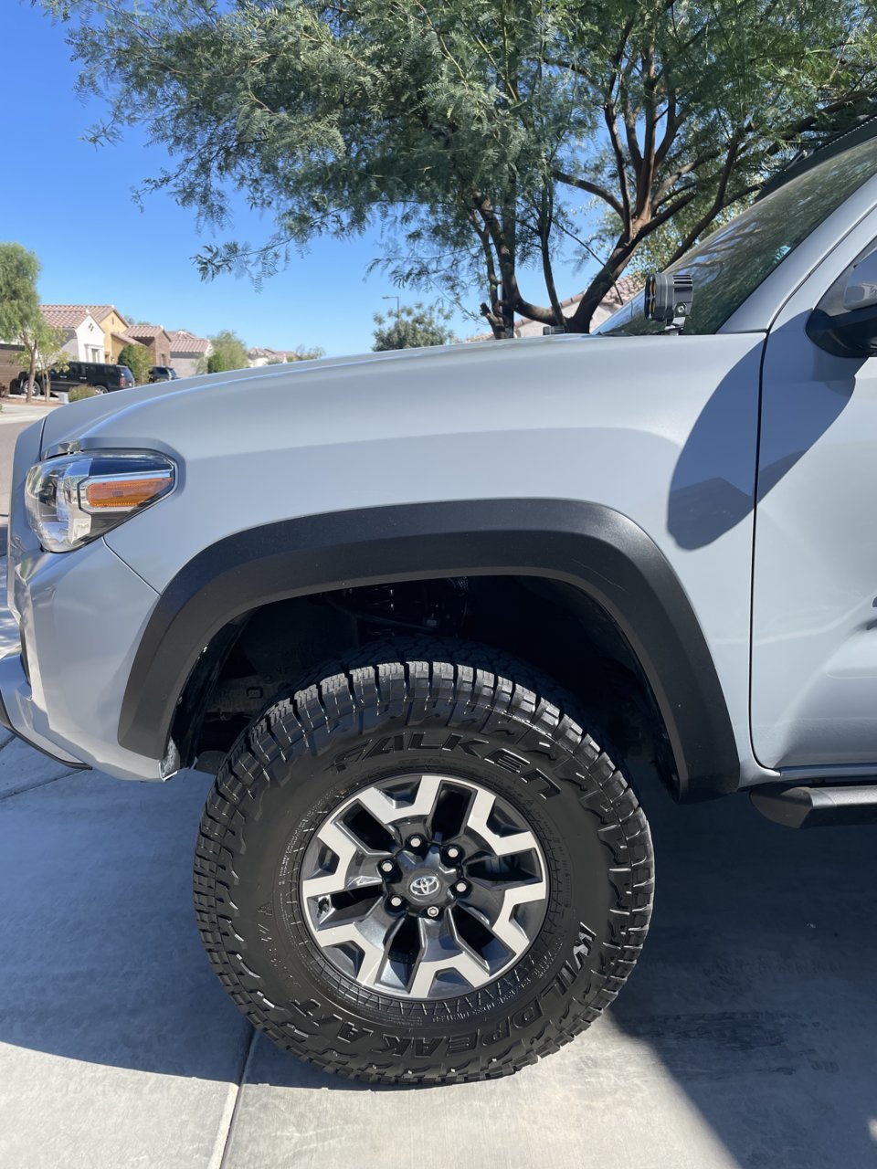

    I have no rubbing with Bilstein 6112 upfront and 5160s in the rear with SPC UCAs. Running 285/75/R16 Falken Wildpeaks on the stock rims on my 2021 TRD Off Road
    I didn’t want to get new wheels until I destroyed the factory ones. So this setup actually works out perfectly for my Overland Needs.

    Are you using wheel spacers? If so, what size are they?

    Rig looks great! That's actually the look I want for my truck! Do you think it would've rubbed without changing out the UCA's? I'm doing a 3"/2" leveling kit with TRD rims and 285/70/17's. Hoping for no rubbing or at least minimal, easy to fix rubbing! LOL!!!
