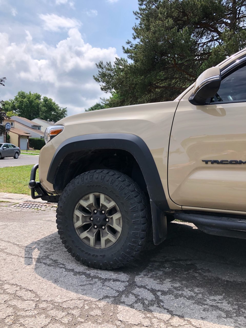

    My 265/75/16s look great under the 2" 5100s, but I'm thinking 33" 255/85/16 would look even better!

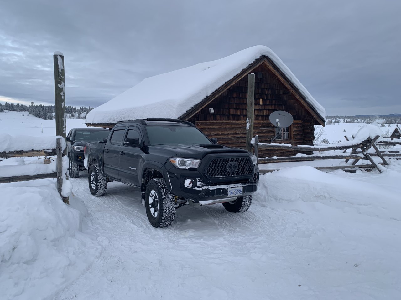

    My 265/70/17 look great under a 2” lift as well, not small at all.

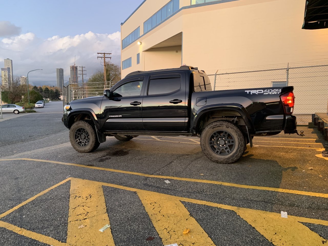

    285/70R17 Wildpeaks 0 offset. No rub. 3" Ironman lift w/ UCA's. That extra inch matters (That's what she said).
    Ironman 3" lift
