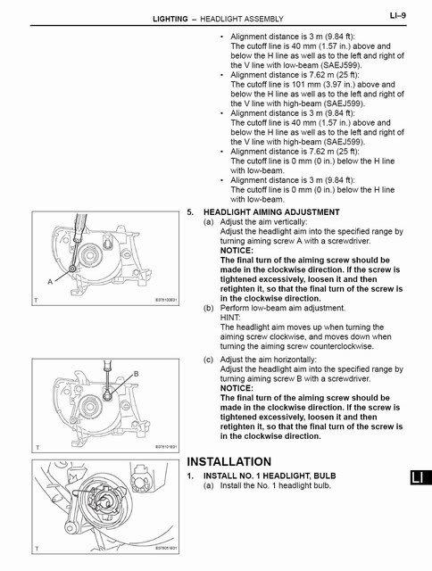

    I installed 6000K HID conversion kit in my taco and I'm endless having people flash their brights at me, to the point where it's becoming frustrating to travel at night. It's true, the lights are bright enough to burn the paint off the car in front of me, but it's annoying to have people bright me because I can't bright them back, the HIDs are low beams only, and they are brighter than my high beams.
    Are other people having this problem as well, and if so what are you doing about it? Or did I install my HIDs wrong?

    You probably need to adjust your headlights

    Adjust the headlights? How or what does that entail.
    Also I'm lifted so that probably isn't helping my cause. I feel bad for people driving infront of me.

    An adjustment might help...Might not.
    An HID conversion kit is a different kind of light. The reflectors in normal headlights are made for less potent lights. Throw HIDs into those relfectors and they are very much stronger and not aimed correctly. Get projector type headlights and it'll remedy for sure...Try and adjust the lights and you might not be blinding folks.

    I had to turn mine down quite a bit as I felt bad for oncoming vehicles. I will post a diagram.
    http://www.toyotanation.com/forum/t199139.html
    I used my hand to adjust it. If you use a ratchet I would remove the windshield wiper fluid bottle it is 3 bolts and a rubber gromet, you can leave the plug attached.

    Here ya go

    ^ thats better than going to the link above his post.

    I still have the cuts on my hand so it is imbeded in my mind but too much description to write here. You the man.

    Yea you just need to adjust your headlights aim them a little lower. Especially since your lifted your headlights are already much higher than stock. Let us know how that works. I have yet to be flashed and I drive almost every night with oncoming traffic. I aligned them the 2nd day I installed them... Best idea yet lol.

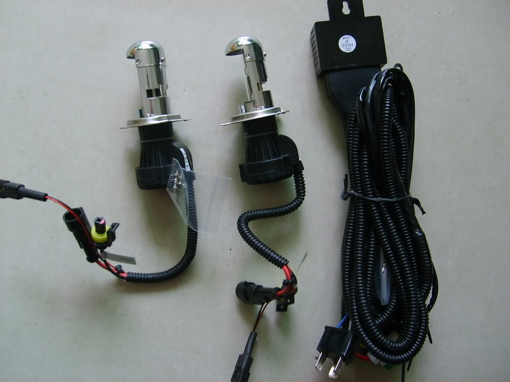

    Thanks for the feedback guys. I took my truck to the dealer this weekend and got my lights adjusted, took them about 15 mins and it was free of charge! I can see much better and the cutoff is where it should be now, however people are still giving me the finger and flashing me. My blulbs don't have the sheilds, does anyone know if that would help or make much of a difference?

    the shields are for the hi/low beam. im guessin yours is just the low beam?

    Can you fill me in on what the shield is?

    I have bixeon blubs but only have HIDs in the lows.

    The metal part is the sheild...I'm not sure of their exact purpose though.

    I pmd slim and he said they were to stop the lights from blinding on comming taffic.

    I personally think it has to do with the bulbs you have and your headlight alignment. If you didn't get the bixenon vs. just the low beams you are going to be missing the shields that the bixenon come with. The bixenon come with the shields to prevent the light from blinding oncoming traffic by creating a cutoff.
    Additionally I might add that I now run the 50w in my headlights and 35w in my fogs. I have honestly NEVER been flashed and mind you that I am lifted on bigger tires. Try to really aim those headlights low since you don't have the shields. If that doesn't help you might want to switch to the bixenon's. Hope this helps.
