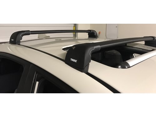

    Help me out here...i want to install crossbars permanently where the factory threaded holes are. Not the factory rack.I have seen it done. Not the type that clamp down under the door either.
    Can anyone provide me with some further details. Like what parts or models work/fit? Pic for example. 1ff55e38b63d24a63323ebf1df7b16c5.jpg

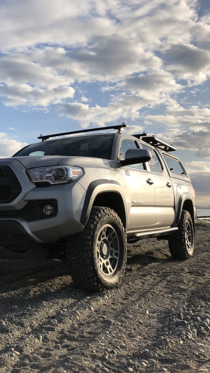

    I have these Rhino Vortex permanent bars, with the Rhino Tacoma-specific ditch rails. They are very nice. Quiet on the highway and strong as needed. I got a shorter bar for less overhang, than what is shown in the video.

    A picture. I got the shorter version of the bars to match the width of my Rhino pioneer platform on my canopy.
    These bars attach to a channel that uses 3 of the OEM Toyota threaded inserts in the existing roof ditch, but also calls for additional rivets. The sealing system they give you is good and better than those stickers Toyota uses at the factory. It takes some fortitude to drill your roof, but the results are worth it. These thing are rock solid, like all Rhino stuff.

    Then you are out of luck (to the best of my knowledge). All the systems add a ditch rail, bridging all of the 3 OEM insert locations for strength. The OEM inserts alone are too weak to support a stand-alone bar, which is why the Toyota ones include a massive plastic and metal rail, and the Thule and Rhino versions each include a low profile aluminum ditch rail.
    If you are only using one mounting point, the load rebound (when you go over a speed bump, or hit a pothole) will pull the OEM inserts right out of the roof, from what I’ve been told.
