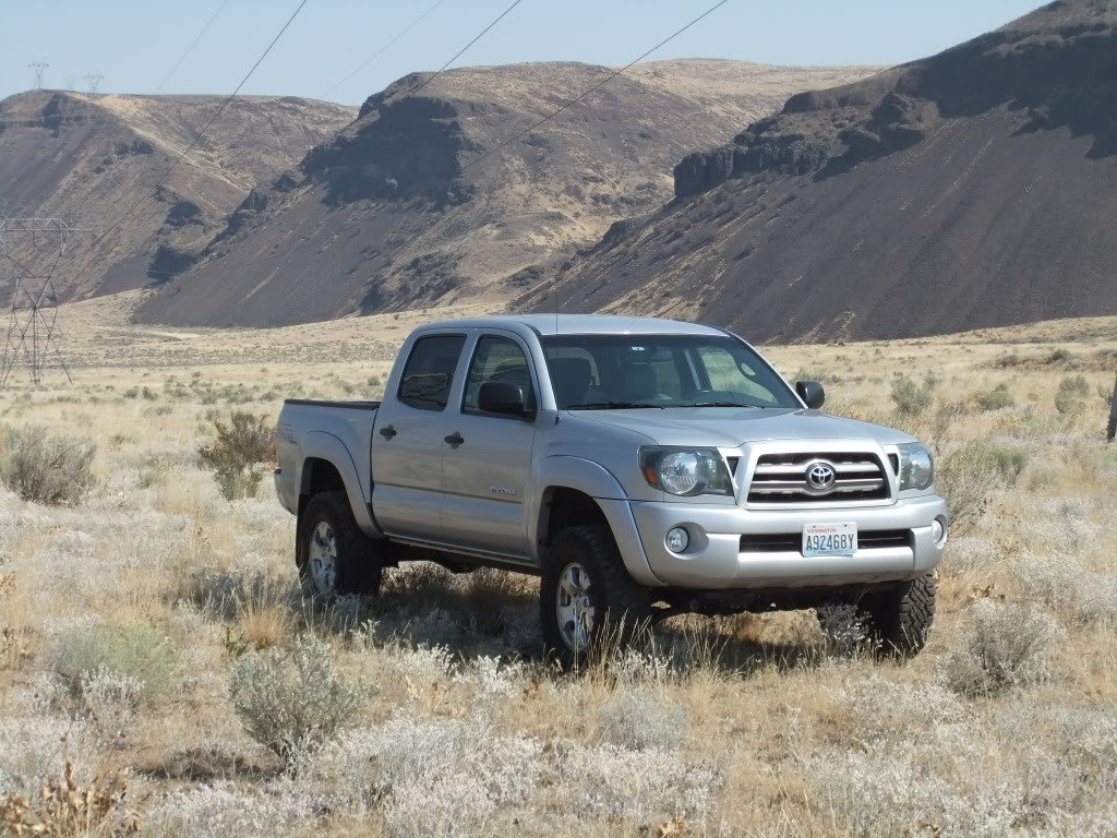

    I've had a Wheelers 1.5" 3-leaf AAL in back for about a year now -- I love em and they ride great. I had my front 5100s set at 1.75" lift, and I liked the nose-low negative rake with that configuration. The rear sat about 1.5" higher than the front.

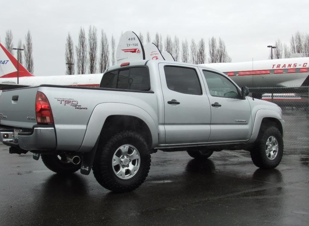

    Then recently I increased my front to 2.5" and put my overload leafs back on with my Wheelers AAL's. The overload leafs are a little more than 1/2" thick, so I figured it would increase my rear ride height by that much.....buuuut now my rear and front ride heights are almost level relative to one another :confused: My rear sits *maybe* 1/2" higher than my front. What the heck? Did my rear springs/AAL's suddenly sag after I put my overloads back on??? Doesn't make any sense.

    Here's a before pic with just the AAL's (no overload leafs) and front at 1.75" -- definite nose low:
    And an after with the 1/2" thick overload leafs added and the front raised to 2.5" -- looks pretty much level compared to before pic:
    I realize in the second pic it's parked on uneven ground but it looks exactly the same when it's parked on level pavement. WTF is up???

    So the front is set at 2.5 and the rear is a 1.5" leaf pack with a .5" thick overload? So 2.5 in the front and 2.0 in the back..sounds like it should be level if not slightly raked. Even with the stock rake the wheelers leafs are progressive right? Tow anything lately?

    From my experience with an AAL they gradualy lose strength over time. I had the same set up. AAL in the rear, front 5100's set at 1.75. Had a light forward rake for about 6 months. Then the AAL lost all strenght and I was bottoming out againand had a slight rear rake. You leaf pack might be shot so it might be time for a whole new leaf pack. OME Dakar is what I replaced mine with, and I couldn't be happier. Its a 7 leaf pack and super strong. I can load just about anything I want to in the back and it doesn't bottom out.
