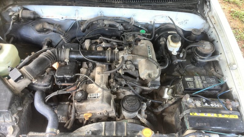

    Ok here is an update on the situation. I'll try to be as detailled as possible. First of all you should know that unlike many of you I'm not a (semi) professional mechanic, I did not grow up with a dad who fixed cars of motorcycles and even though over the years I learned quite a bit and fix many things (a Lada does that to you) I'm still as much an amateur on fixing cars as I am on working with Linux (yes I'm eager to learn all kinds of things, but a slow learner). My true profession is philosophy however since I'm not yet ready to live in a cave I started a hotel in rural Panama. A beautiful mountainous area with a pleasant climate and tough roads that are hard on any car.
    So I fixed the leak near the EGR sensor, just a warn gasket, and I had the exhaust welded (a temporary fix, if anybody got a spare manifold lying around please let me know)
    But the symptoms remained (P0171). So here is what happened last night when driving home form the nearest city.
    I started the car and the RPM is too high when running stationary, and fluctuates slightly. The first part of the drive is all flat, yet the engine was having slight sputters here and there. As the road became more hilly, the sputters became slightly worse. Then I got to the steepest part, a 600 foot increase in less than a mile. Many cars have to take it in second, a healthy Tacoma can easily do it in third. To my surprise I made it up in third without a single sputter. But on the next less challenging hill, it almost stalled out.
    For 20 minutes after that the car ran as it is supposed too and I could drive like a maniac. Until at a slight hill it again nearly stalled out. By then I was almost home and didn't have any serious trouble.
    One more thing, the air-conditioning compressor won't engage anymore. When I turn it on the engine RPM goes up rapidly, then falls flat again. I don't know if this has anything to do with it but I thought I should mention it.
    I know its a long shot bu if you see anything unusual on this pic let me know.
  10. Dec 29, 2016 at 12:17 PM
    mechanicjon
    mechanicjon They call me "Jonny Stubs"
    Dec 2, 2016
    #203828
    10,083
    Jon
    Scottsdale Arizona
    04 Taco SC 4dr SR5 TRD Prerunner
    Supercharged, AEM FIC/6, Meth Inj, ION Alloy's, Radio & Phone steering Wheel controls,Fabtech AAL, Billie's wrapped with 880's , Tundra big brake conversion, bully bars and Pioneer DDin Stereo/dvd with exterrnal usb ports. 290K and going strong.
    Still sounds like a vacuum leak. The ecu is excepting a load from the a/c compressor. When ecu doesn't see the idle stay were it should it will drop the idle back down. Different issue then your code.
    Do the brakes feel normal.
    Does it sound like there's abnormal hissing sound from engine?
    Have you compared vacuum diagram on hood to engine? everything is routed correctly?

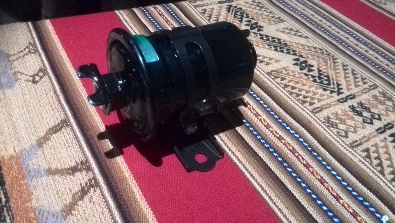

    Is that a fuel filter on drivers side by battery? Have you changed the fuel filter underneath the truck?

    • If you mean the fuel filter in the gas tank, yes that has been changed. The standard fuel filter has been substituted for this inline filter.

    So the regular fuel filter under the truck (not in tank) has been bypassed?

    You mean this one?

    Ya that filter. Still has code?
