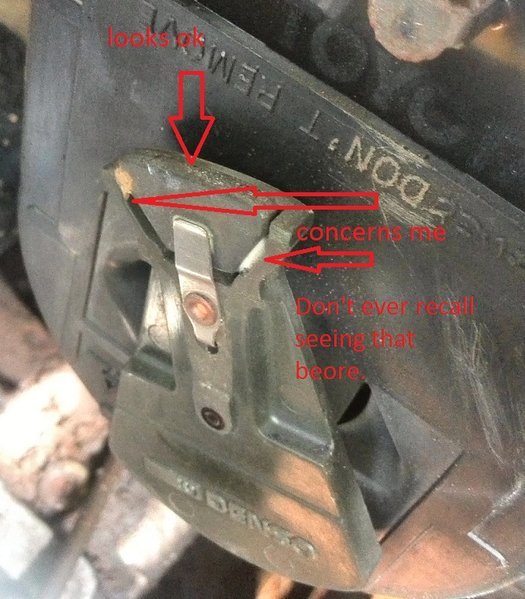

    Does this look the way it's supposed to look?

    And the coil is hidden inside the block on the front?

    ok to remove that cover just put it back.

    I can't take the cover off without breaking it. Perhaps i'm missing something

    Temperature related. If possible test ignition coil when hot or replace with known good one. Distributor rotor looks suspect. I would replace rotor and cap regardless.

    Where did they hide the ignition coil on this engine?
