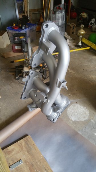

    Here is the same exhaust with more information. The brand is Black Race Racing (pretty funny name) and I like the fact that it is specifically for my engine. My exhaust no longer has a catalytic converter so fitting should be easy.

    I also found this exhaust from a brand named Speed Daddy. But stainless steel for an exhaust?
    Eventually I figured out I could get my arm in at a certain angle reaching a lot further. The sharp edges combined with fuel residue made it very unpleasant on my upper arm. Nasty work really. But all the frustration this problem had given me kept me going.

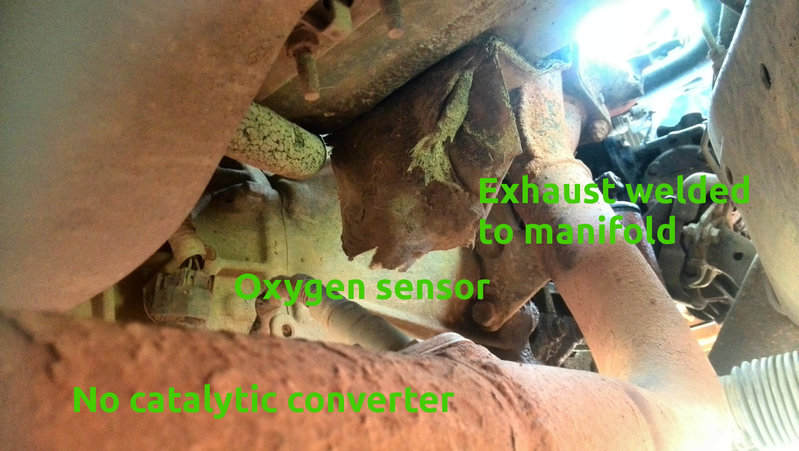

    I immediately notice on the picture that it won't connect to my exhaust gas relay. I could block that off I suppose

    so from where the header connects with the down pipe all the way to the exhaust is one solid piece?

    Yes exactly. I haven't found any 2001-'04 header so I'll probably go with the stainless steel since it involves welding work regardless.
