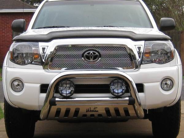

    I am going to be fitting 510's in my new Aluminess front bumper, I would prefer to be stock since I really don't like blinding people, but unless I fab something, PIAA it is.
    But what is concerning me now in reading this thread is the claim of water cracking the glass. The time I use my fogs the most is in heavy rain storms or snow which I drive a lot in. Often a layer of snow and or ice will build up on the fogs which I suppose could melt with these lights.
    So what is the point of having these so called off road lights if you can't use them in inclement weather? Or are they ok?

    They are fine in inclement weather, the concern is when you put 510's in the stock fog location, they build up a lot of heat. On a hot day (or night) if you have them on for a while then run them through a car wash with cold water, that sudden jolt from really hot to cold can cause the lens to crack. It was just brought up as a precaution for people putting 510's in the stock fog light location. I've been running a set of 520's for years and have not had any issues with the lenses cracking in the rain or snow.

    Ok, I should not run into that as I rarely go to hot locations, certainly don't run fogs in the day. The hole in the new bumper would fit 540's but I have read people having too many issues with blowing fuses in the OEM fog harness which I really need to be able to use. I don't need the power of the 540's either, so I think the space around the 510's in the new bumper will help cool them as well.
    I also don't use drive through car washes, only the hand type.

    510's and 540's both use 55w bulbs so if you are going to have issues with the stock wiring and fuses, both lamps will have the same issues since both have the same power draw.

    Can't help you there, I wired mine separately. I'm running 45w fog lights without any issues. I'm sure someone will chime in, somebody must have tried using the stock wiring for this set-up.
