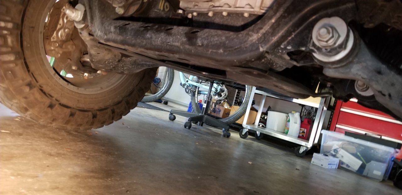

    Are the alignments bolts on the back way way off just by looking at the pic.
    I have a hard hard left pull that hasnt gone away for some time.

    Maybe get it up on an alignment rack and get some #'s

    thats the thing..numbers check out.
    My alignments always been weird. As soon as i get this sorted ill take that advice for sure.
    The rear of the right lca looks way high compared to the left.

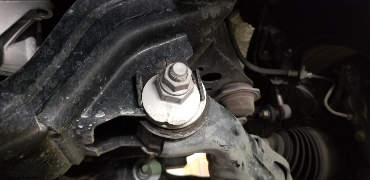

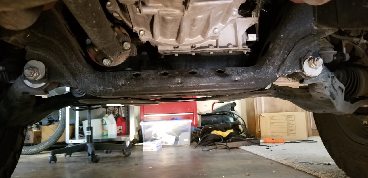

    Left:
    Right:

    may have anwered my own question. Looks like the right cam bolt was installed upside down after the lift. lol
    or am i seeing things :\

    You're not seeing things

    based on the position of arm from the rear, it looks way off and i see how it can easily affect the geometry of the suspension.
    now wonder this thing has been way off.

    the cam bolts are upside down but you can still get the numbers in spec with no issue besides it looking wonky and not doing the job "right". The best way to see why it is pulling hard to the left is get an alignment and the actual alignment numbers and post them here. If all the numbers check out then there could be something else at play (dragging brakes, etc.).
    Get the alignment with the numbers and report back.

    Well this took me like 20 minutes to change out.
    For now I pretty much just matched up the settings same as the other side. Went for a quick drive..it seems like the pull is gone. Though I'll confirm with some more driving. About 17k with this damn pull.
    No one will treat your truck like it's your own..amen.
    Edit.. okay just went for a drive that I do every day a lot of straights. This thing is definitely fixed and checked out finally. Woohoo
