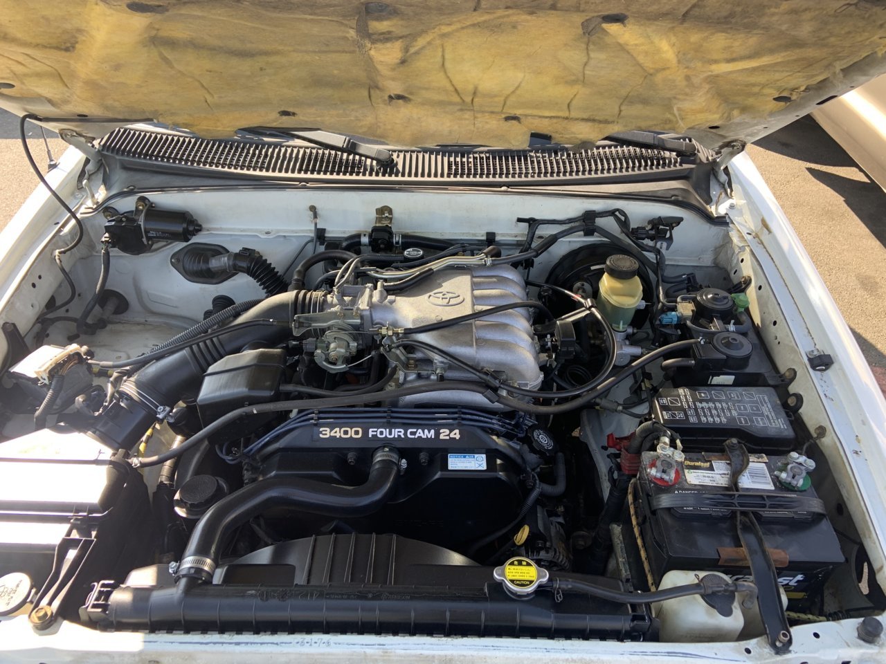

    first off, how do I know if the timing belt and water pump have been replaced? Carfax does not have that info, and the dealer I bought it from does not know either. the truck has 177k mi on it so I would like to play it safe. do you all recommend Toyota replacement parts in this case? where do you all get good prices on motor parts and possibly some exterior body parts like front bumper rear bumper lens lights head lights...and I am also missing the inside latch that locks the rear sliding window in place so thats no bueno...gotta address that.
    truck did have mild driver side front damage mentioned in the Carfax and I can tell but it doesn't look that bad so I'm sure it really was mild, but the bumper needs a little attention.
    and does anybody have a ballpark estimate for parts/labor to replace the timing belt and WP? and what else would you address/inspect on this fairly used 5 owner truck lol I am the 6th..shes a hoe but runs great

    Ebay, there's a vendor that sells a kit with Aisin parts.
    Easy to find.
    Some people have found labor for a waterpump/timing belt between 400-600, supplying your own parts.
    Should do it yourself; tons of people here willing to offer advice not to mention Timmy's youtube video walk-through on everything and anything Tacoma/4Runner related.

    is there anything i can do visually/mechanically to determine if the TB/WP were replaced...within reason

    how do you know if you have an oil cooler? where is it located? thanks
    edit okay so its down by oil filter...2 hoses coming out of it? v6 motor btw

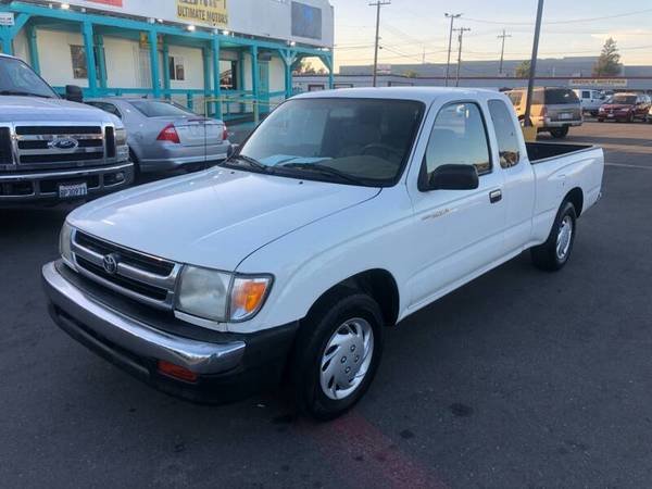

    That truck is cleannnn. Great find!
