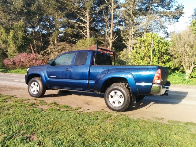

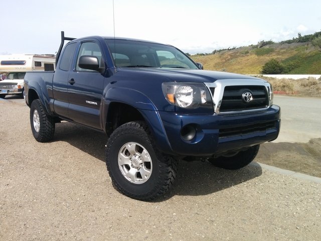

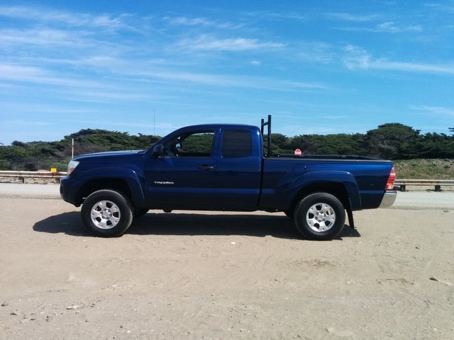

    Before OME

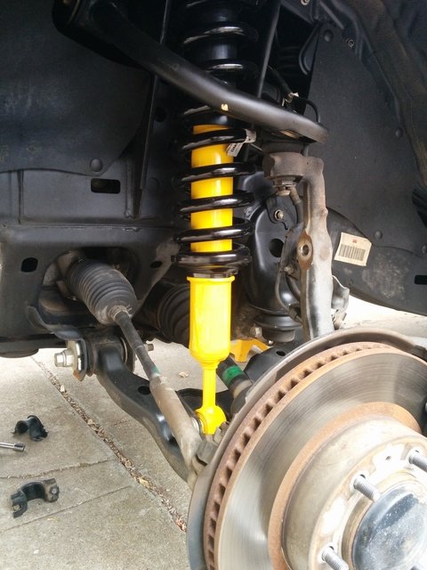

    Kept the swaybar off, don't need a stinking swaybar :p

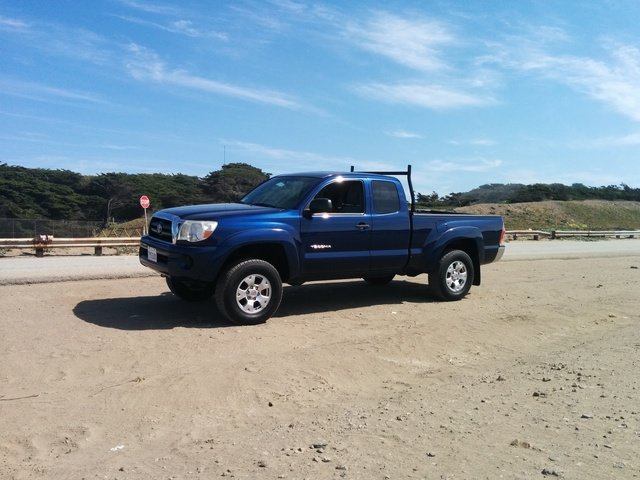

    OME 884/Nitros brought the front up 2"

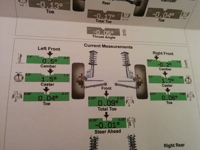

    Alignment numbers with original upper control arm
    Guess an AAL would be the best option for a 1" lift in the rear?

    Looks damn good.

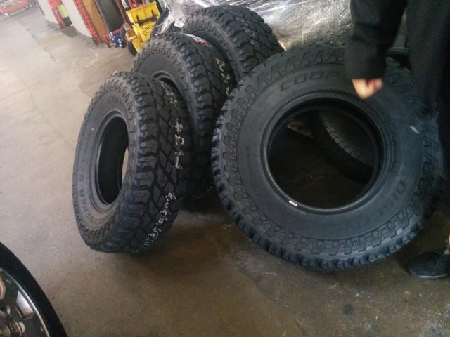

    Tires arrived.
    The guy said "I don't think there going to fit"...LOL :D

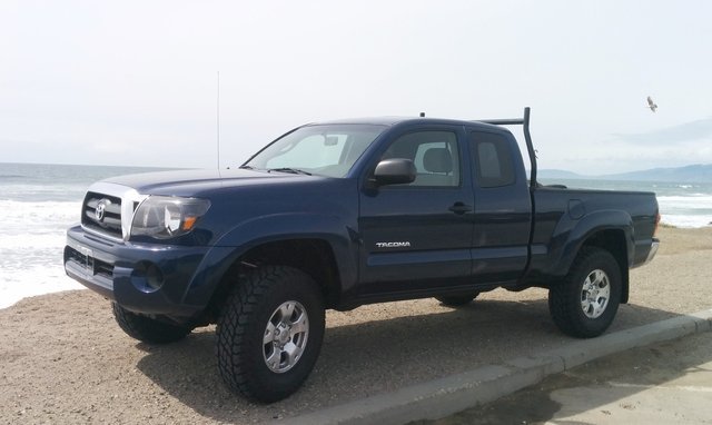

    How she sits now
    All Tacomas should have came with these tires STOCK :D
    Gears and a rear locker will wait, depending on my buddy's schedule...

    Damn nice truck! That's how all tacomas should look from the factory

    I like that mild lift a lot. Anything new as far as the rear suspension goes? Tires look perfect to. Any rubbing there?

    Short time behind the wheel, but since new tires are E rated...road manners do seem stiffer.
    I haven't checked to see what they set the pressure on these tires, maybe I'm running at 50lbs :p
    Haven't noticed any rubbing, but only first day (actually 1/2 day).
    I hope to go offroad in the next month...will keep you posted.
    Thanks :)
    Suspension is all new...installed myself.
    Frame is in really good shape...better through some por15 on it, before the salt air gets any ideas.
    Too soon on the mileage, but was pleasantly surprised how well the stock 4.10 gears handle the taller tires.
    I love the immediate lift, provided by the tires...feels more like a truck now :)

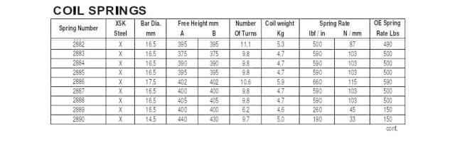

    Correct.
    After installing the nitros and 884 springs (and a 1/4 spacer to address the taco lean)...my front lift measurements are as follows (hub to fender):
    FD 23.0 FP 23.0
    Since I'm a 4cyl, the 884 springs gave me a full 2 1/2" lift.
    If you review the OME specs below, you will notice that all Tacoma springs have a 590lbs spring rate, just different lengths (except for the 886s - 660lbs).
    If I lost 1/2" (after installing a bumper), I could install the 885 springs to return back to the previous height.
    If I lost 1", I could go with 887 springs.
    From what I've read, you go with the heavier 886 springs when your installing a bumper and a winch...due to the spring rates.
