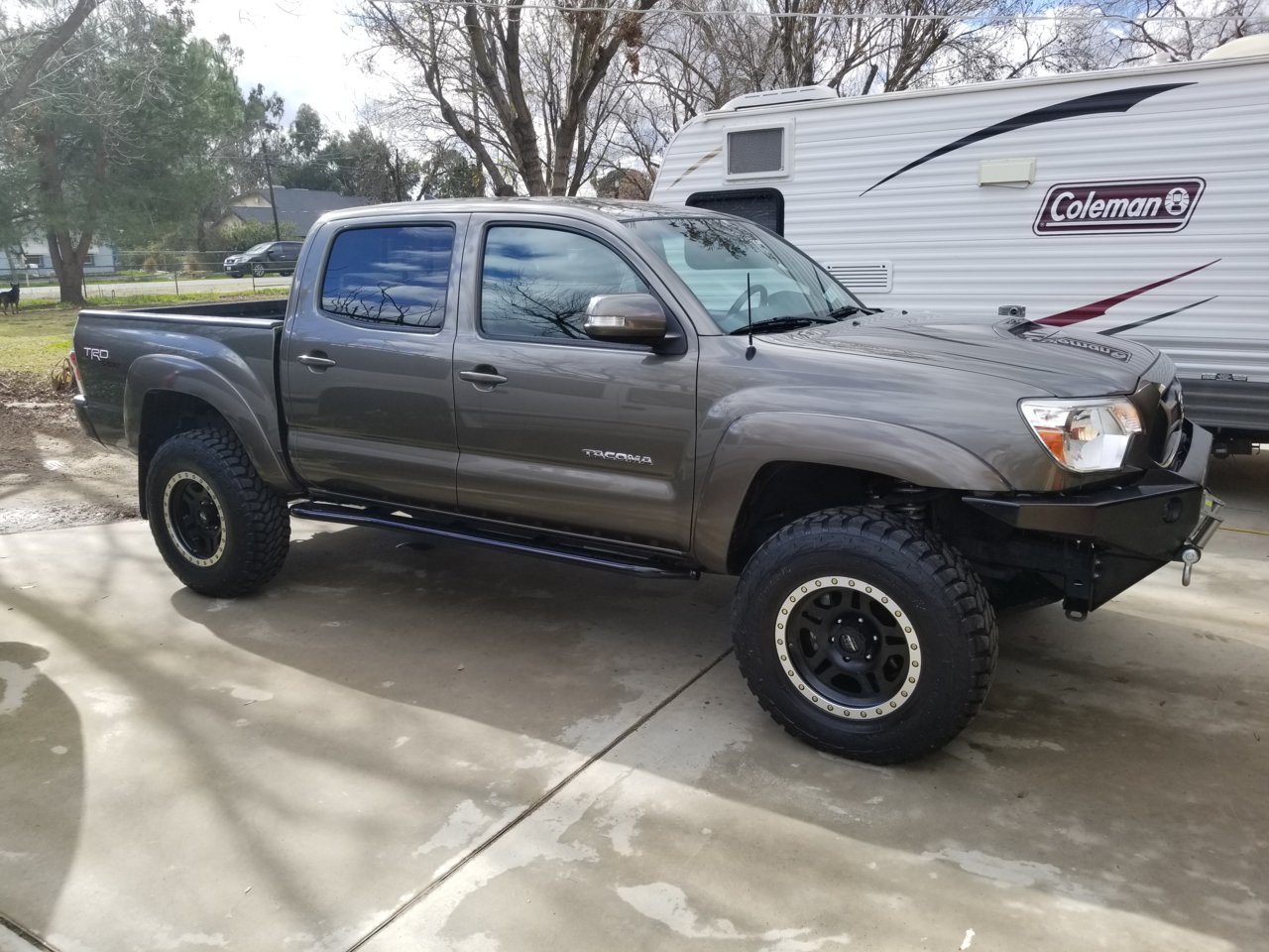

    I have Fox 2.0s and love them. Mine are set at 3" and I have lots of steel plates, bumper and winch.
