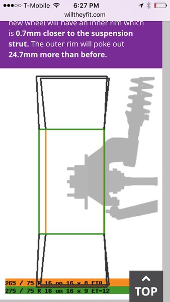

    The wheel (rim) is
    one is 8" 0 offset 4.5 bs
    Other is 9"rim -12 offset 4.5bs
    Back space is same
    You need to make sure rim width isn't to wide for tire choice

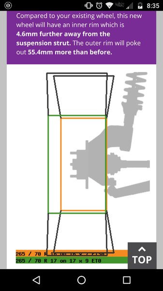

    Yeah I looked it up and they work I'm going to fit from a 265x70x16 to 265x70x17

    I'm gonna go with 17 all it is is an inch bigger all around which I have a 3 inch lift so it makes room to fit
