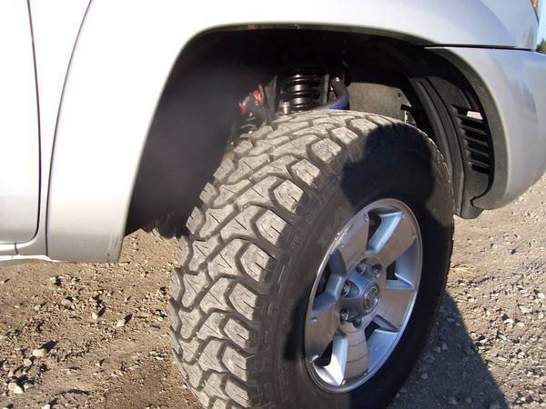

    Got the add-a-leafs done at work tonight, took about 1.5 hours (impact makes all the difference) and looks awesome! Really glad I chose to put it on! I will try to post pics up in the next day or so. Oh, and I got right at 1.75" lift out of it.
    The tires I am running look like MTs but I believe are actually considered an all terrain. They are possibly one of the most aggressive looking all terrains. I chose them since the tread pattern looks similar to the very popular KM2 which is actually a rock crawler inspired MT if I am correct. I will try to get some close ups for you in the next day or so.

    Sorry man, my "MT" meant mickey thompson, not mud terrain. You're right though, after I saw them in person the other night the ATZ's are some of the most aggressive all terrains around.

    Compared to the BFG AT's that I had the MT ATZ tires seem to be a little stiffer and they do sing to you (make a humming sound) when driving on pavement.

    My bad, I shoulda known that.:)
    Yeah, they do hum a bit, I didn't expect that but it's not too bad.

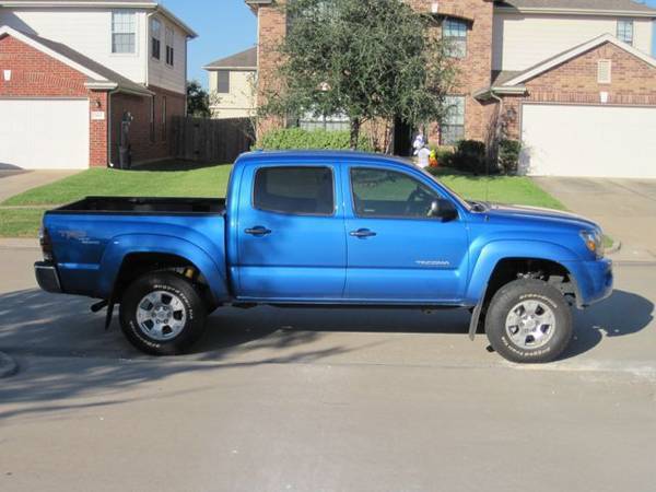

    I think Sandfire said he used 885 with no top spacer. What is your height in front/rear ground to Fender.. I would figure out what you want to do from that measurement first. As far as I can tell, it appears people get different results.
    Just for comparison's sake..see below
    These are 886 with the top spacer. I have not done the TSB AAl yet, this week.. this is with the TSB rear end only.

    SamSter is now sitting at 37.75 in front with 886 coils, top spacer and stock tires (he PM'd me his measurements.) My truck is sitting at 38.75 in front with 885 coils and 285/70/17 tires.

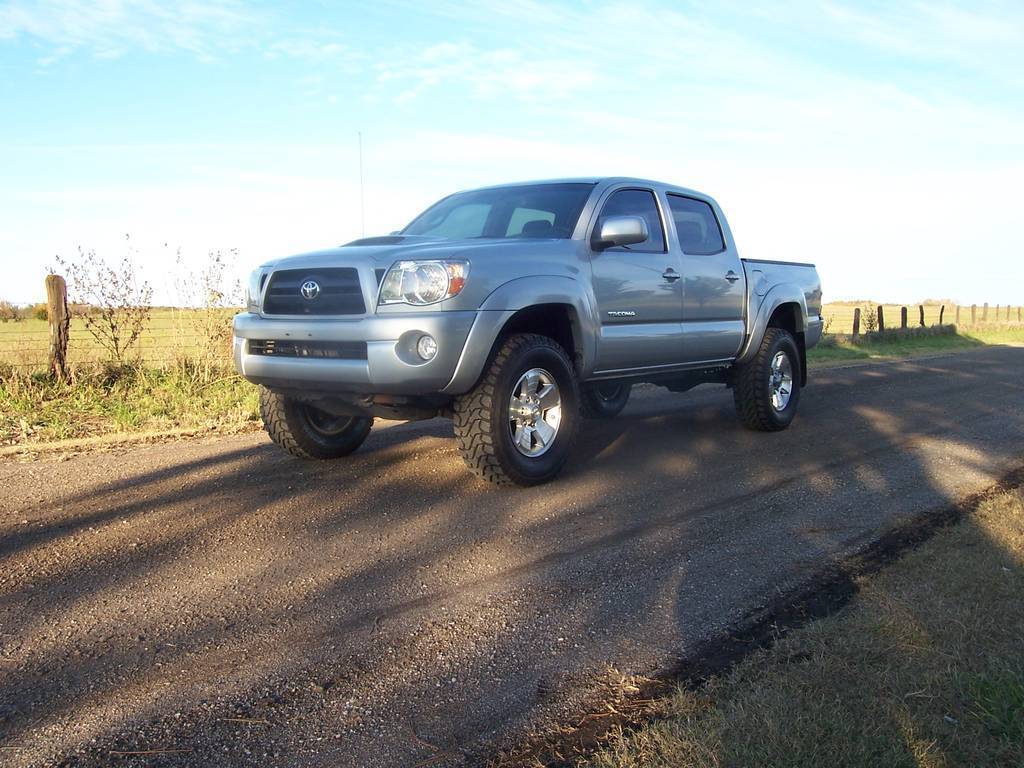

    Here ya go.

    Pictures with add a leaf done.

    Nice ride. I like it alot.

    Looks Kick Ass Sandfire!

    lovin' the truck man. Did you have to trim alot with the stock wheels?

    looks good. Watch for the 885's to settle a bit. Mine sure did- about an inch!
