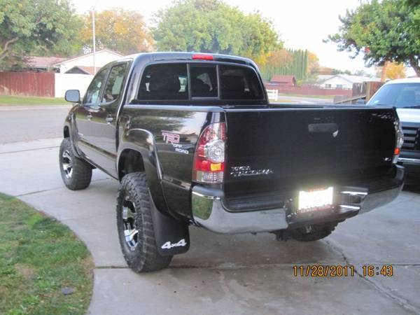

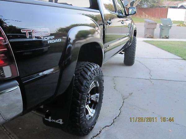

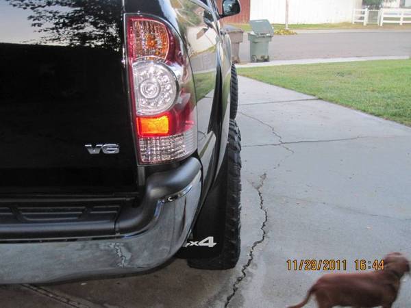

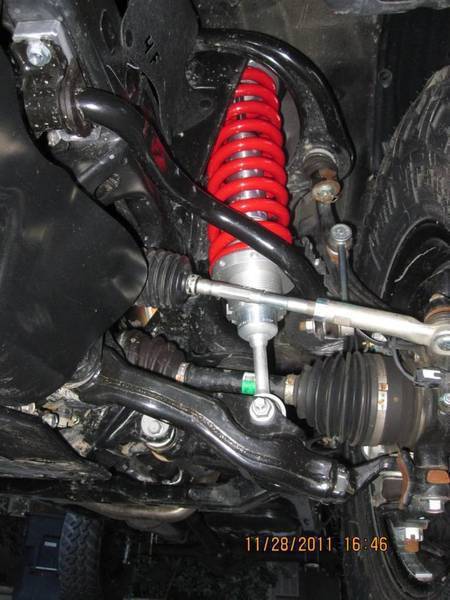

    Pioneer indash navigation unit, Illuminated 4x4 switch, HID heads and fogs. Black leatherette GT seat covers. toytec Ultimate lift. Now its time to mod exterior.
    Running the 285/70/16 with only very minor rubbing on reverse with wheel fully turned. Wanted to show the distance from fenders for those wanting to know how it looks on a 2.5 inch lift with 4.5 backspacing 16x8 rims.
