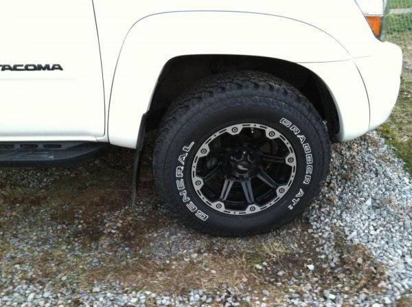

    Wheels: 17x8 Pro Comp 7005's with 4.5" back spacing
    Tires: 265/70/17 Nitto Trail Grapplers
    This setup on my 2013 TRD Sport sits flush with the fenders. I had to remove the front mud flaps because it was rubbing with very little turn. No problems rubbing without mud flaps so far but I been taking it easy on bumps when the wheel is turned.

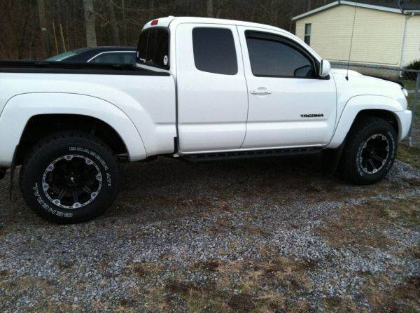

    How are so many people not having rubbing issues with the 265/70/17?
    Here mine are. I am having some rubbage when turning sharp also when flexing in turns.

    265/70/17 or 265/75/16 on OEM wheels are 99% fine and do not rub. Absolute worst case with some beefy AT tires, a few had to loose front mud flaps.
    Stock OEM wheels on a 2nd gen have 5.5bs and 30mm offset. You have aftermarket wheels, so if you have let say 4.5bs instead of 5.5 your wheels will stick out of the wheel well more than stock. Therefore, once you turn your wheel it may interfere with fender flares, mud flaps etc. in spots where it normally would not.
    I have 16x8, 4.5bs, 0 offset wheels mounted with 265/75/16 AT tires (same overall size as 265/70/17) and had to loose mudflaps and bend the end piece of the fender flare that is normally covered by the front mud flap inward.
    Now it does not rub even at full lock and reverse. Not tested while offroading yet.
