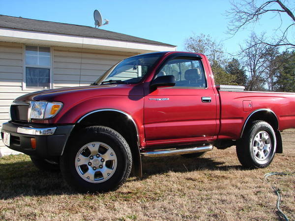

    Here you go! They fit on my 00 with no problems at all.

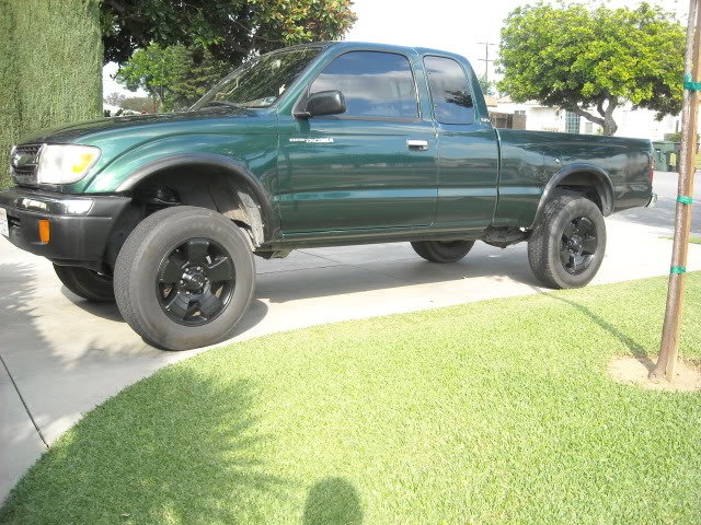

    Here is mine. Wheels look fine. Sure, doesn't look like the other 1st gen but I like them better.
