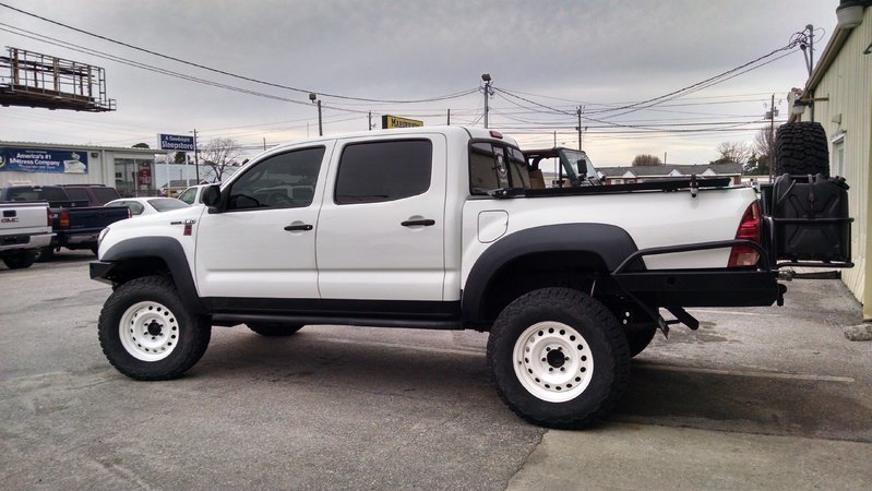

    I just acquired a set of 5 35's that i couldn't turn down. Ive been thru the 35 thread. But could people post up pics of there cut fenders and beds? and what you used.

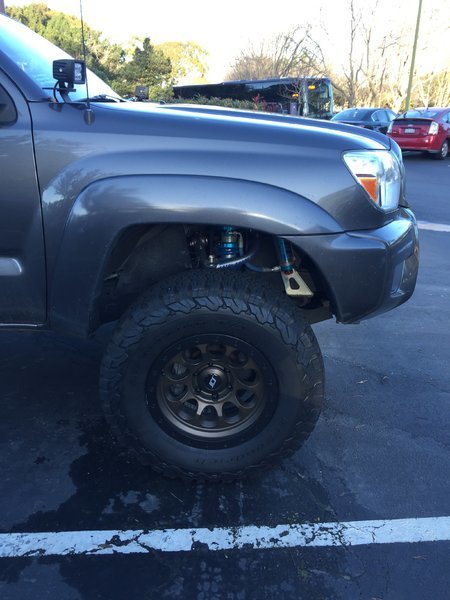

    -You'll need to cut the cab mount back as far as you can. And hammer the fire wall with a sledge. Up to about where my hand shows. The top of the wheel will rub so you can hammer at the top as well or use a 3/8 spacer on your bump stops. In the picture you'll see white marks where I'm rubbing.
    -For the fenders I used a jigsaw. Tape the area with blue tape so you can mark it. I removed 2.5". Some guys only remove 2" but I wanted to be sure I'd have no issues. You can use a compass or the old tape measure trick.(reference picture below) hold you index finger at 2.5" and a pencil at the end of the tape and run along the fender with the index finger. I found this to be way easier than a compass.
    -For the plastic fenders I used a Dremel. Some guys also use the jigsaw. I felt it came out way cleaner with Dremel. It kind of melts the plastic but I had way more control with it. You want to cut 2.5" to the plastic fender flare as well.
    - The rear doesn't really need to be cut as much but your truck would look wierd with a big fender in the back so do them all 2.5" front and rear.
    - rear fender bracket towards the cabin gets removed. The one towards the rear can get relocated past your cut. I was able to use 1 existing hole. The other needs to be drilled.
    -all fender liner needs to be removed
    -you will break plastic clips when removing the plastic flare. Don't stress it. Get more from the dealer.
    -add black door trim from the auto store to cut fenders. I only used on the metal because the cut on the plastic came out so clean
    35s are awesome you won't regret it! Let me know if you need anything else. Happy to help.

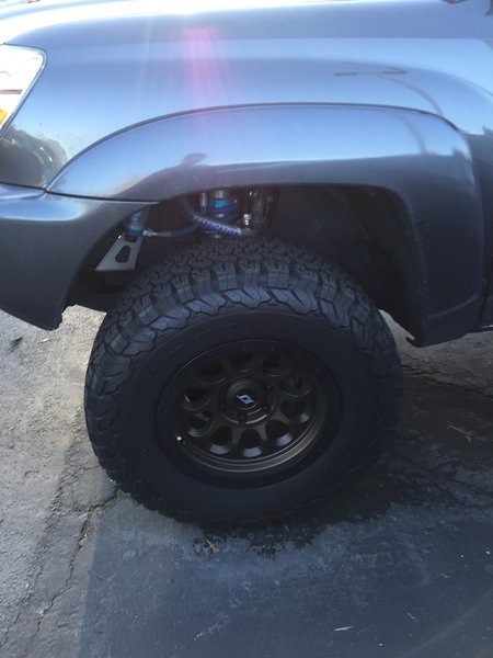

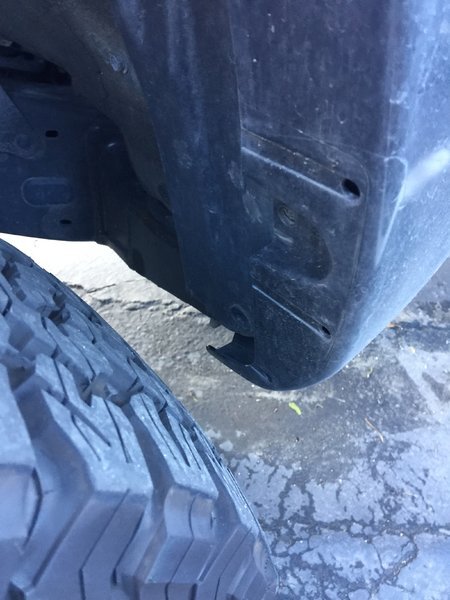

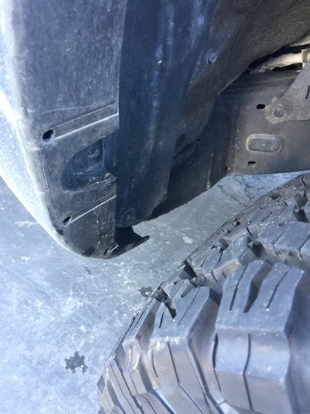

    Just grabbed these of the wheel wells and the rear of the front of each side.
    I was guessing the lower piece that hangs out for sure.
