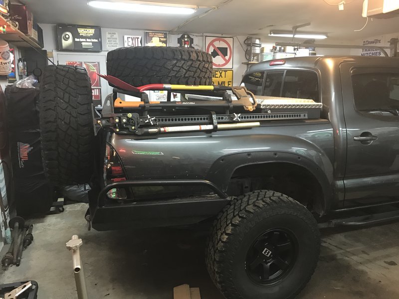

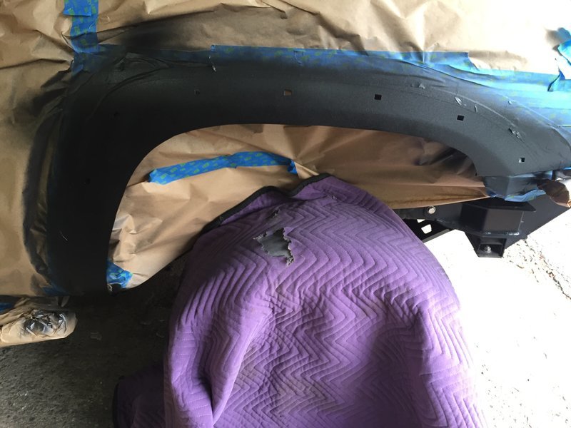

    Take a flat piece of wood. Drill two holes in it big enough to fit a sharpie snugly. Use the bottom sharpie to run along the bottom of the fender opening. The second sharpie draws the cut line. Got the idea from @cynicalrider
    Mine are cut 2". I did not have to cut my rear bumper. I just cut 2" and then tapered down to nothing at the bumper. Cut the fenders with a die grinder. Left the flares off and painted where the flares used to be with spray on bed liner. I used this http://trailtoys.net/products/a-better-edge-trim to edge the fenders. It's pricey, but really nice. No adhesive, just clamps on.

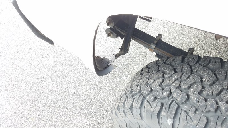

    Question for those of you that cut the fenders and flares. Does mud and other stuff now get stuck in between since the flare no longer wraps around the fender edge? And maybe clips dont last as long as they are now exposed? Ive seen a bunch of pictures but never a shot pointing upwards just trying to wrap my head around doing it on my truck. Cutting the bottom rear most part of front fender (near cab mount) looks to be a pain as well?

    Yep they are gonna collect mud and shit. But truth be told if you’ve ever pulled you flares then you know that it happened even before cutting them...just to a lesser degree.
    You completely loose the bolts on the flares, so make sure ALL of your clips are good. As long as your clips are good to begin with after you cut (I suggest ordering a full set on Amazon for about $20 bucks), they should hold up. My front fender had one broken clip and came off at 80 miles an hour so that one is bolted on now.
    I used a dremmel vs an angle grinder for all my cuts...certainly takes longer but it gave me more control and is more forgiving if loose your grip and it runs away from you. Just take your time and go slow.

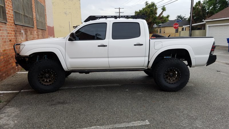

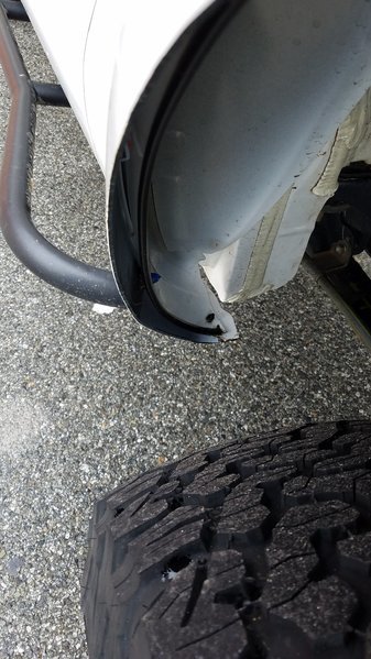

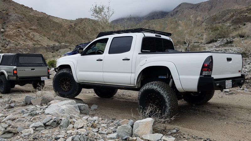

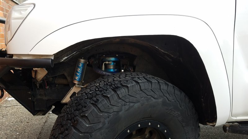

  20. Mar 22, 2020 at 1:16 PM
    #40
    Taco-Obsessed
    Dec 23, 2018
    #276756
    7,448

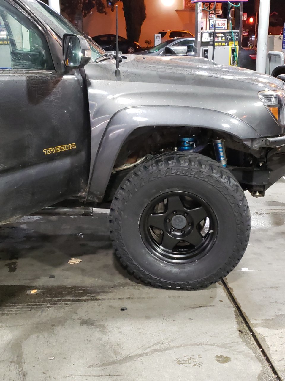

    Cut my fenders finally. Happy how they came out. 20200315_202518.jpg 20200315_202607.jpg
