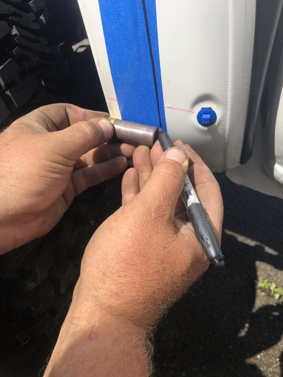

    I used the ruler with holes drilled into it to set a guide and the pen, which worked pretty good. The only other things were meditative breathing before cutting, doing test cuts to get a feel for it below ( in the cut out zone), and having someone to hold the outer flares for you when off your truck and cutting. I used a jigsaw with fine metal blade.

    @Taco-Obsessed ya can't picture what you mean with the ruler holes and pen thing, can you elaborate ? lol

    074739E0-15A6-4476-BD18-8663142243CC.jpgMeh... your over thinking it.

    Basically what @Shadowhunter showed.
    I took a ruler, cut it down, and drilled holes the exact length apart that I wanted to cut. One for the pen to mark my cut offline on my taped area, and the other for something as a guide to hug the edge of the fender the whole way while marking the cut line above.

    I made a little jig with a ruler too. I just ran a drywall screw and drilled a little hole for a sharpie. It was just dumb luck I found a ruler when I was in the shop looking for a chunk of wood to make the jig.

    It worked well for the outer plastic flare. Not so much for the inner metal fender because the bottom where the guide went wasnt even the whole way. Just taped over and drew the line by hand at those locations.

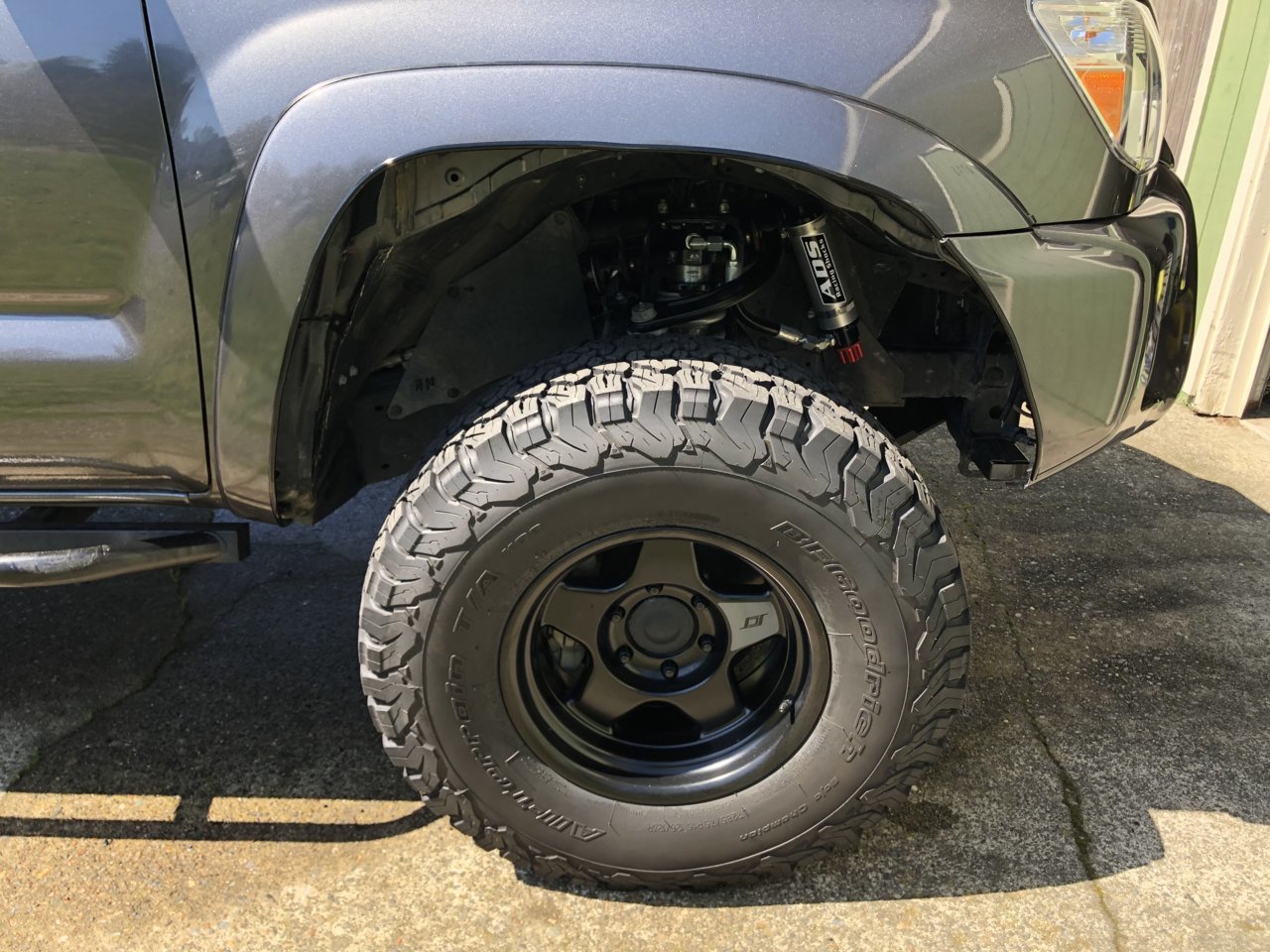

  20. Apr 12, 2020 at 1:49 AM
    #60
    Gruber1922
    Gruber1922 Well-Known Member
    Mar 31, 2019
    #288634
    1,317
    Tacoma, WA
    2015 Tacoma Sport
    Mine came out pretty good. Wish I used a Dremel on the flares but they are out pretty straight. Need to put the new trim on and do the rears this week
