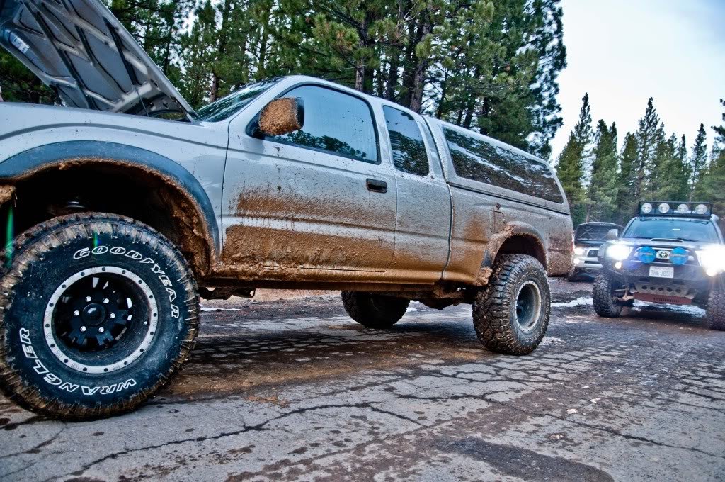

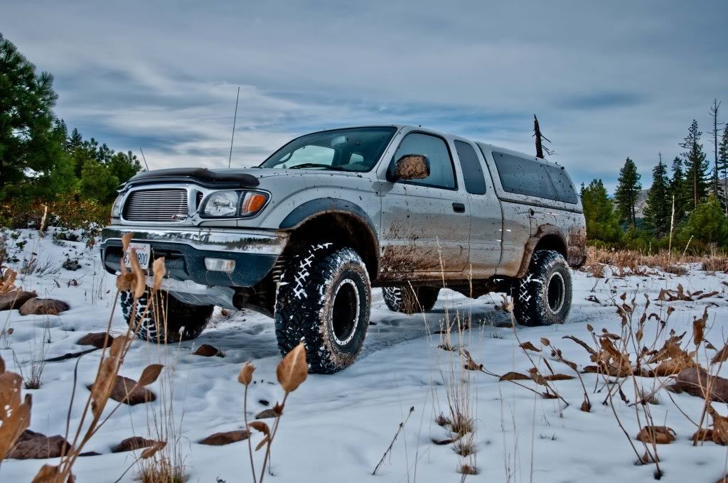

    Oh yeah i forgot the pic of the truck.

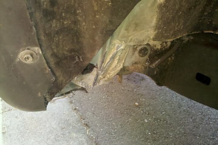

    Well I plan on installing Bushwacker cut outs this summer so I just took the install plans from those and cut away what was needed to install those. And I'm good I don't rub at all. If you want to take your truck off road you going to have to do some cutting or buy new wheels. I say just cut you can't even really notice mine from the side of the truck and I painted it all black so it just looks like the wheel well.
    This is a shot after i cut everything off.

    I started with this that was just to be able to drive the truck.
    Then I cut all this so I could take it off road. you can see here I rubbed the paint off from the first time I cut. I pounded the shit out of it with a hammer and moved it back about 1"

    Jlee i cut mine about the same amount that you did on the first pic. but where the pinch weld it at is where im having my clearance issue at the bottom of the pinch weld did you hit it with a hammer there also. sorry for all the questions man just trying to figure out the best way to do this so i dont cut off to much or bend to much that i dont have to.

    where that rubber grommet looking thing near the pinch is where im having my problems

    Okay so the red arrow I scraped off all the sealant there was about 1/2" of it right there and pounded it back about 1". The Blue one was pounded back and the pinch weld was cut flush. The green line was all metal that I removed and it came out to that green line.

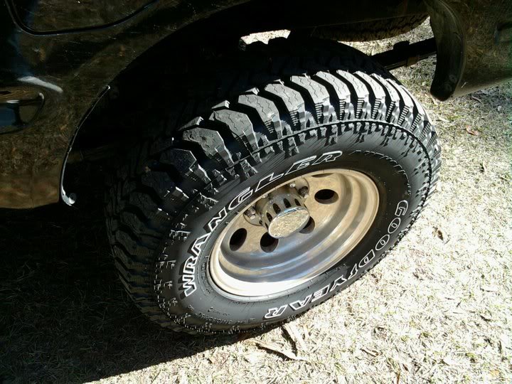

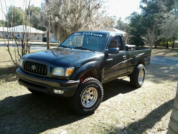

    I wanted the duratracs but they were a little bit more and I would have waited a week and my old tires were getting scary to drive on. So I got Goodyear wrangler Authority, they were a bit cheaper and looks just as good
    164737_1838058036064_1378900607_32148524_575244fb1db9aa8c8d4d394da67c7a350b2d4451.jpg
    168181_1838058396073_1378900607_32148525_eb5326d2c9011967fc356be508321d4f809a0311.jpg

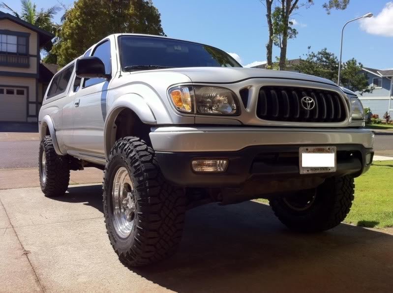

    285/75 16
