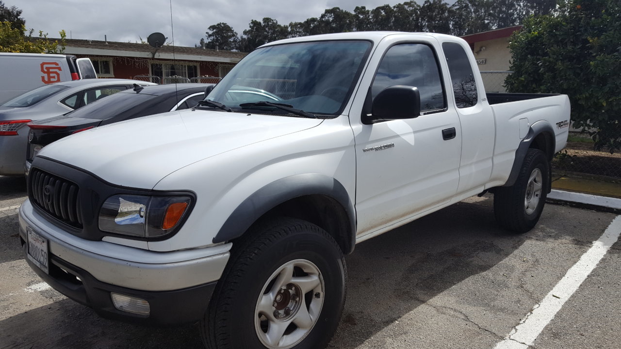

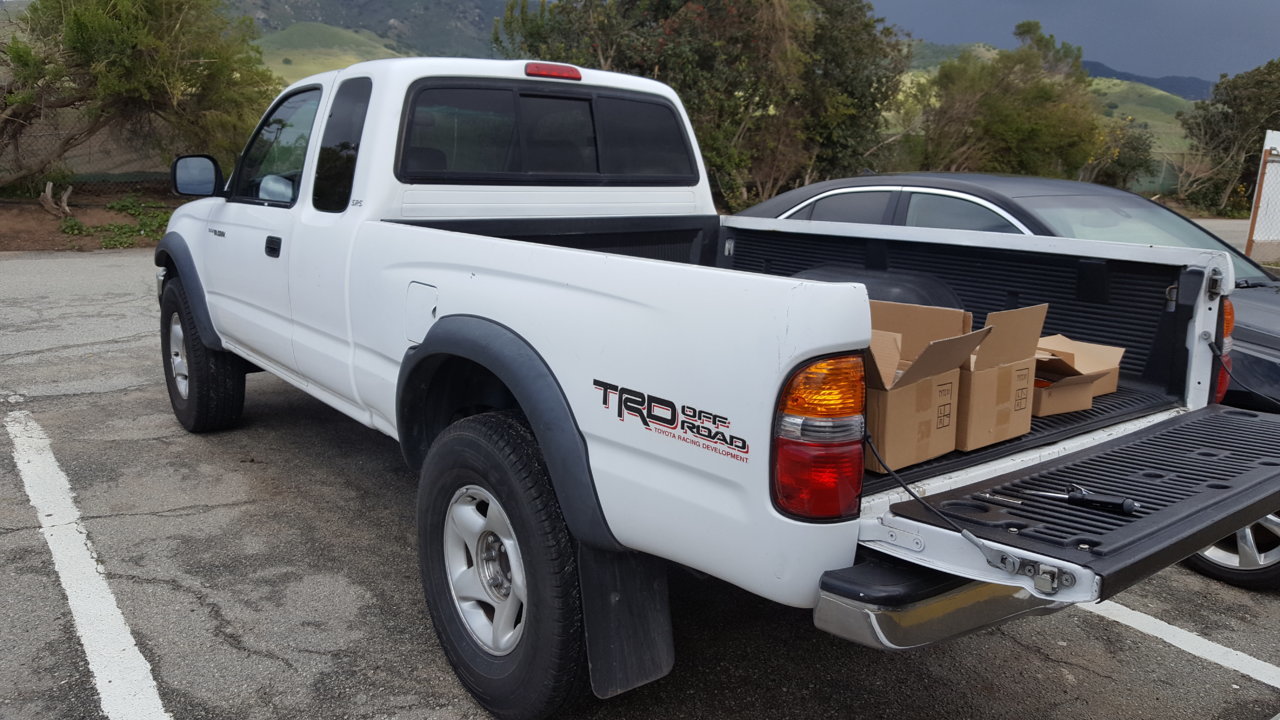

    Here’s my before and after. I’m super happy with the way it turned out!

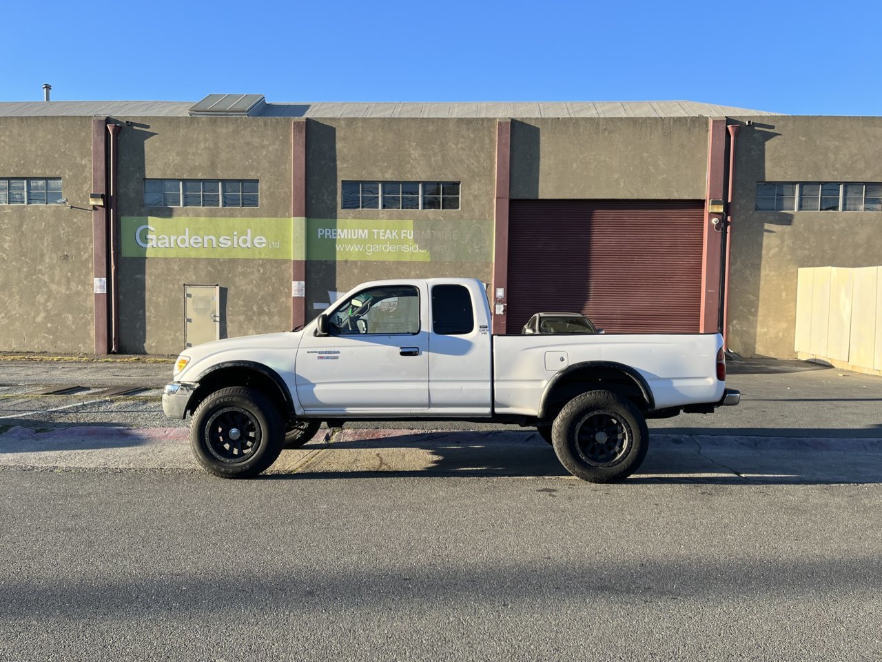

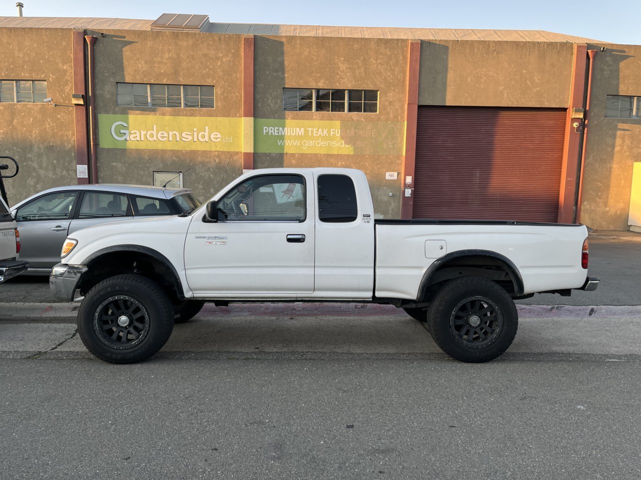

    “Before” with front spacers (they measure 1.5” but give seemingly way more lift than that) and 2” rear blocks by PO:
    After swapping front spacers for 5100s at middle setting to try to remove reverse rake, rear unchanged for now:339ED86D-275B-4E7D-8CC9-361BD532087F.jpg
    Was deciding between the middle and the lowest (“0”) setting for 5100s in front. Any thoughts? seems pretty much level now but would it Better to be lower in front for when I put the shell back on and load the bed? Think 0” may have been better
    either way I’m very happy with the 5100s instead of the spacers

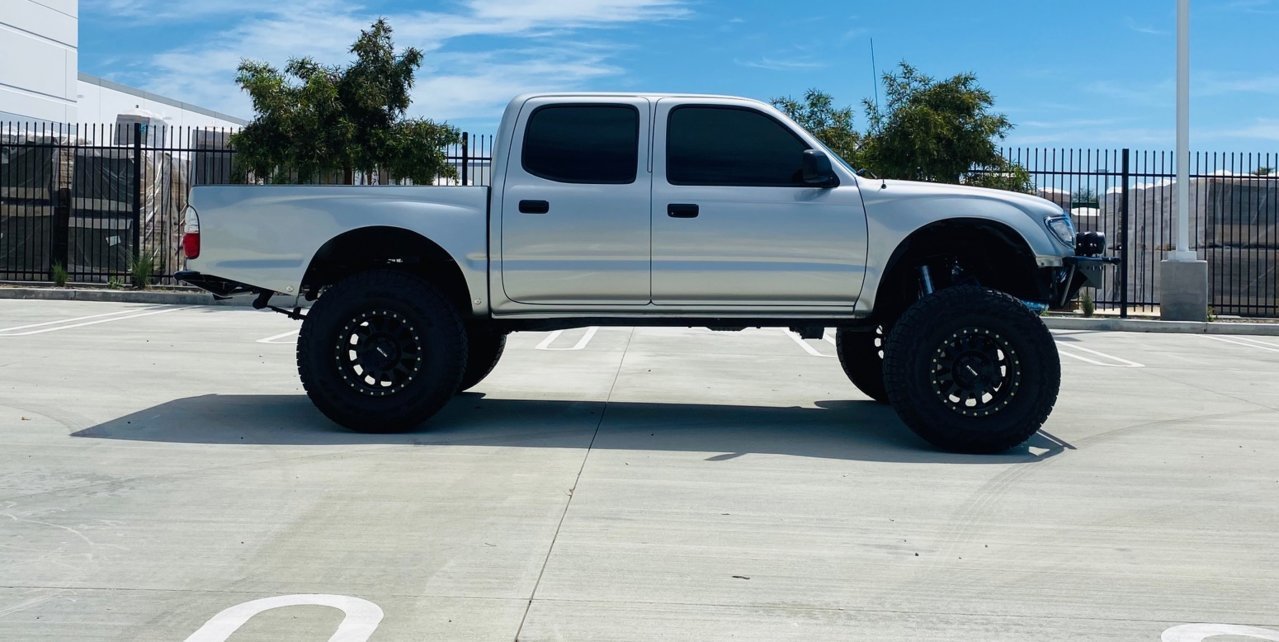

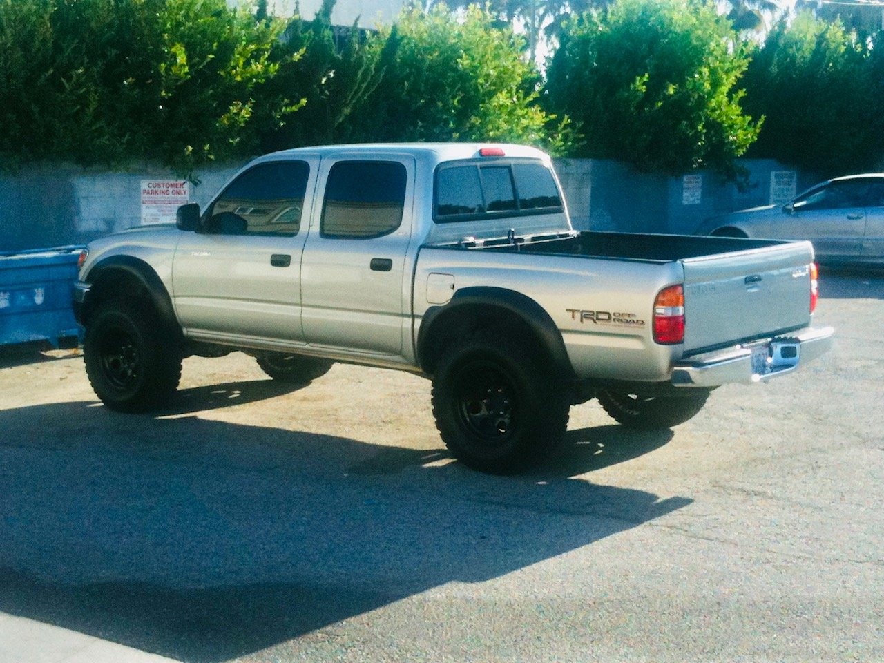

    I bought the truck stock in October 2008 for 15k with 46k on the odometer. I started with a 3" spacer lift, gloss black ProComp 69 series wheels and 31's in 2009ish. After a couple of years of spacers, I bought used Fabtech coilovers on Craigslist for $200. In 2017ish, I bought FOX coilovers with DSC and Total Chaos UCA. In 2019, I started to do some serious work, caged and LT. Still saving money for a supercharger and to back-half the rear with 4 link suspension.

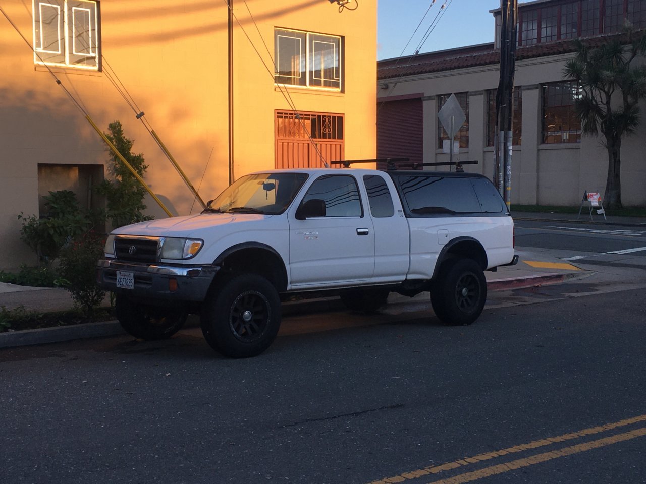

    Before and after about a 1.5” lift (6112s on 5/6). Nothing in the back

    If the spacers measure 1 1/2”, then it’s a 3” lift. I don’t quite understand how it’s works, but you double the height of the spacer for the actual amount of lift. Truck looks good with the 5100s on it now!
