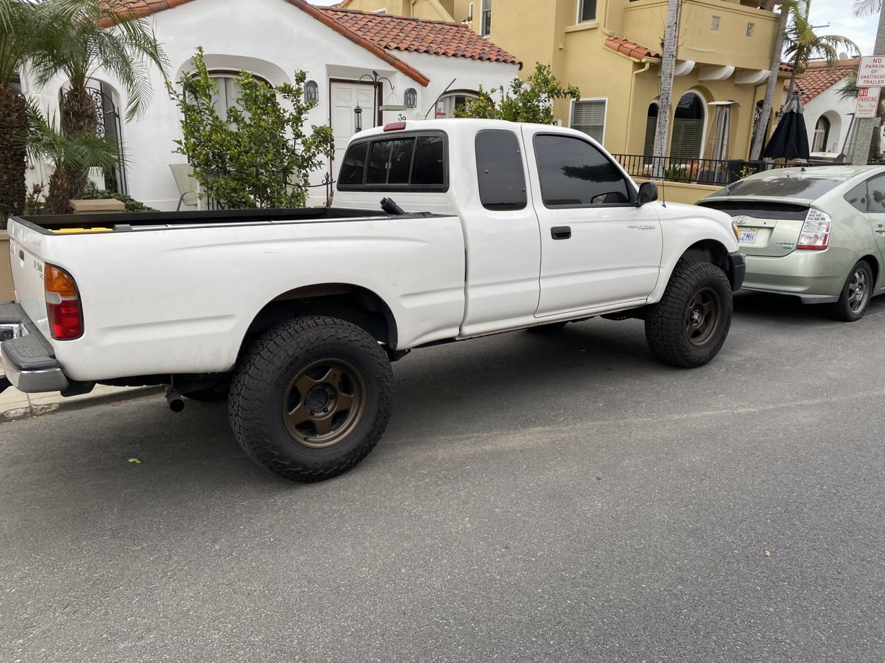

    :thumbsup:I know 2nd street when I see it. Gotta love LB.

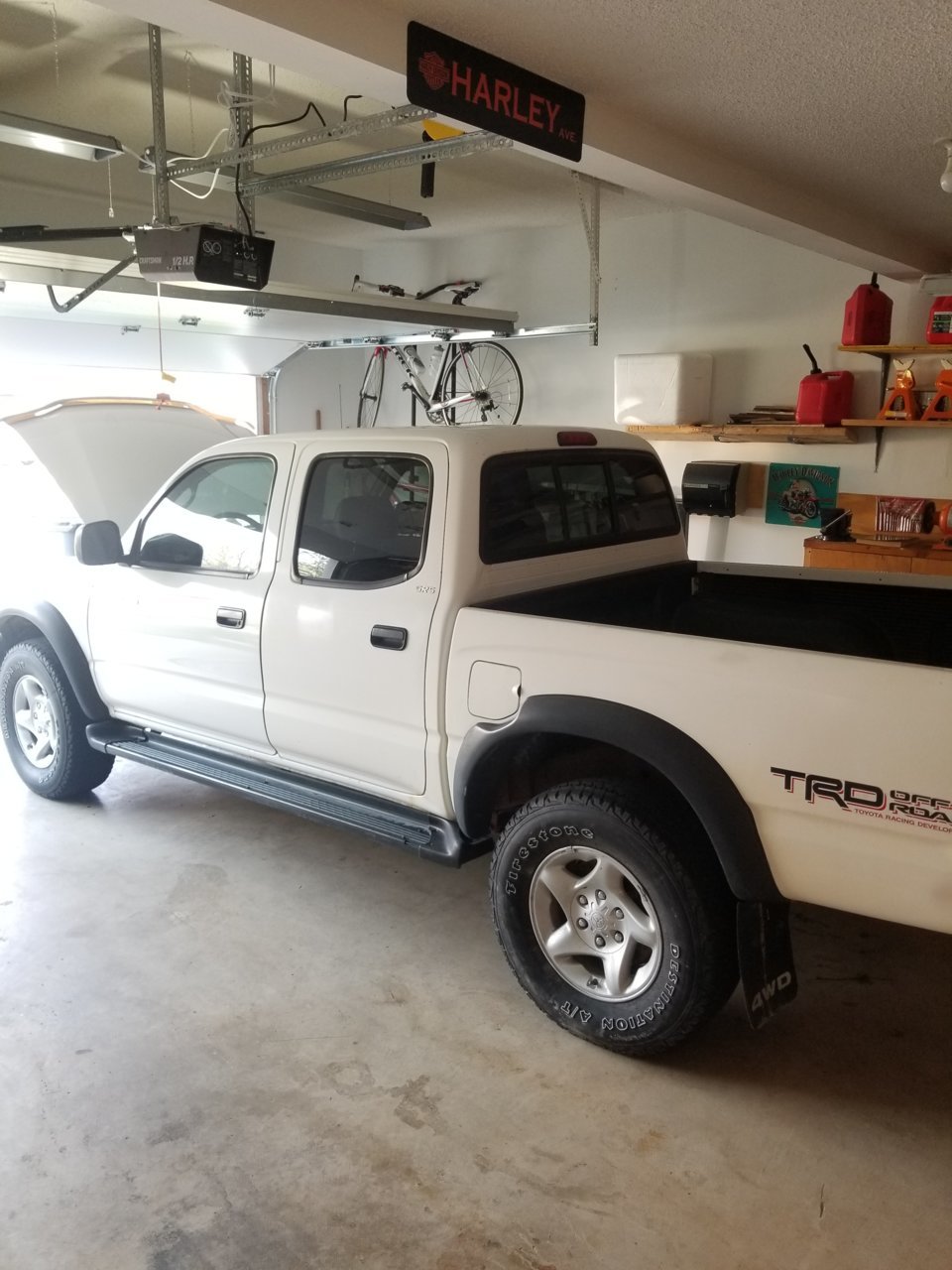

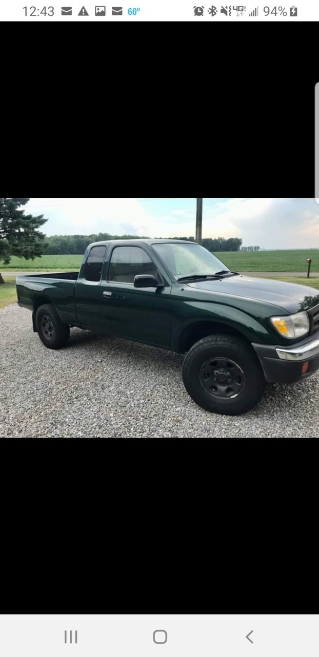

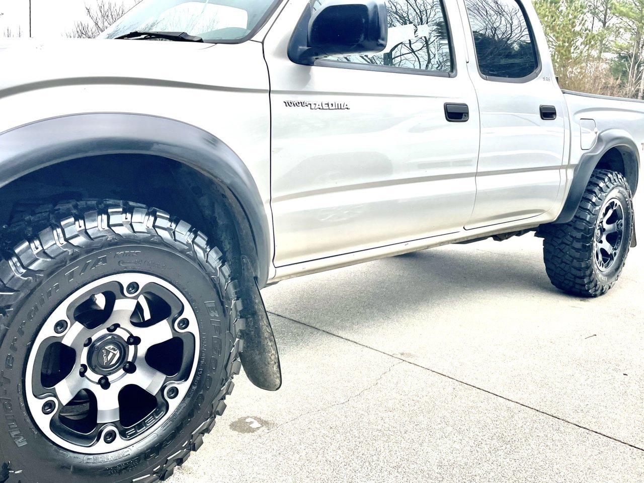

    It’s a four banger anyone know how far I can go with tire size ? Just installed this 2.5 lift or should I stay with 265 70 r16’s

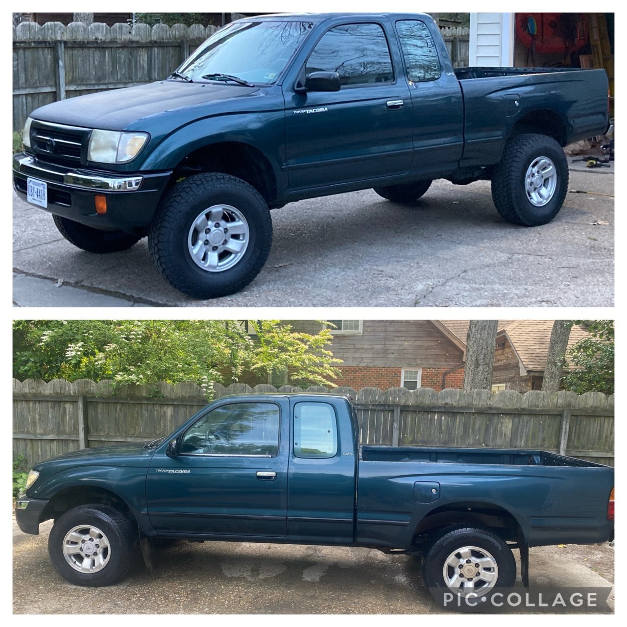

    I went with the Rancho Quicklift. I don’t need anything crazy because it’s on the street most of the time, except for the trips on the beach in the summer. It rides great now. I was worried that it would ride rough.

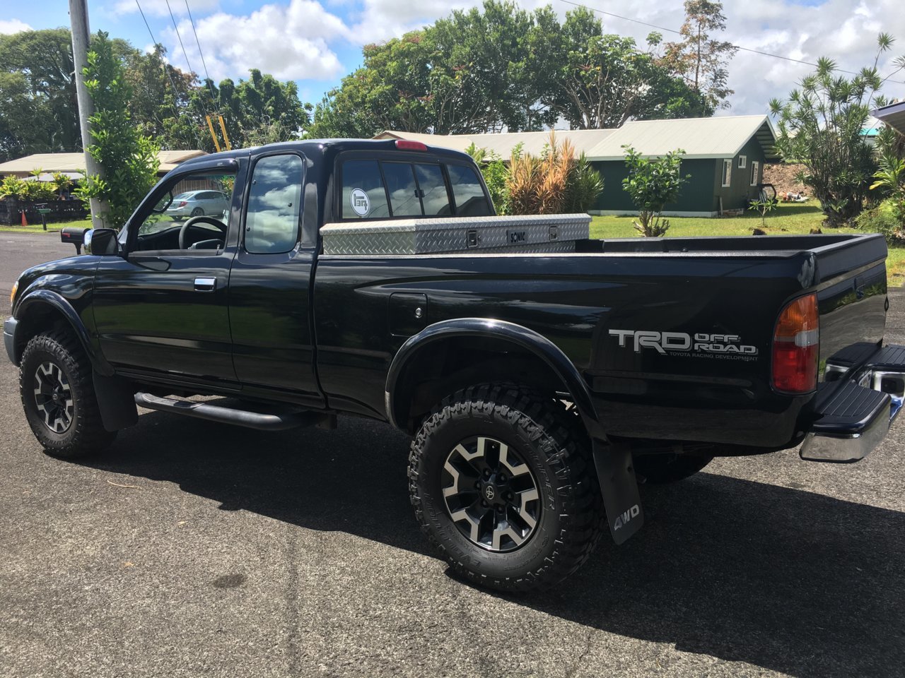

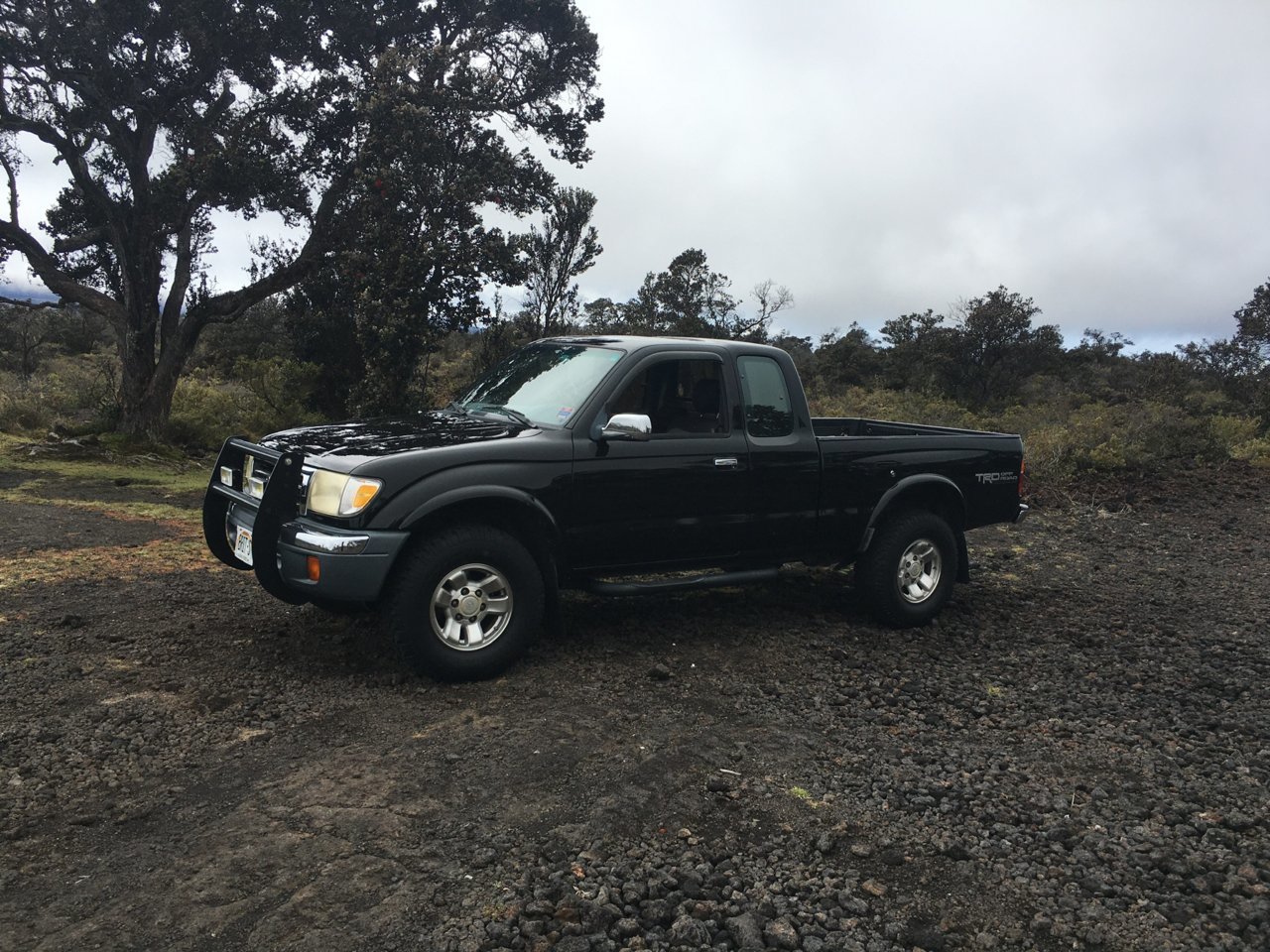

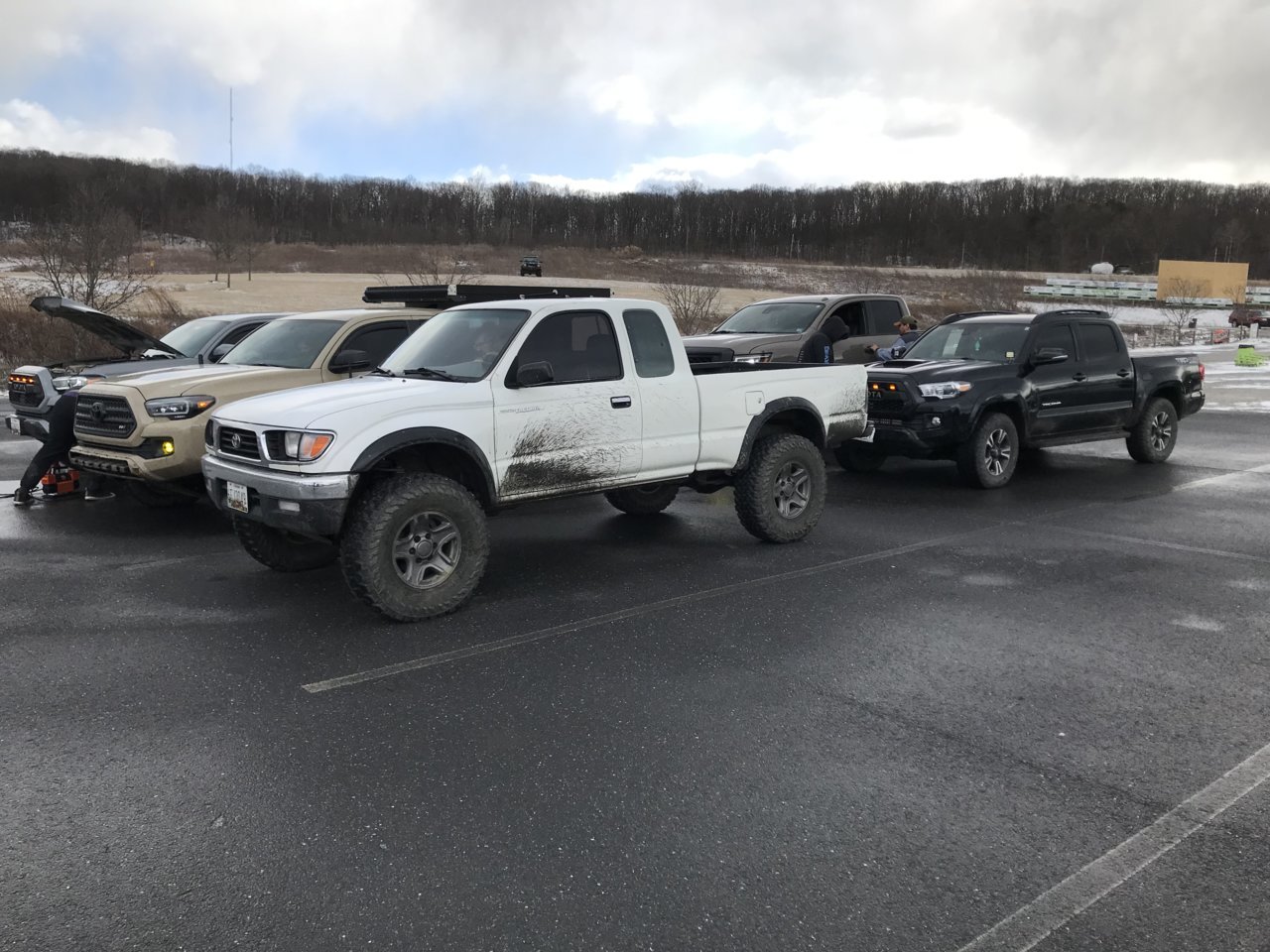

    35F96AEF-D2D6-4545-AAAA-58DBE2A03B2F.jpg 5EE1FF5B-746C-4B4B-95A8-6F046A136851.jpg
    ‘98 v6 4wd limited
    3” lift in front 5100’s, OME881, 2” AAL in rear
    265/75/16 Cooper m/t’s

    Clean truck. Big Island?

    What size/model tire are you running?

    Looks great! I just got my F5s, what size are those Falkens? 265/75? Thanks

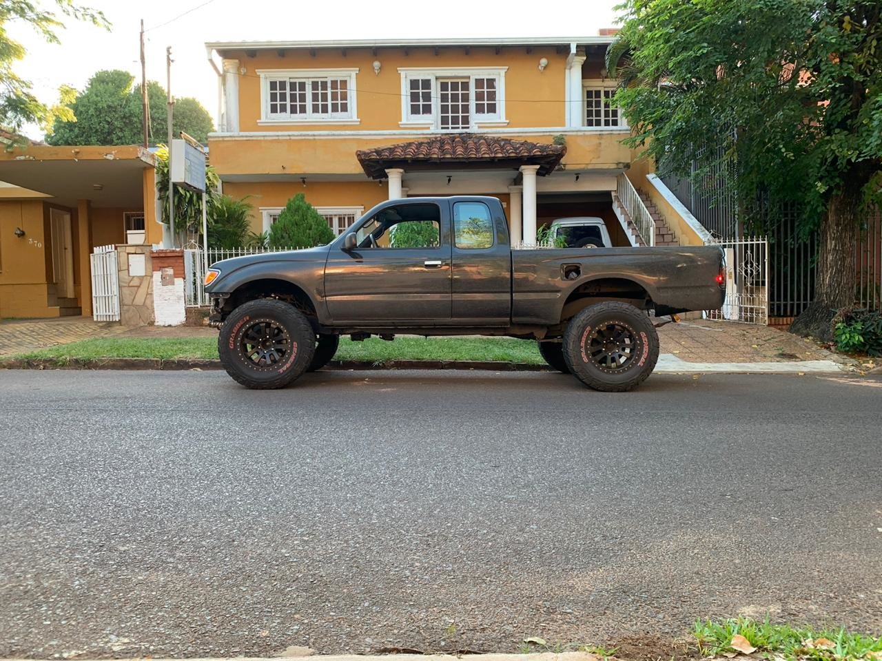

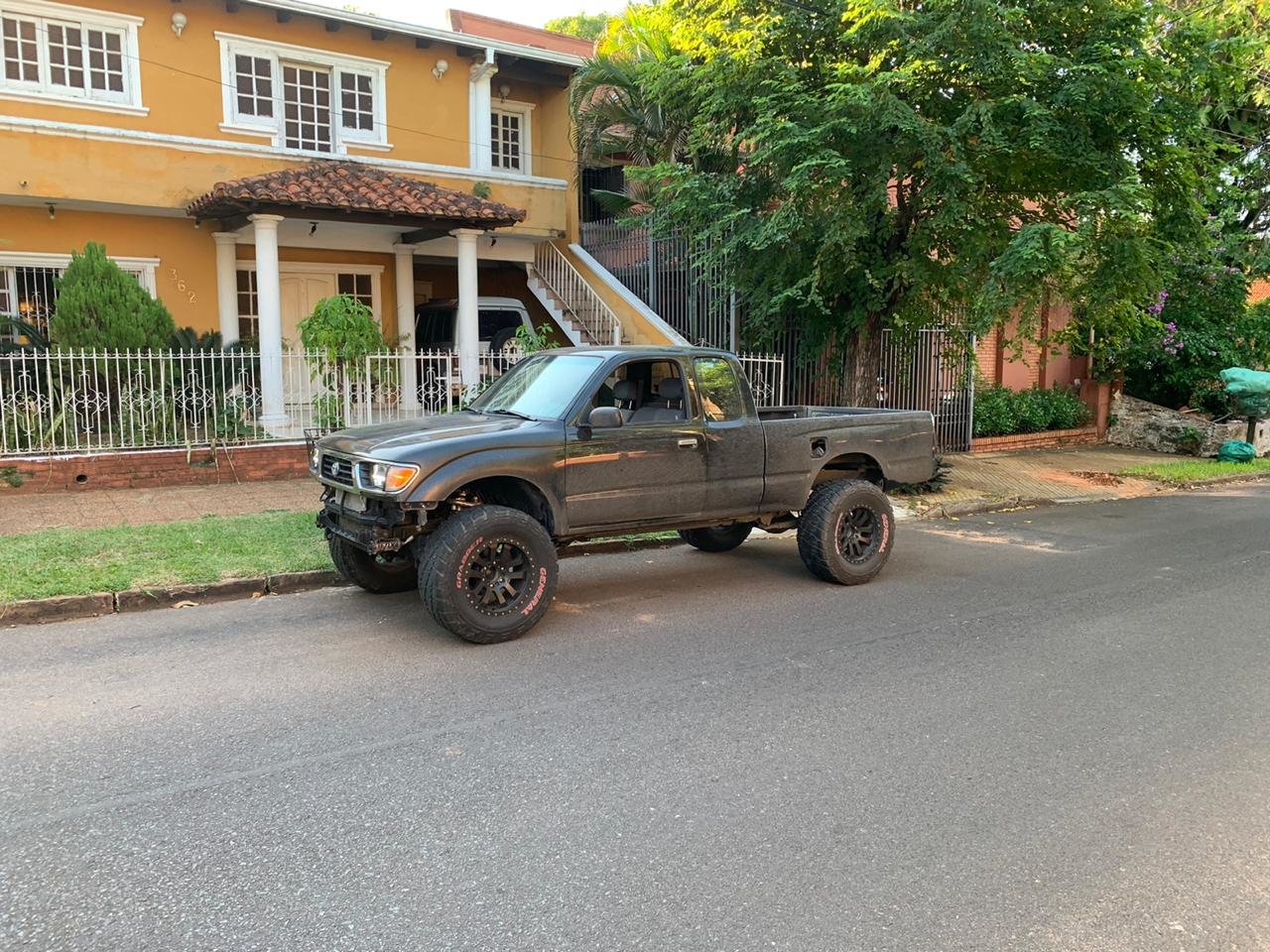

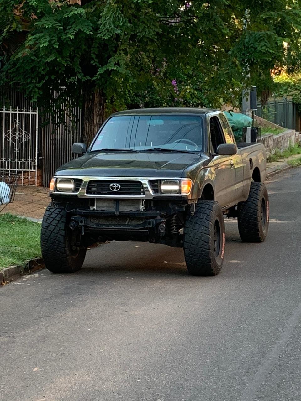

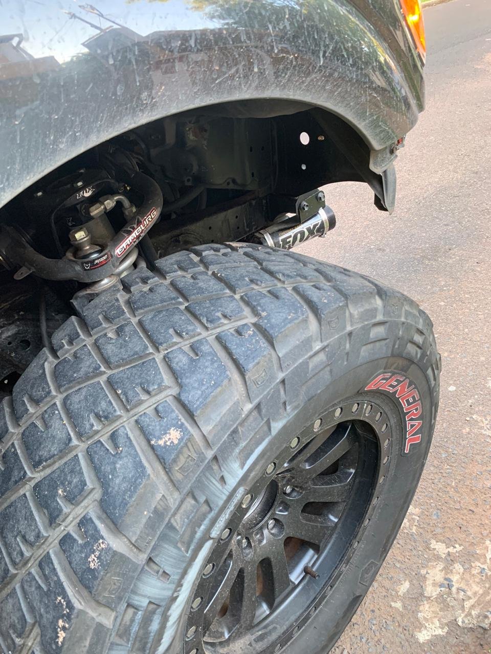

    Entire chassis fabrication 2.5 FOX Mid travel suspension kit with reservoirs Camburg UCAs Procomp 17” wheels / 6mm negative offset 33x12.5 general grabbers LED rear and brake lights DLR front headlights
    F977B0EE-6D0E-4563-8BD5-BA43A60A5115.jpg 0ECBA3DC-57B1-484C-9205-3E73A6B06A05.jpg F977B0EE-6D0E-4563-8BD5-BA43A60A5115.jpg 0ECBA3DC-57B1-484C-9205-3E73A6B06A05.jpg 8B5A6152-22B6-4519-B1B1-7137446A2936.jpg
    2.5 adjustable mid travel FOX shocks w/ reservoirs front
    2.0 FOX rear
    Camburg UCAs
    17” procomp wrapped in 33x12,5 general grabbers

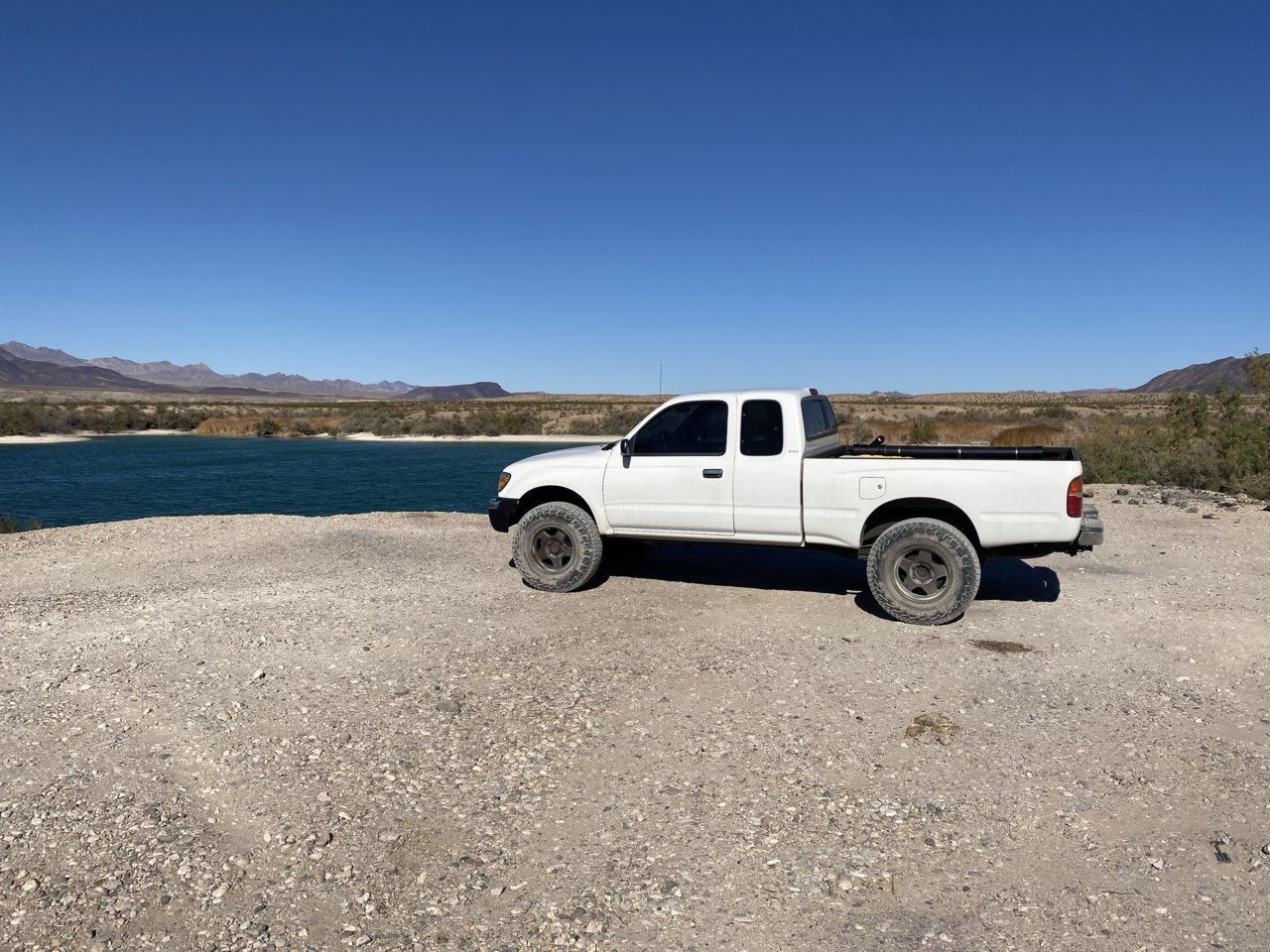

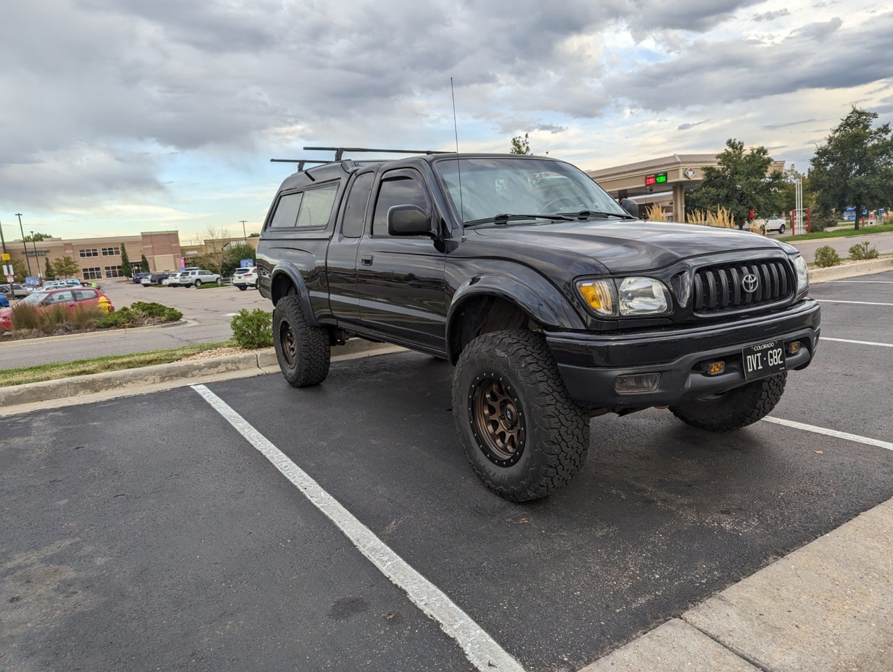

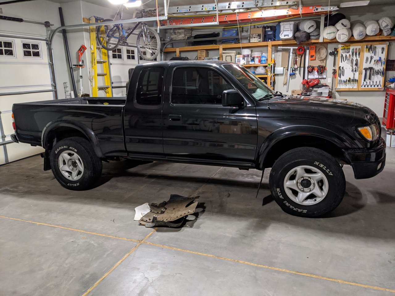

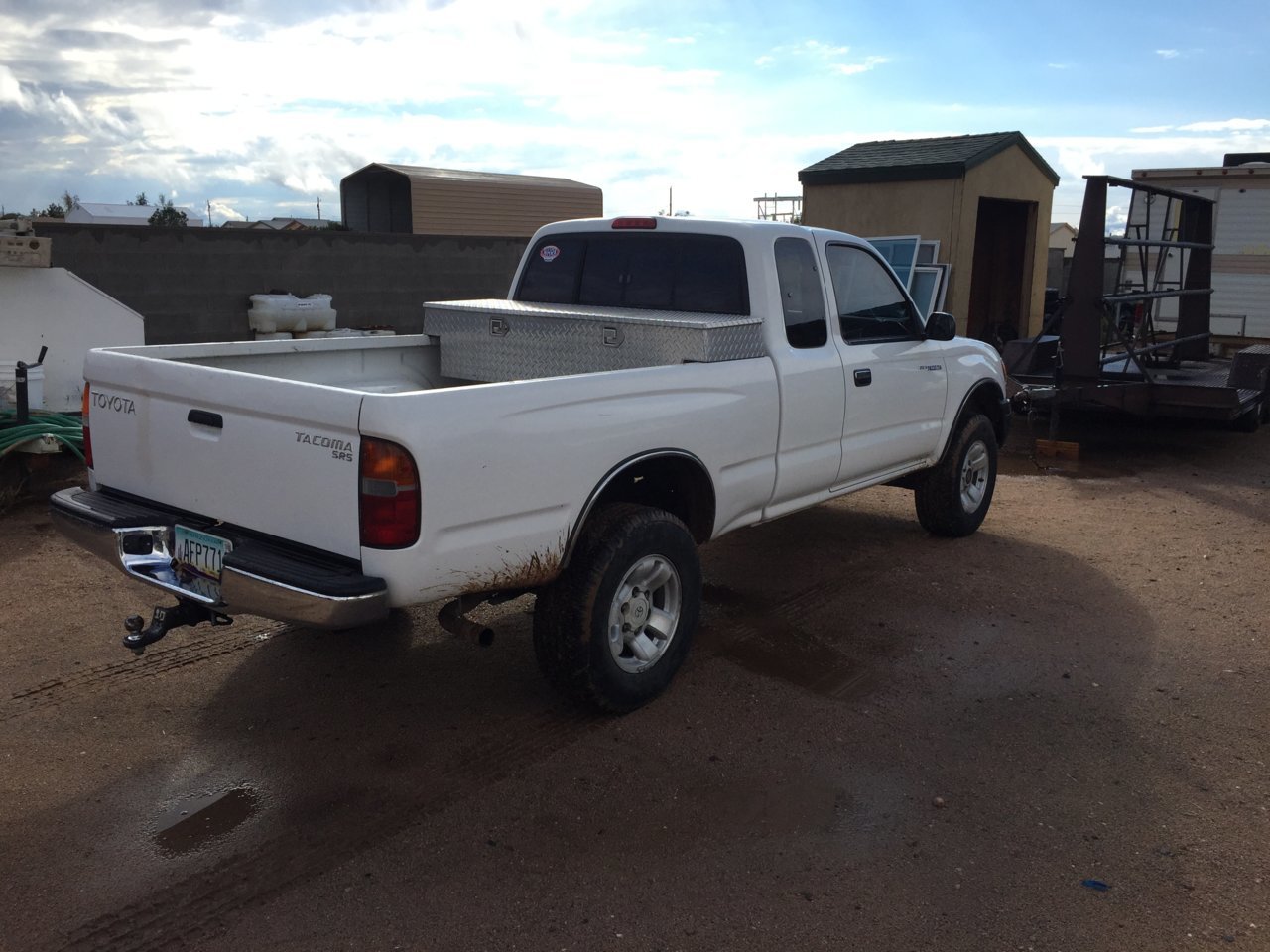

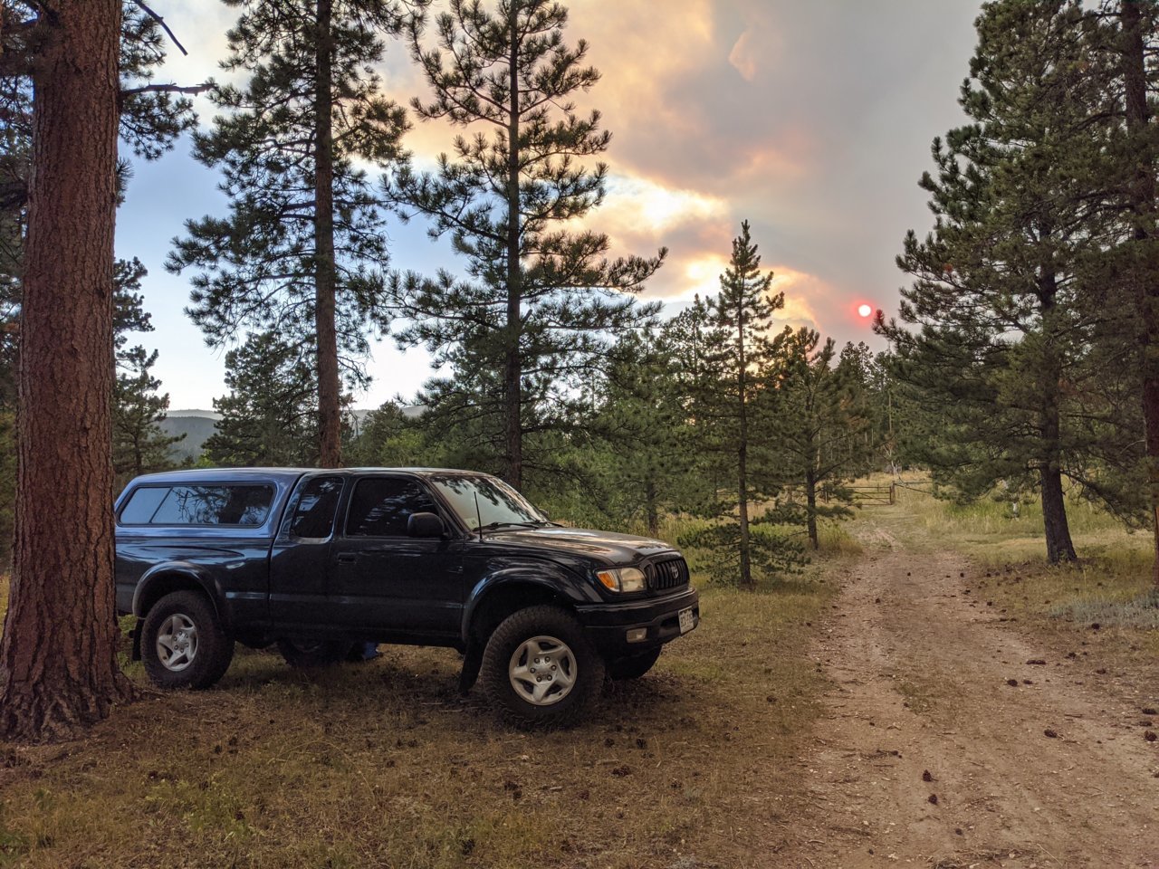

    The day I bought it vs. now...
    Before:
    Original TRD suspension
    worn down 265/70R16 tires.
    -.5" lift from 16 years of abuse
    After:
    OME Dakars standard load leafs
    Bilstein 5100s all around with OME 880s installed
    265/75R16 Falken Wildpeaks
    ~1" lift.
    After 1.5 years the 5100s developed a nasty clunk and I tossed em in the parts bin.
    After After (now):
    OME Dakars extra load leafs (constantly loaded with camping junk)
    Toytec Alumas front and rear, JBA upper control arms
    285/75R17 KO2s wrapped around SCS Ray10s 17x9
    Current lift height ~2.25"
    Best part is I get 1 mpg more with this setup for whatever reason! :D
