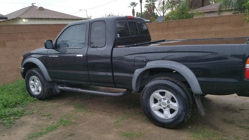

    I've got tundra wheels on mine. Check out my pics.

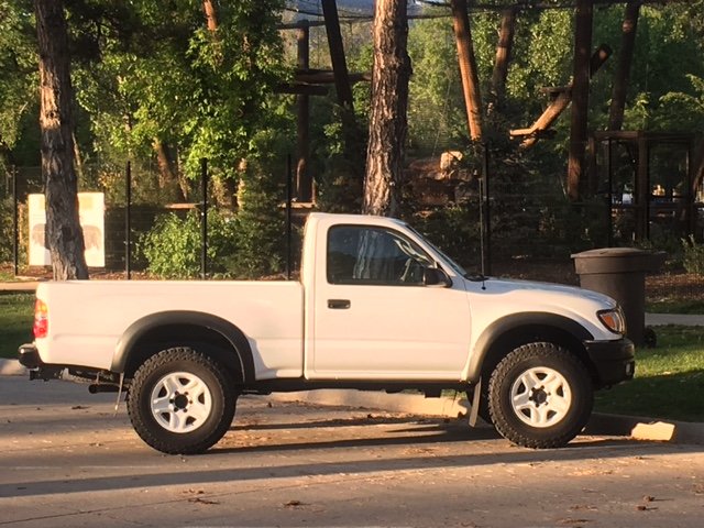

    I used to have a set. They look great on 1st gens. They were fine with 265/70r16's but I got frame rub when I switched to 235/85r16's. I solved the issue by switching to 3rd gen 4Runner wheels which have less backspacing.

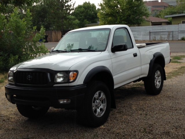

    i just switched to a tundra 16" rim after having a 2nd gen taco rims for a few years. frame rubbing really gets old after a while.
    the offset is just 1/2 difference but the rubbing can get real bad.

    Thanks guys! All of your replies have been very helpful. Im not sure how to tag people in my posts, but DJB1 , After seeing your truck with the 3rd gen 4Runner 5-spoke wheels, I'm sold. Now I've just got to find some!

    I cleaned my 4Runner wheels with brake clean and a wire wheel. It got the rubber residue off the inside lip of the wheels fast and easy. I didn't care if it ruined the original finish because I intended to paint them anyway. I used Rustoleum self-etching primer and gloss white paint. It was a great match with Toyota Super White.

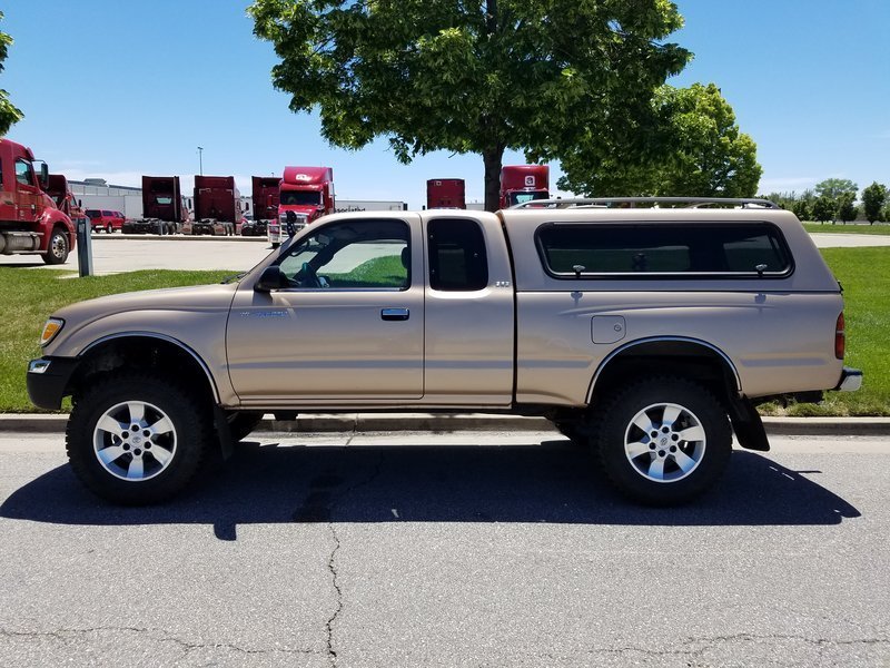

    5100's, ome dakar leafs and ome coils, problem solver tie rods, eazycompany ditch light brackets and auxbeam osram 4" led pods, 2014 4runner wheels, 265/70/17 goodyear authority tires, soon to have 50" led bar on roof
    maybe this will help also its from a 2014 4runner on a 2000 prerunner with 265/70/17
