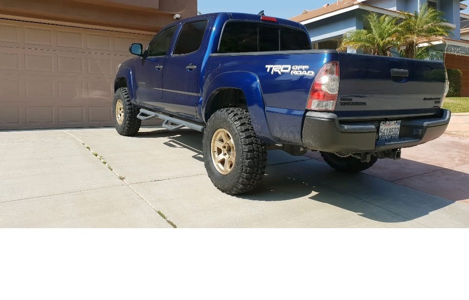

    Naomi, Lana
    295/70/17
    Nitto ridge grapplers
    Venomrex -12 offset
    17x9

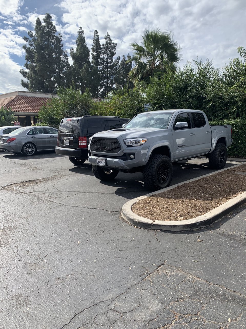

    16x8 wheel with -12 offset
    285/75 BFG's

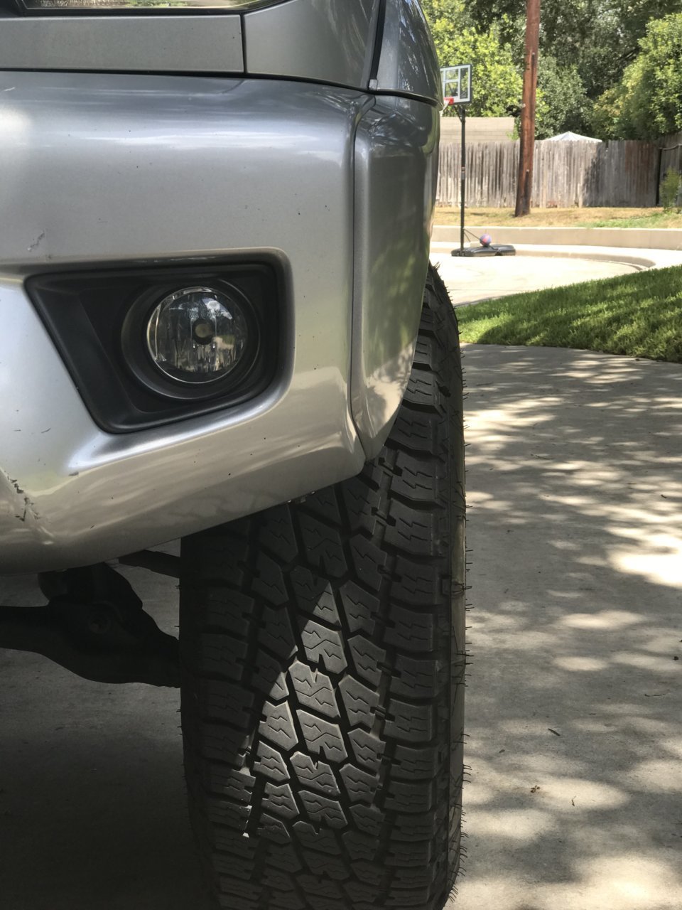

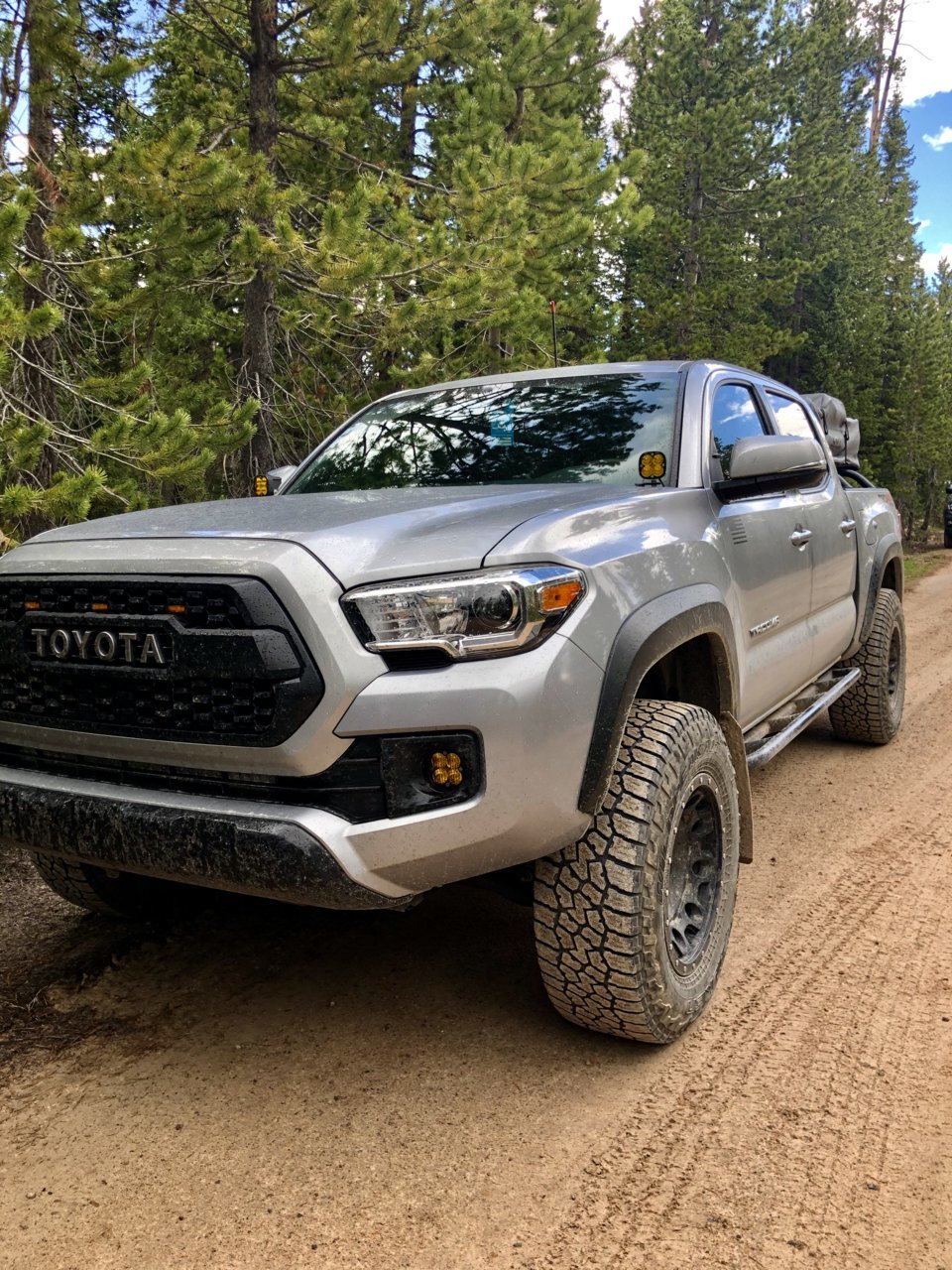

    Did you have to do a lot of cutting to fit those? I have 17x9 with -12 wheels and I have just ordered some 285/70/17 tires.
    Heres my -12 pic.

    Lifted around 1.5" in the front, 1" in the back. 265/70/17 tires.

    So those are the 265’s in the picture? Do you have any clearance issues right now?

    Yes, 265/70/17 in that picture. I had issues with the stock mudflaps but I got different ones and its fine now. I do occasionally rub the front fender if I'm turning and go down a large dip - like once a year this happens.

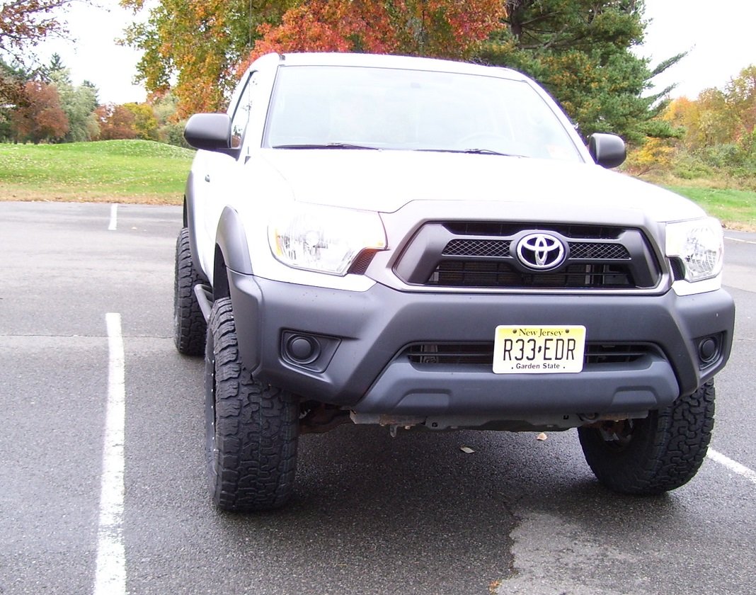

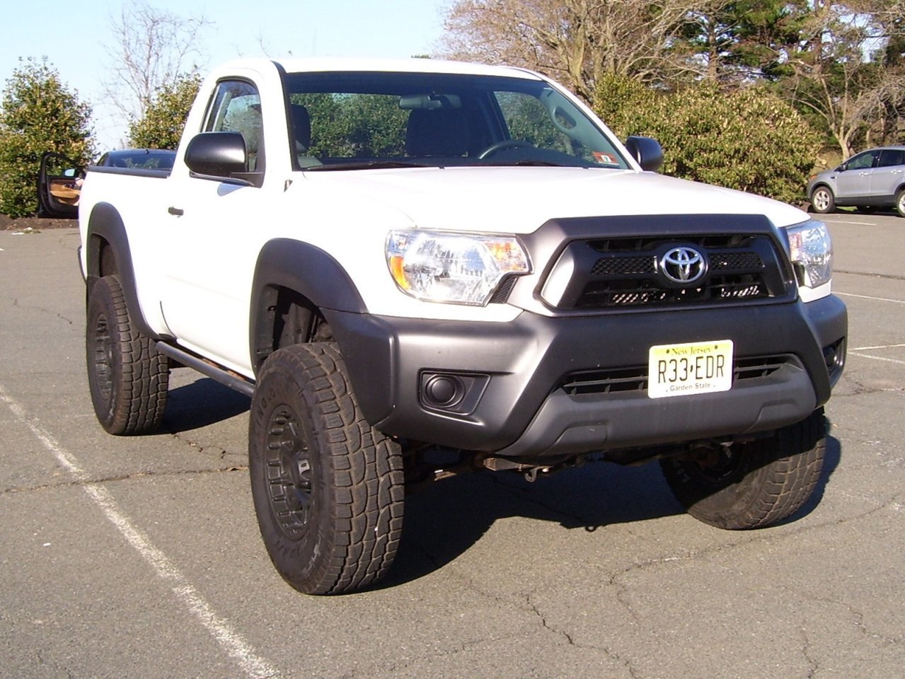

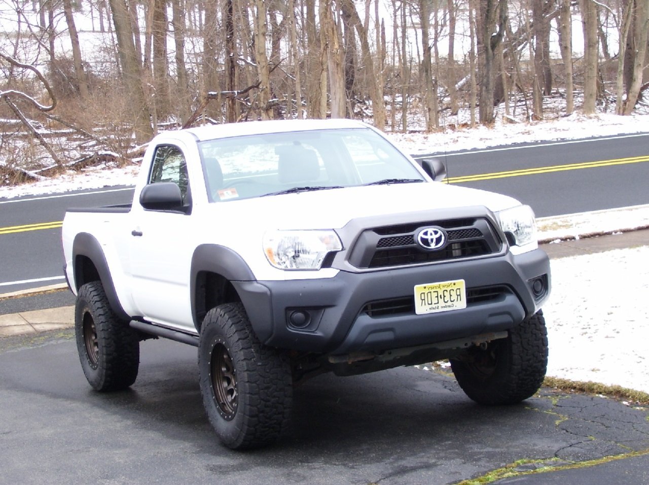

    Here's my truck (3" lift) with 285/75/16 on 16x8 with 0 offset vs 305/65/17 on 17x8.5 with -10. It might be tough to tell but they stick out maybe 3/4" further and slightly rub the mount at full lock. The 16x8 did not rub at all, but I have the SPC UCA's which can push the wheel forward more than stock and the flare has been trimmed and the pinch weld beaten down.
