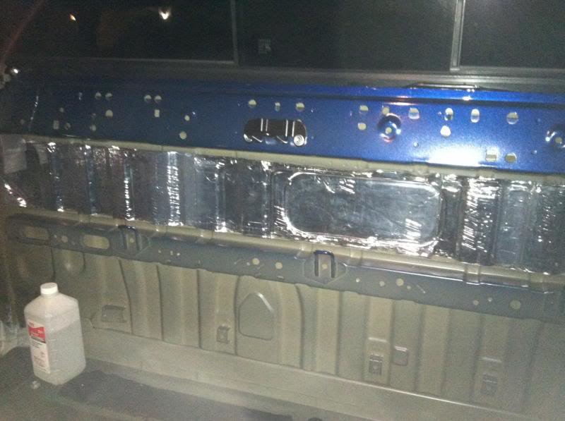

    I took out everything out of the back seat and started the Stinger Roadkill install:
    Not the best picture, it was dark... I used Isopropyl Alcohol to prep the surface. This is my first time installing any type of sound deadening so I am learning as I go.
