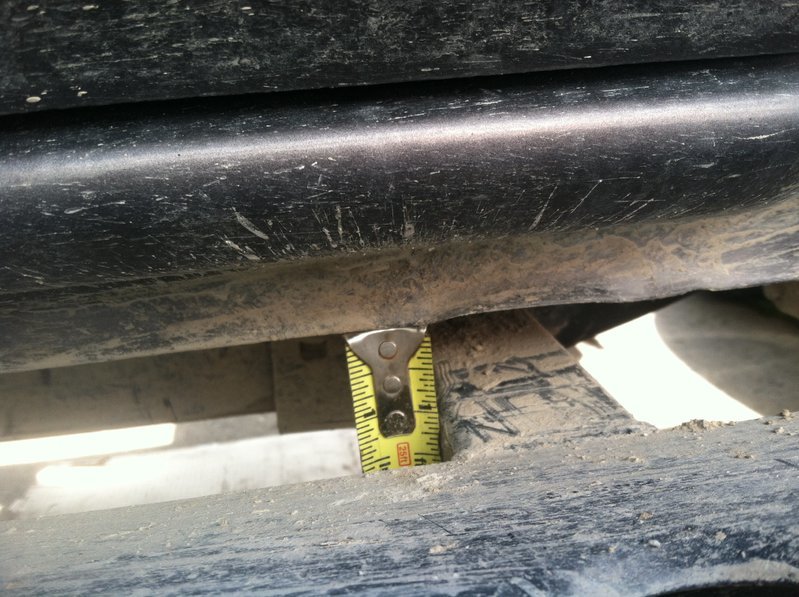

    After putting a dent in my rocker panel that was almost big enough to interfere with operation of the passenger door, I decided it was time for sliders. Pelfreybilt bolt on with kickout and fill plates
    The pinch weld on the bottom of the cab was hitting the sliders.
    I decided to replace the body mount bushings. That solved it!
