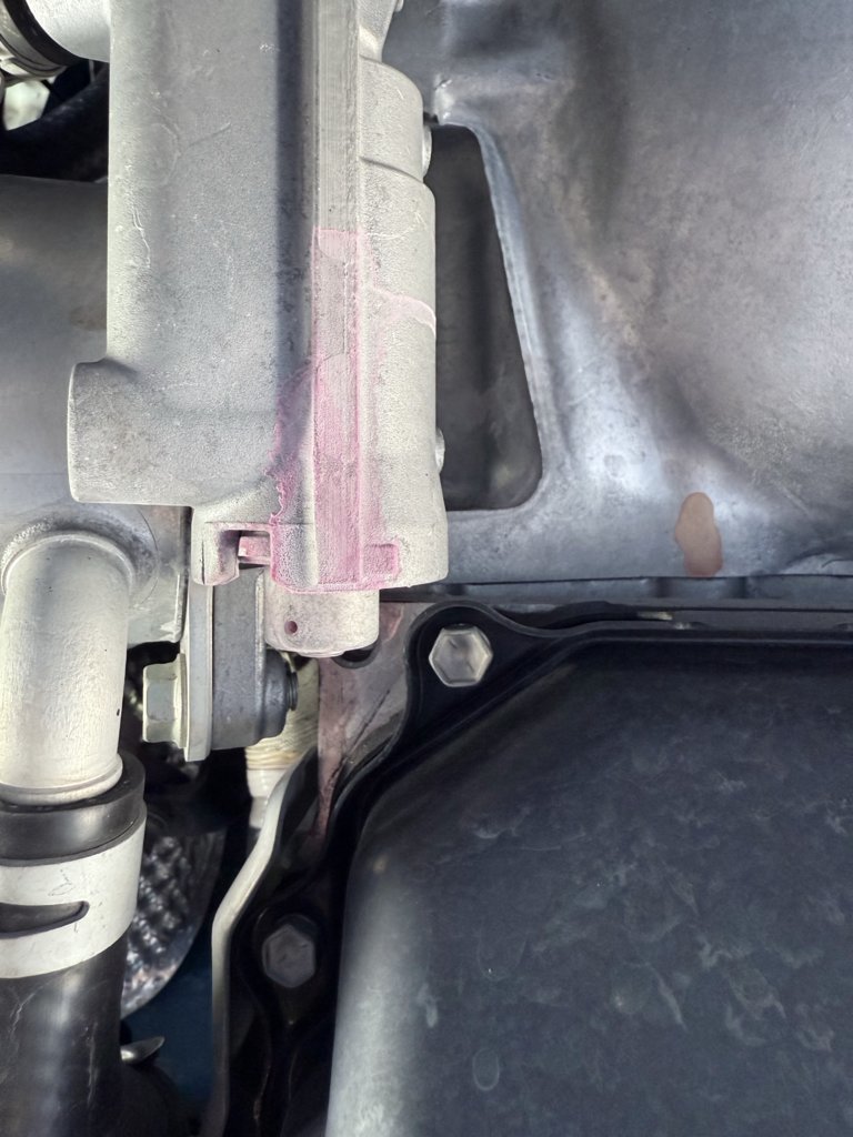

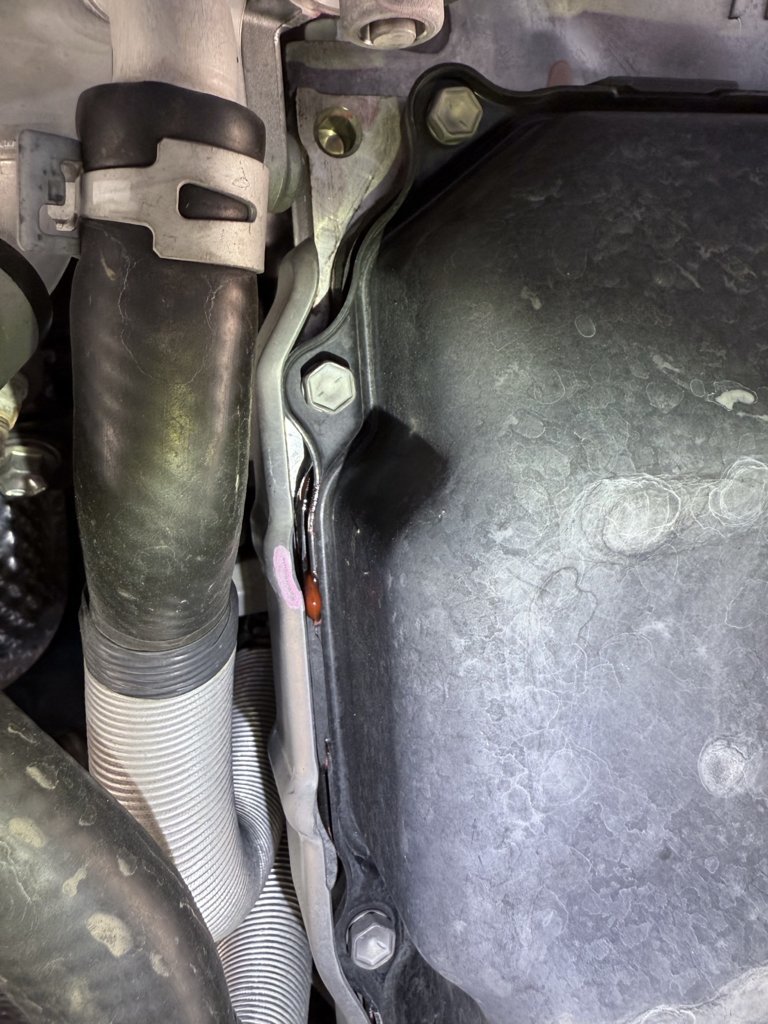

    Hey I just noticed a leak coming from my truck, I will be taking into the dealership but wanted to get a couples thoughts on this. The picture below show where I found the leaking coming from, looks to be from the transmission but the odd thing is as I was inspecting the engine I also noticed my coolant was min low level? I wasn’t sure how concerned to be thanks IMG_6949.jpgIMG_6950.jpg

    Coolant leak.

    Looks like a coolant leak to me.
    If it’s at the back of the engine on passenger side probably bypass pipe.

    If it’s at the back of the engine slowly close the hood and go back inside for a few shots of good stuff, then call your dealer on Monday. Nothing else to do for it for the rest of the weekend. You can still drive it if it keeps up with coolant, but it’ll need some pretty time-consuming repairs if it is that pipe.
    https://www.tacomaworld.com/threads/check-your-3-5l-coolant-pipe.531758/

    Thanks guys, yes it’s at the back of the engine passenger side
    Will be dropping it off at he dealership monday
