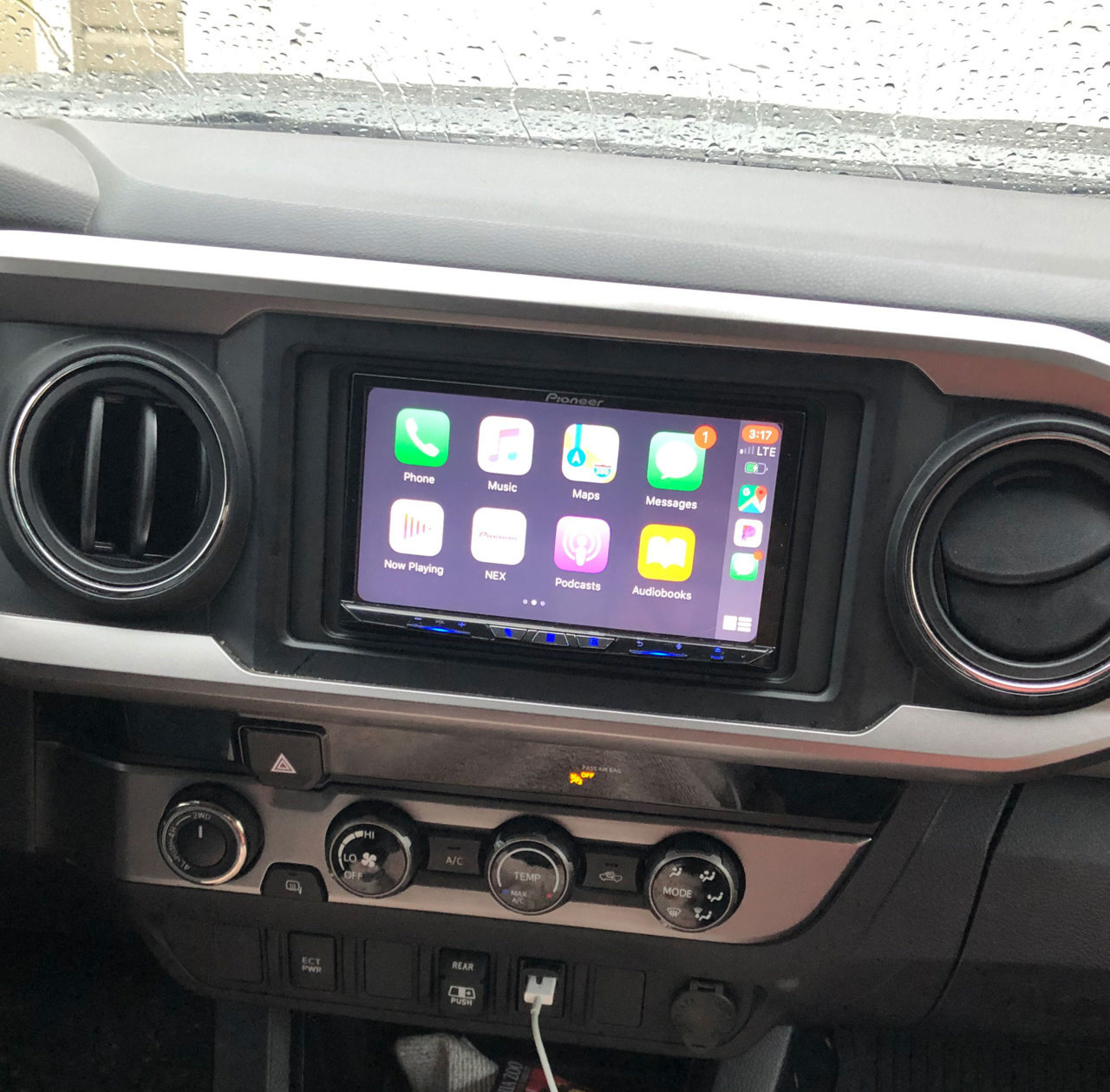

    Installed today, it was insanely easy once you splice all the correct wires. My back up camera wasn't working at first... The plug wasn't fully seated into the head unit though. Also, the stock speakers sound great now

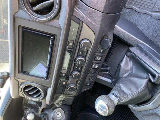

    Ask and you shall receive. Not as clean as OPs install but it'll do

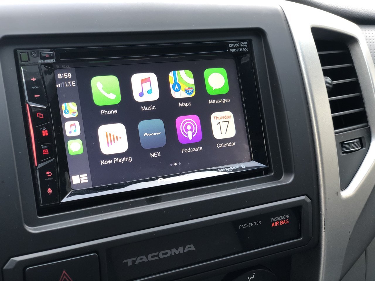

    Looks good. I finally got mine installed too. My metra dash kit didn’t come with the right surround so there is a tiny gap below the radio.

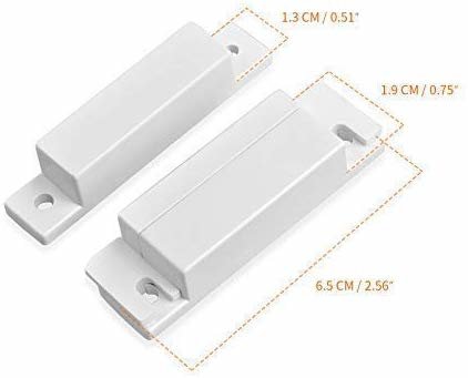

    The reason why I asked about the by-pass is because I came up with my own solution when I installed a Pioneer DVD receiver in my pop-up camper. I used a proximity sensor from an alarm system and connected it to the emergency brake trigger circuit from the stereo. Cost was $2. Just mounted it on the door into the cabinet where I installed the stereo on the left side. Just had to cycle(open/ close) the door and I could get video displayed on the screen.

    Here is my install. Can’t really see the gap as bad. AVH1300-NEX. Backup camera, Apple CarPlay and XM. Also a Micro Bypass is a must.

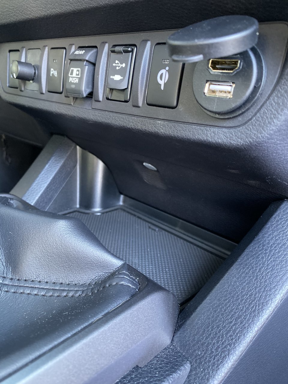

    E0246FB4-ECCF-4175-860B-5182914B43E5.jpg Finished my radio install. Got the AVIC-W8500NEX with Maestro and all the add ins necessary thanks to this thread. Spent a lot of time on the harness, running wires, and making pig tails in case in the future I need a 12v and Ground(ready to go). Found an auxiliary usb / hdmi mount that fits perfectly in the cigarette lighter socket. Ran the USB cable from the Maestro from the back to under the dash so I can flash it again if need be. Special thanks to @destin_meeks for taking time out of his day to answer my dumb questions and showing me some things. With the mount I can connect hdmi and android auto if need be.
