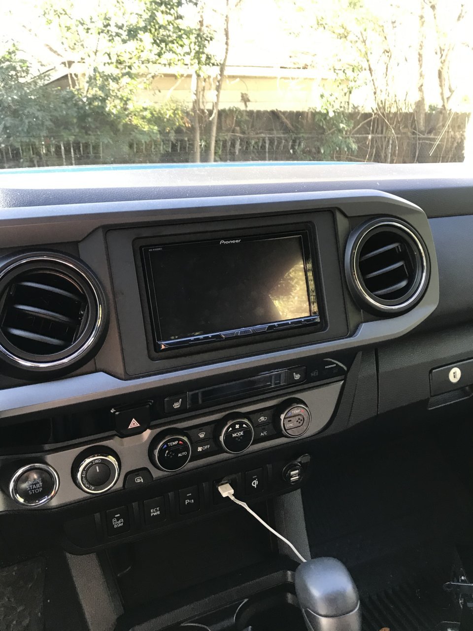

    3E349D41-AEB8-4F0B-8FCC-91628B3D5525.jpg Here’s the install I did on X-mas eve. W4500NEX
