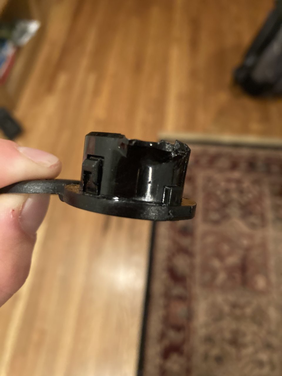

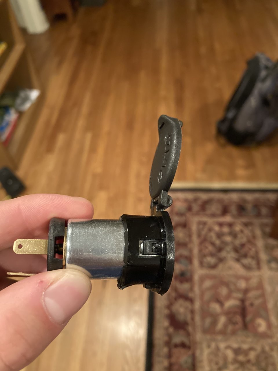

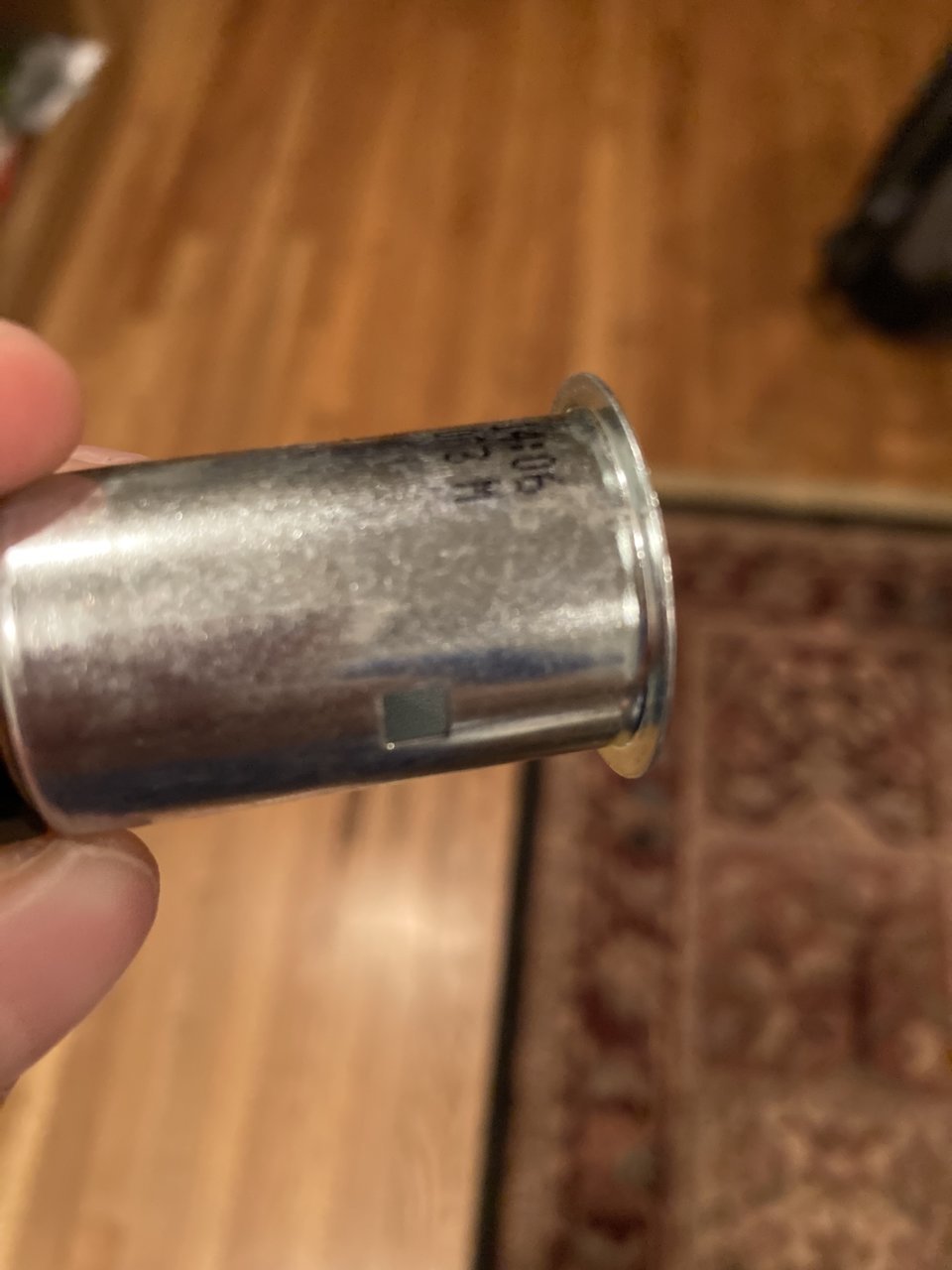

    @AM330
    I got the 6 foot version of this. Honestly maybe the 3' version would be ok? I ended up coiling a few feet of it with zip ties beneath the wireless charger. I followed this guide to remove the different sections of the center console. Theres a chrome delete guide some where that goes into more detail. Getting the old cigarette lighter out was a pain in the *ss. I ended up ripping it out with needle nose pliers because I didn't understand how it attached and its extremely difficult to see the pins. Turns out there are tabs you push in and can pull it out fairly easily. This is info I used. I know somebody on here describes pushing the pins in in detail, but I can't find it.
    Actually here are some photos of the old thing pulled out.IMG_1450.jpgIMG_1448.jpgIMG_1447.jpg
