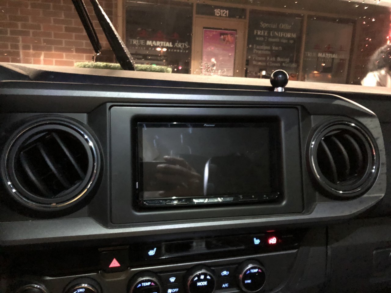

    7466F035-45A4-4294-A7AA-A1E5EB8FFD70.jpgInstalled today, it was pretty painless and relatively quick and no splicing required. The hardest part was getting the wires and contraptions pushed behind the unit. ( I have Sirius as well as the maestro ). I think it looks much better than the entune Jbl And it’s really cool to have wireless CarPlay.
    Everything works except the phone buttons and the nav/compass in the multi info display ( I guess pioneer doesn’t provide this ). The phone buttons are a Bummer - anyone got them working?

    Phone buttons work for me. I have a 2018 with JBL. Installed the AVIC-W8400NEX with Sirius.
    I was pleased with the install. I was able to attach the Sirius module with industrial velcro agains the back, below the radio.
    I attached the Maestro with large zip ties against the left brace which allowed me to get the bulk of the wires in pretty easy.
    To get the faceplate to sit flush, I used 3 washers on the bottom right, 1 on the top right and 2 on the bottom left when bolting in the bracket.
    I also ran a usb cable from the maestro, through a hole I drilled towards the back of the glovebox so I can flash the unit when needed.
    I did not install the aux. I can't for the life of me figure out what I would ever use it for. I couldn't test it if I had hooked it up. Would love to hear use cases...
    I opted to replace the 12v adapter with HDMI/USB.
    One thing that was not clear, because this was a JBL replacement, I only needed to plugin the front rca outputs to the Maestro rca inputs. The rears happen via the amp.
    Also, the blue wire from the AM/FM antenna adapter goes into the blue/white wire on the Maestro. I assume it is for the HD Radio since HD did not work when I didn't have it attached.
    I really like the fitment and ease of install. I have nightmares from installs in earlier Toyota's which is why I got the JBL upgrade. However, Carplay is a game changer for me and after reading a couple threads, it looked like a very easy replacement, which it was. Stoked!
    Thanks to everyone who has posted about this radio and install! Made it easy.
