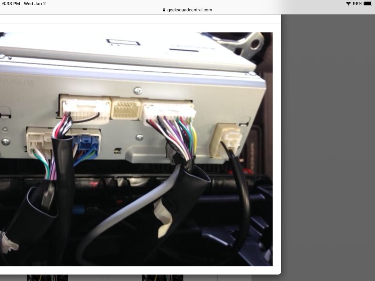

    That may the problem. I didn’t use one. I’m not seeing extra wires (presumably from the antenna) to connect to an adapter. The only wire from the truck not connected appears to the XM cable seen in the prior pic.

    So you don’t have your antenna plugged in to the pioneer stereo? If not that IS your problem. What year? Should be an amplified antenna so you need to power up the antenna adapter

    So this a pic of the back of a 2017. You should have a white connector on the right which is your antenna. You DO need the Metra adapter. That black wire is your antenna amplifier turn on wire

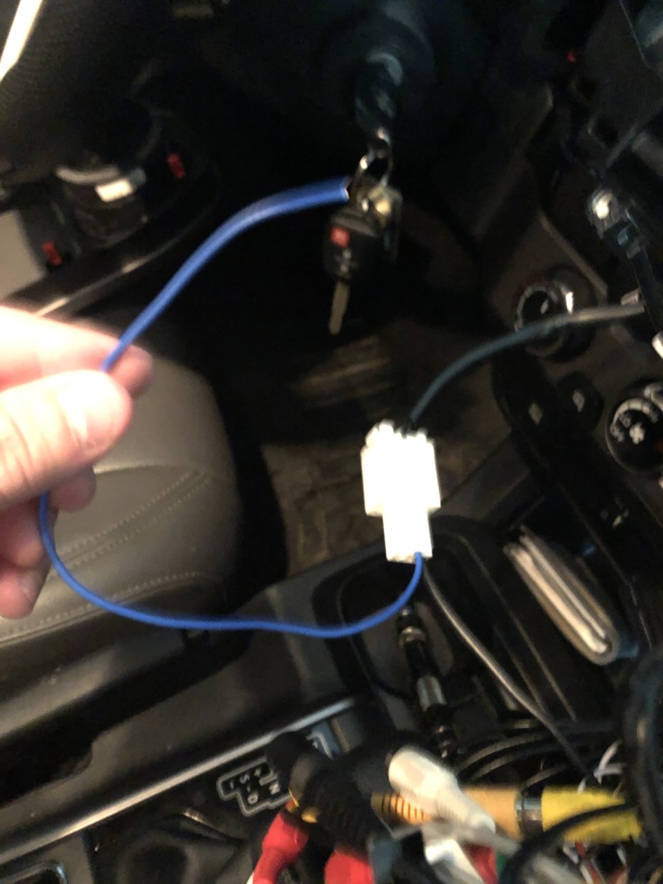

    The blue wire you are holding in your hand goes to the blue/white wire coming from the HU. There should be 2 wires that go to the blue/white. 1 from the maestro and the other from the antenna connector.

    Just in case you didn't know, Amazons picture of the Metra cable is wrong. It has one Antenna end and one blue wire. This is the accurate picture:
    https://www.crutchfield.com/p_12040...nna-Adapter.html?search=metra_40lx11&skipvs=T
    On the above antenna cable, The blue wire goes to power ( I connected it to the amp-on blue or blue/white and it works ).
    With the pioneer both the HD FM and XM reception is vastly improved with the OEM antennas.

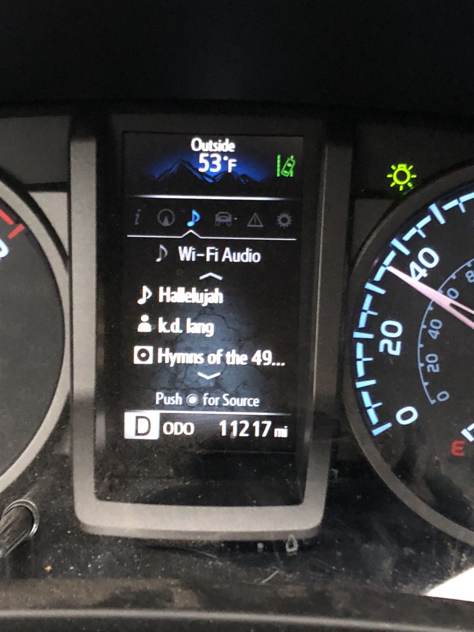

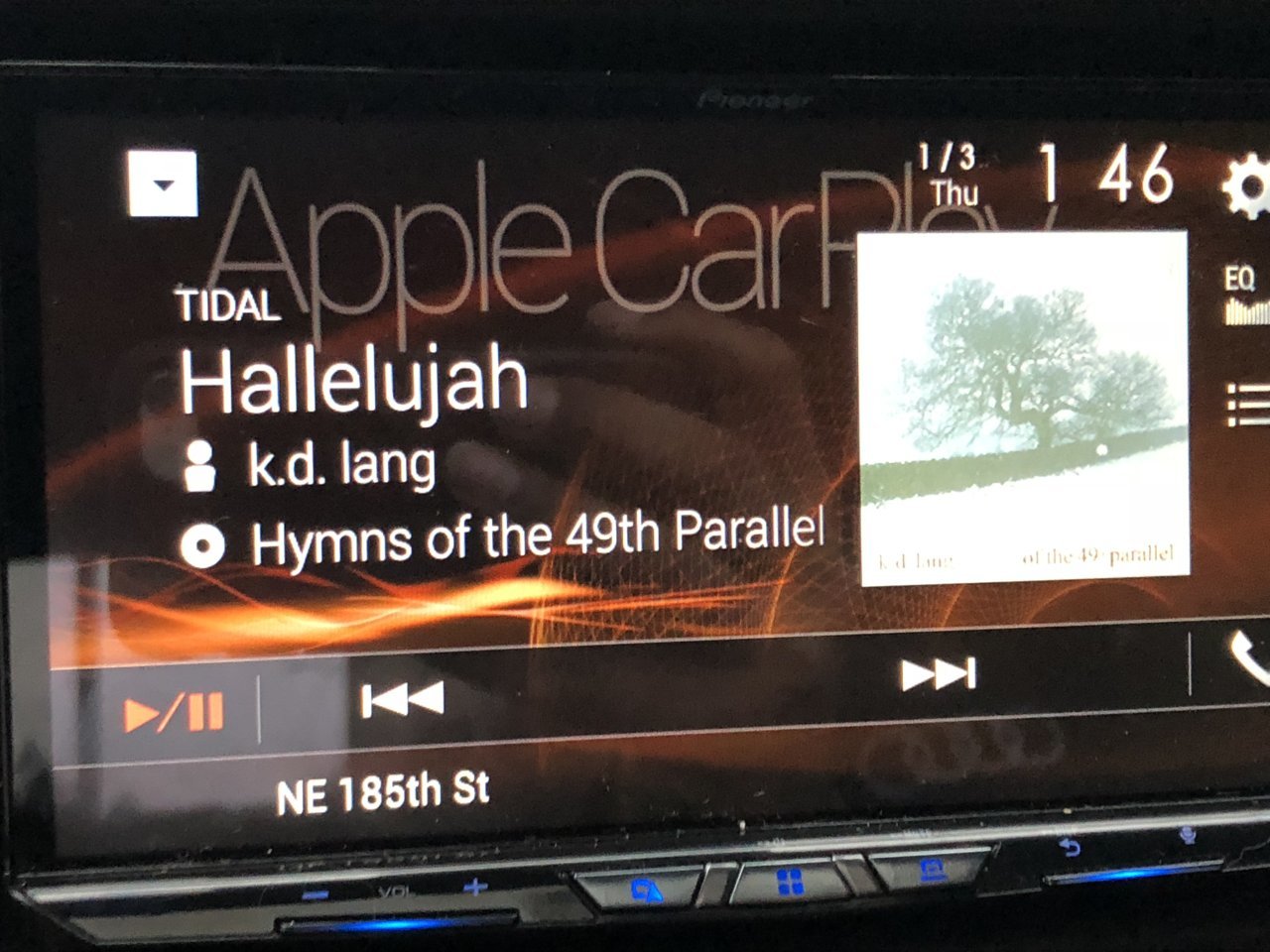

    EDIT: Talked with Maestro who said it's a pioneer issue and reported the bug to Pioneer tech support.
    Anyone seen info pop up in the steering heads up display for CarPlay? I realized it appears randomly but once there it stays. I did have luck using the source button on the steering wheel to a different source then the source back to CarPlay to get the info but haven’t tested extensively yet to know if it’s perfectly reproducible. I’m wondering whether this is a maestro or pioneer bug. In this instance I’m using tidal via CarPlay but same applies to Spotify or any other CarPlay audio source.
    And if anyone has no problem getting this on startup then it’s a problem with my unit but I remember someone else saying earlier just “WiFi” shows up.

    Wireless CarPlay works great and love the unit so far. Sound is great. Had it less than a week so no long term input to provide. My XM stopped working today but I’m thinking it’s the external tuner and not the head unit itself.
