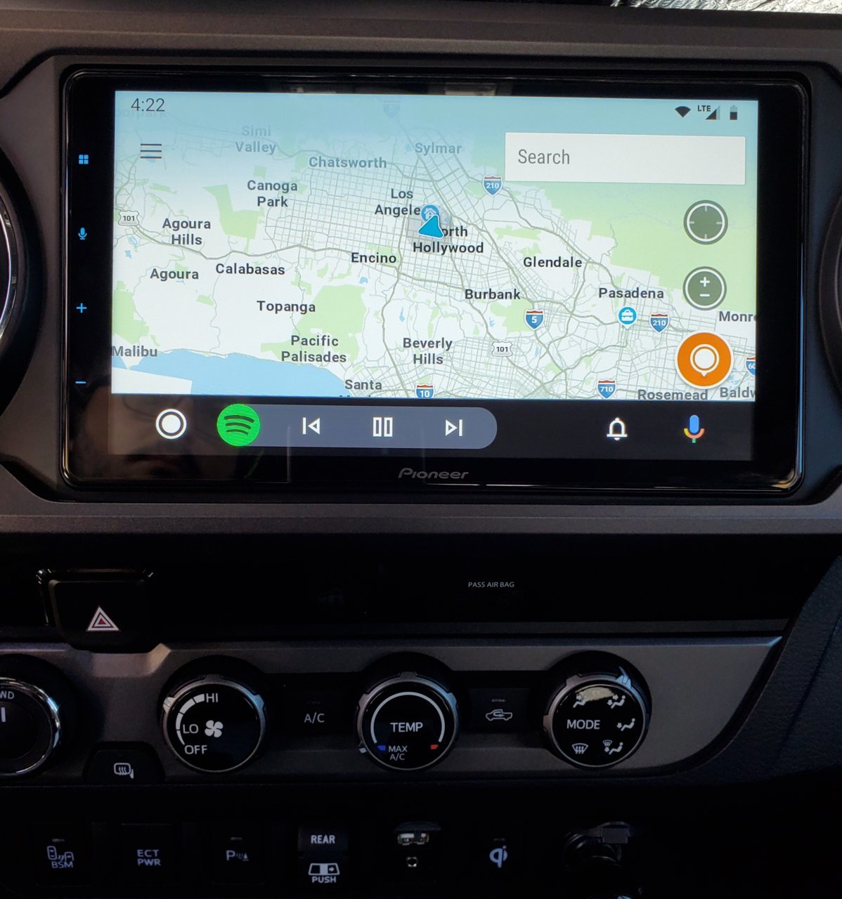

    Details about the DMH-WC6600NEX
    This is a near perfect fit for the opening on a third gen Tacoma. Offering wireless Carplay/AA, this unit outshines most competitors with it's performance, display quality, ease of use, and ability to retain steering wheel/information cluster communication. While this unit is indeed expensive, the pros out-way the cons in my opinion.

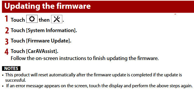

    Firmware Updates:
    This head unit uses the CarAVAssist application for Android and Apple devices. You must use this application to install the latest firmware, however, the process isn't exactly easy to understand initially. I was able to update the firmware after following the steps outlined below.
    DMH-WC6600NEX User Guide
    Connect your head unit to your Phone's Hotspot
    Once the unit is connected to the Hotspot, download the Firmware update on your phone and connect them both via USB.

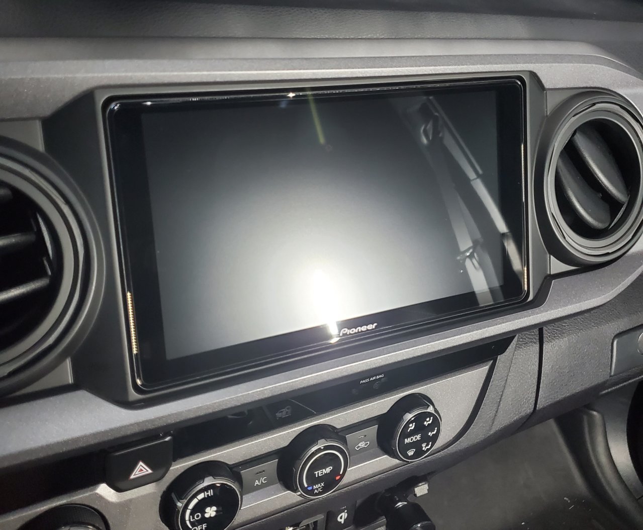

    *Mounting Brackets
    *Old*
    I was able to mount the unit and have it sit as displayed in the picture above using the American International kit. Some members have commented stating that the OEM brackets work as well, however, I wasn't able to align it correctly and was happy with the AI bracket, though, some modifications were required. The AI brackets have a strange inward-facing piece of plastic that gets in the way. I twisted these off from the brackets and everything now sits well.
    *New*

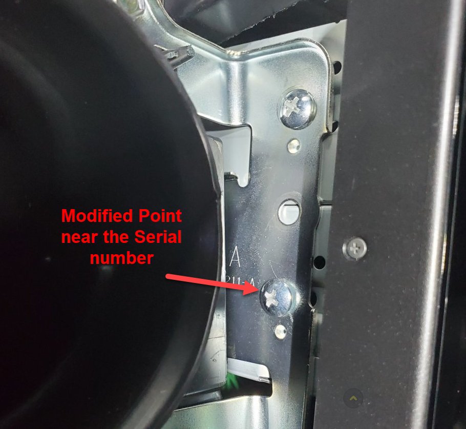

    I was able to finally have the unit sit completely flush by modifying the OEM bracket from the original Entune radio. After overlaying the OEM bracket on the AI bracket, I marked the spot for where the additional hole was needed and drilled myself a new mounting point. I then added 4 hex nuts behind the screws for where the bracket sits, and bolted the unit down. The end result was exceptional.

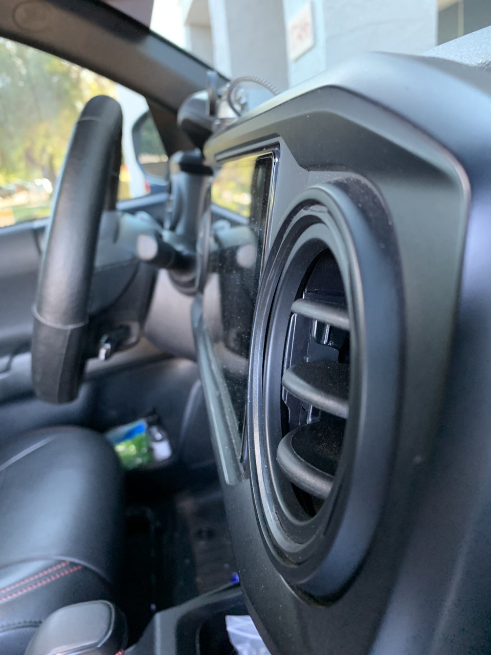

    It’s not going to be completely flush. This is a modular head unit so I’m sure you could figure out a way to mount it flush if you really wanted to.
    He’s a pic of how much it sticks out mounted as a single din unit

    My sticks out like that too. Just making sure I did it correctly. Thanks.

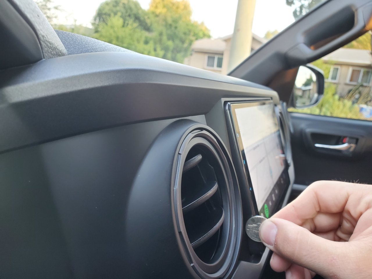

    Mine sticks out, though its kind of angled, which I don't mind at all. Viewing it actually looks great, fits in with the design of the truck.

    I had to modify the stock brackets. Was able to get it. Took more time than wiring. Lol
