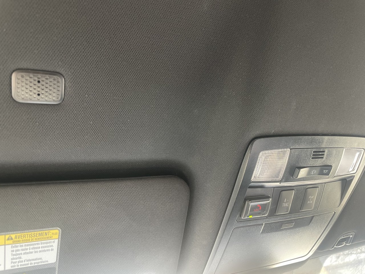

    I changed my non-JBL 8” TRDOR head unit to a Kenwood using a Maestro RR. I never had turn by turn show up in the cluster when my truck was stock. Never had a compass or speed limit either. I did not have audio show up in the cluster but after doing the head unit swap, that one works now. Aux USB under the radio works fine if you get the Toyota specific USB adapter. Console USBs are just wired to truck power and have nothing to do with radio swap whatsoever. They’re just chargers. The best mic option is the Enfig by far. You can use the radio supplied mic but it doesn’t hear very well when it’s hidden behind a panel. It’s ugly when it’s out in the open. The Enfig works great in its intended location. Routing the cable is not a big deal, I wouldn’t let that be the reason to not choose it.

    I don’t think the enfig is compatible with models where the mic is located in front of the driver’s visor. But a piece of foam and hot glue will work as others have said.

    I thought all models have that spot in the upper console?
    My factory mic (2021 OR) is by the visor but it’s unused with my aftermarket radio. I added the Enfig to the empty spot in the roof console where there was never anything there but a piece of foam.

    well, shit. lol I did not think to do that!
    It’ll be easier to do that. I’ll leave the OE mic there and just route the mic to the center.

    which spot did you route the enfig to? Not sure what empty spot in the roof console you’re referring to

    The spot in the console with the 3 lines. There was nothing there to begin with, that spot just had a piece of foam laying in it from the factory. I put my enfig there.
    My factory mic I presume is in the spot above the driver by the visor. I didn't touch anything there, since I swapped radios that mic no longer works anyways.

    The enfig drops into the spot in the console. It is not meant to go in the location above the driver. The model they sell for Tacoma, anyways.

    If i'm not mistaken, depending on the model year, the OE mic was placed in the overhead console then it got moved to above the driver by the visor.
    When I initially reached out to Enfig and provided that I have a 22 model I was told it would not work, but it never dawned on me that I can just put it in the overhead space where the enfig adapter works. I'm just waiting on delivery and a day to install it. I also have CCF to install on the roof so it'll be a whole day for me to pry the B and C pillars.

    I believe you are correct. I think the mic was there on 16-19 models before the radios were updated to Carplay models for 2020+. Either way the Enfig will definitely drop into place on a 20+ in the unused spot. Just pull the foam and done. The only sucky part is running the hardwired cable but it's not the end of the world.
