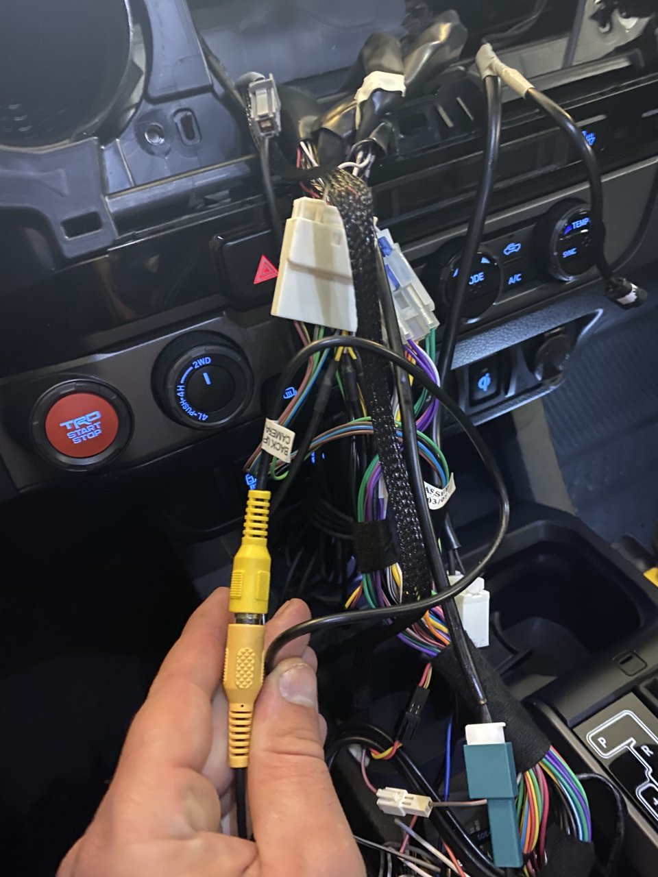

    Hi guys, I am trying to install my headunit and I cannot seem to get the rear camera to work. I have a front camera which is working but I am not getting any signal from the rear I have it plugged into the brown av wire (shown in the picture). Any suggestions on how to fix this?

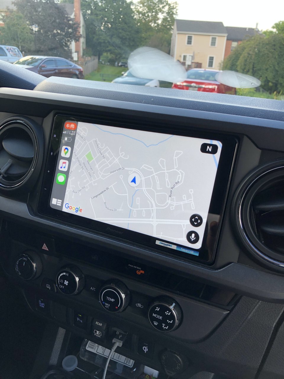

    I just installed the Pioneer unit in my 2018 Tacoma today, I do have the premium HU but is NOT JBL.
    My original radio
    Pioneer unit installed

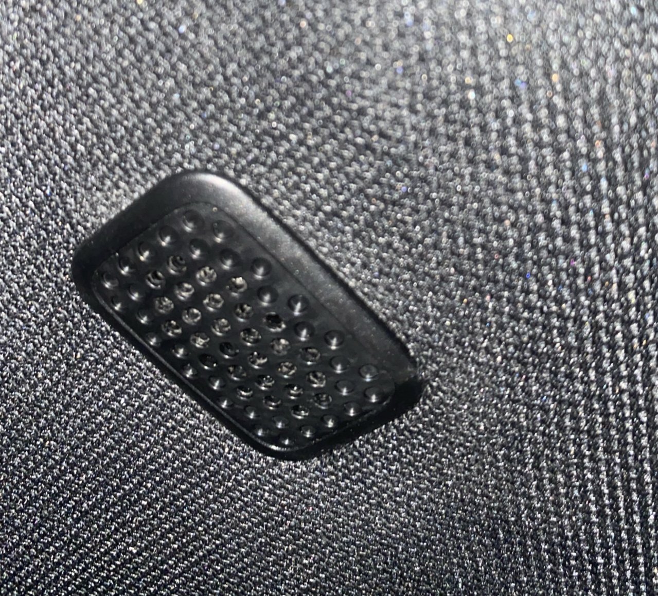

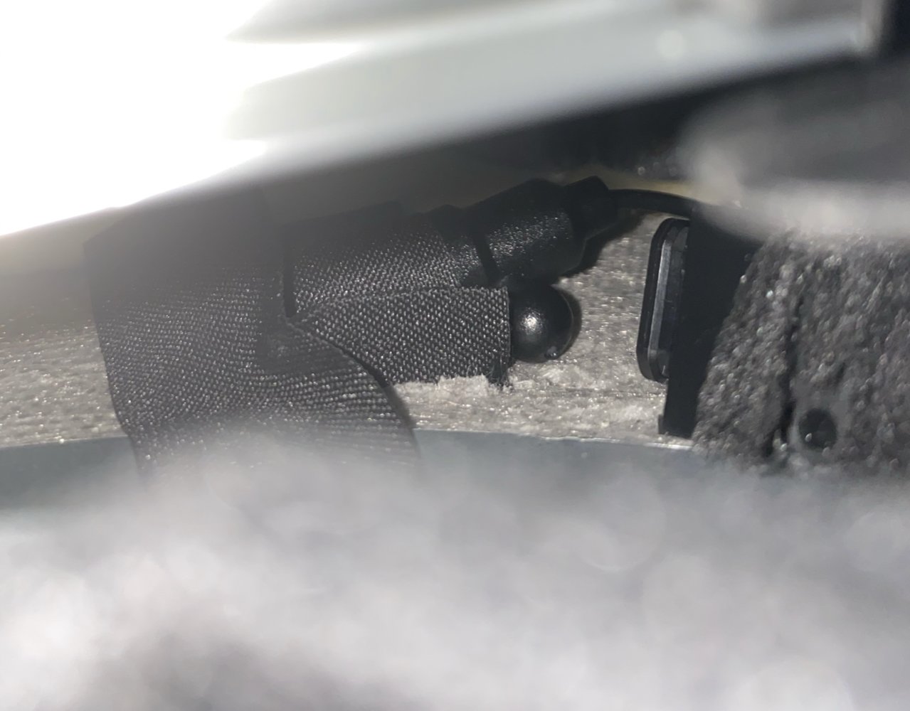

    Hidden. I wasn't sure that lying the cylindrical mic on its side would work, so I drilled out all of the holes in this little cover thinking it would help with sound conduction and then taped it down.
    Terrible picture but here's the mic taped into place looking from where the sunroof opens:
