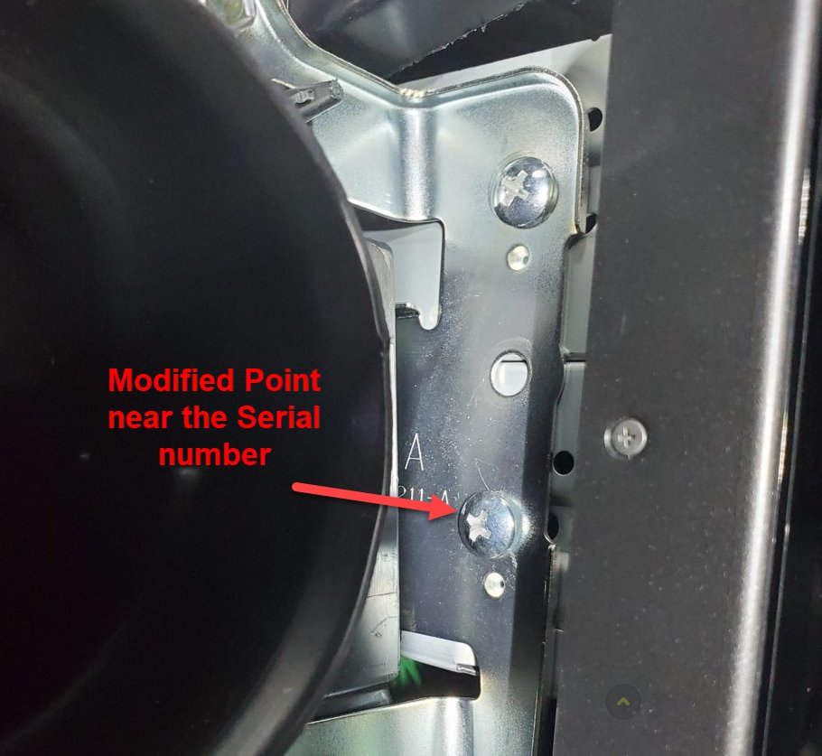

    For anyone else that wants the Radio to sit like mine, see the modified screw point in the picture below. If you modify the bracket point to be exactly like mine shown here, it'll sit nicely. Only the specified screw below needed a new hole, the one up top is OEM location. Once you do this, put some nuts behind the bolts that lock the radio in to push it forward, I only used one nut per screw to have it sit perfectly flush. This method is simple, fast, and doesn't require a lot of modification. More importantly, you keep the OEM brackets.
    Check how other users have them set up as well, mine was more of a last minute quick mod that wasn't planned haha.
