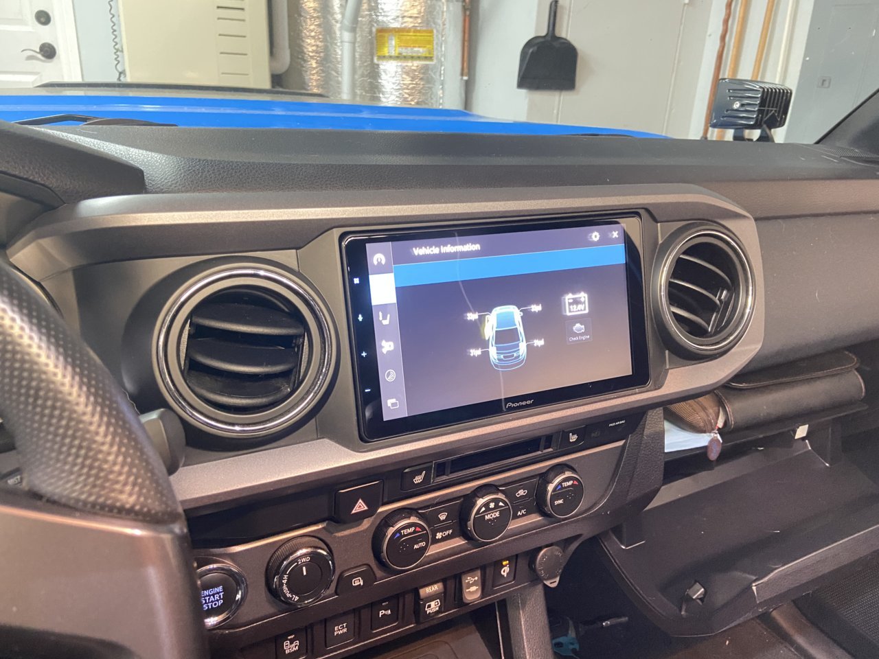

    I tried putting some washers in behind the mounting bracket but it didn’t change the angle much. Maybe some plastic spacers. Might have to fiddle around this weekend.

    Just an FYI, you can get the 5500 kit on eBay for less than $40 if you did want to start over... I feel like if you were able to tilt the bottom forward somehow it would fit a lot better.

    Thanks. I took a shot at adding some 1/4" spacers (I had to take it apart to connect GPS shark fin anyway).
    Good call! It did tilt the bottom enough to fill the gap (also required removing some additional material on the back of the faceplate). It also seemed to have widened the gap on the top a bit but I think that is fixable (filler or new plate where I don't remove too much).

    Definitely looks a lot better at that angle man! Keep us posted if you make any more modifications.

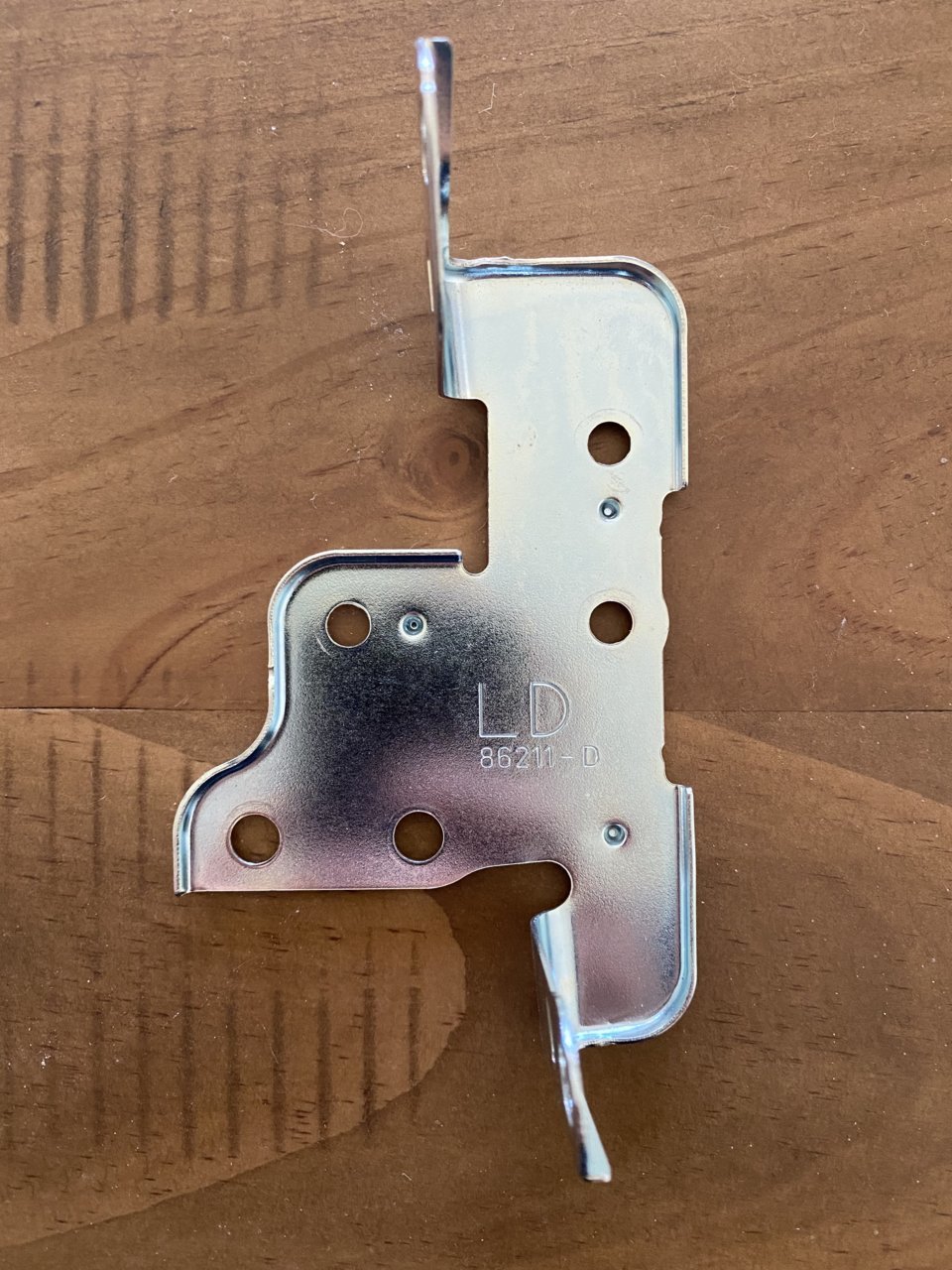

    This thread is awesome, got my unit installed today and I'm very pleased! A couple questions I was hoping you all could help me out with:
    1. I didnt use the RCA adapter Crutchfield recommends. What did yall use that for?
    2. I had the non-JBL basic HU and my mounting brackets were different than those with the Entune touchscreen radio. Any idea where you all would recommend buying the factory brackets for the entune radio?

    For 2, photos? I thought all the head units used the same metal brackets. I can direct you to a link with photos of the brackets and how I mounted my 6600 if that's of value?
    The RCA to 3.5mm adapter is used if you want to keep the OEM USB + Aux-In 3.5mm jack which is done as a size small Toyota switch (in terms of form factor). With wireless carplay it's nearly useless unless you have some old school ipod or mp3 player you wish to use.

    Thanks, I figured that was the case. See photos below, and if you could shoot a link with photos that would be great!

    That looks exactly like mine.
    Photos in this post.

    Thanks, there are few minor differences. But I was eager to get the unit in and working and just ended up using the AI brackets. I have to crack it all open again to install the XM tuner at some point so I will probably try to drill some new spots based on those pics - thanks!
