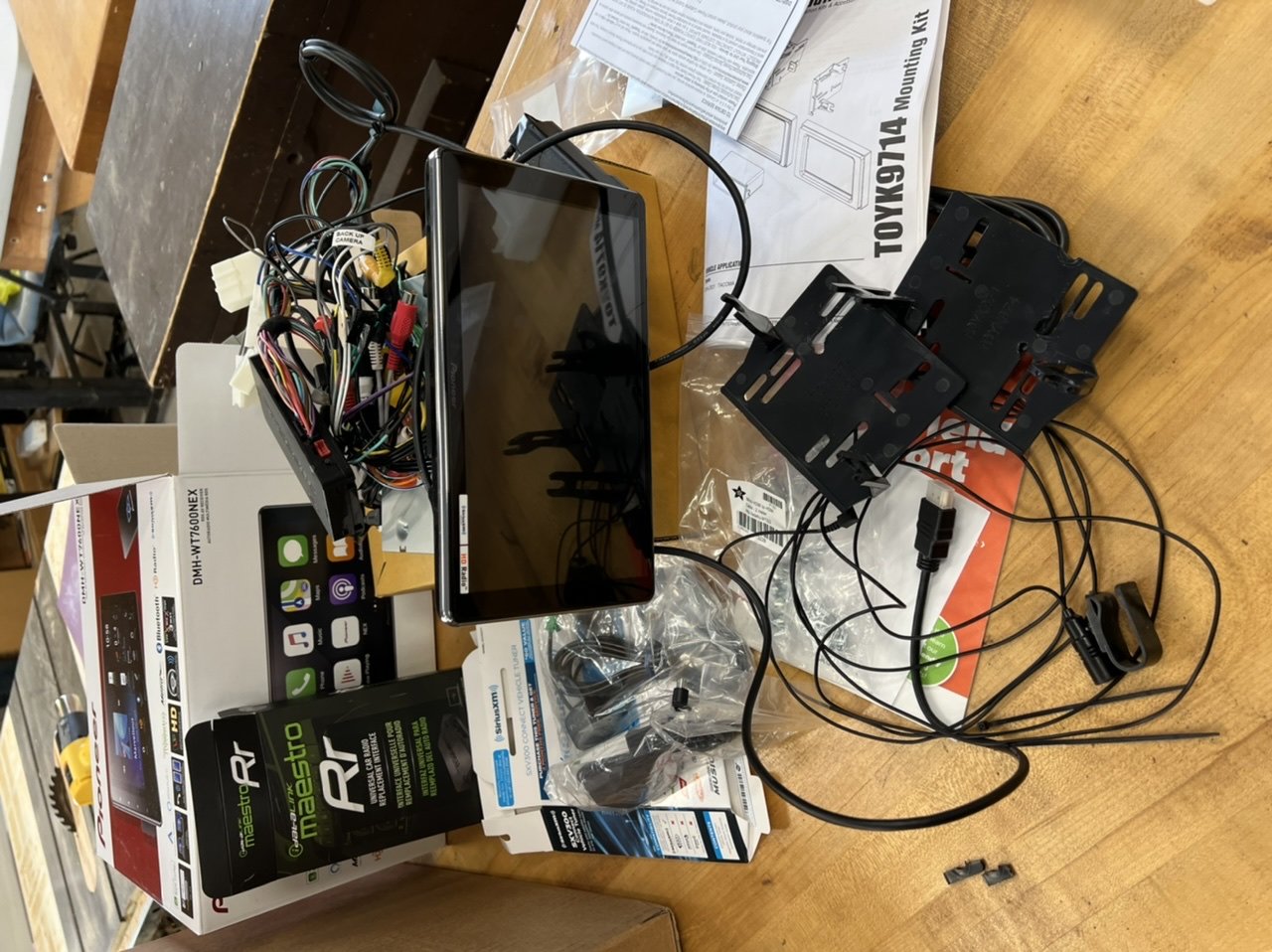

    I have a 2019 DCSB OR Manual

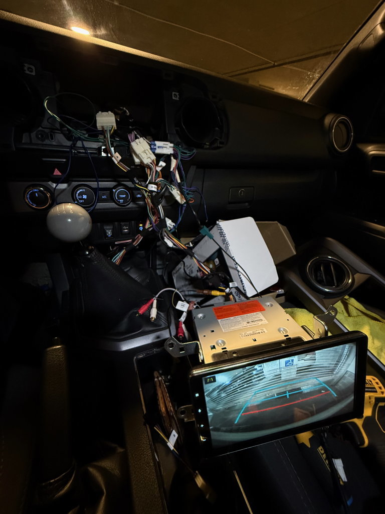

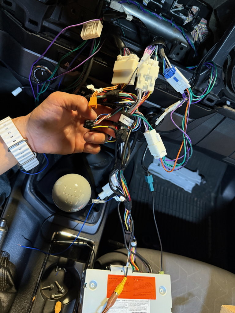

    Anyone have trouble getting their OEM rear backup camera to show up? I put it in reverse and it only shows a black screen. I made sure the yellow RCA is plugged into the brown female RCA that came with the Pioneer head unit
    I followed the yellow RCA cable and it ends at an 8-pin black connector which I'm not sure what it plugs into.
    In the second picture is this plug coming from the vehicle harness which I can't figure what it plugs into.
    Everything works as expected except the rear view camera.
    Parts used:
    * iDatalink MAESTRO ADS-MRR + HRN-HRR-TO2 T Harness
    * iDatalink MAESTRO PI01 Adapter Harness
  17. Oct 27, 2024 at 10:18 PM
    #37
    SAND_IT!
    SAND_IT! Well-Known Member
    Sep 27, 2019
    #306428
    58
    PDX
    2019 Quicksand TRD 4X4 OR
    Virgin...for now!
    omg...I figured out...by reading the (correct & updated) manual again. Attached the current PDF, in case anyone needs it.
    Now I can go to sleep.
