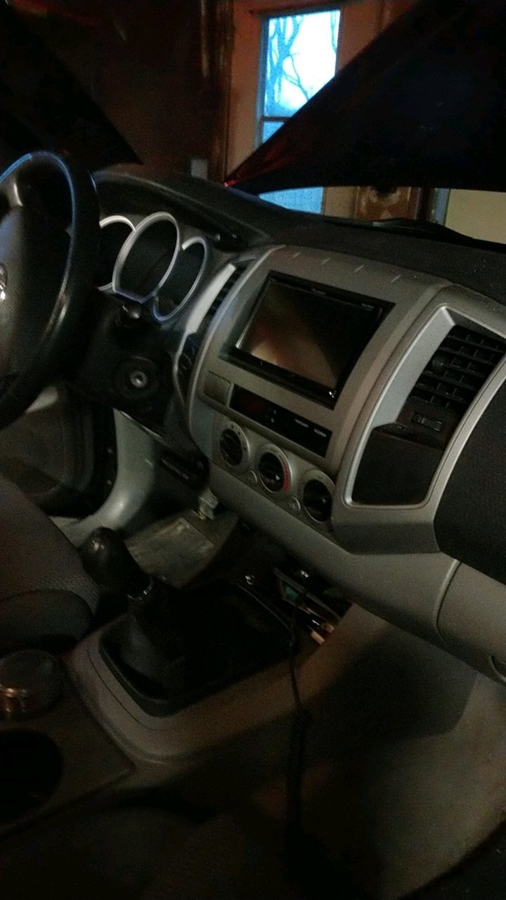

    I finally pulled the plugged and brought my Tacoma up into the 21st Century. Wanted to stream music and use Andriod Auto. Cost about $600. The wiring and such was a bit more than the Pioneer Unit. Take your time and read the instructions!!
    Get yourself a Harbor Freight 100watt soldering iron and shrink tubing. You won't use all the harnesses/wires from below but keep them. Took me about 8 hrs. I ran the backup camera through the floor where the parking brake cables go through. There was a nice rubber stopper in a hole no one was using (very nice).
    The steering wheel controls seem a bit sporadic. Will need to do some research. May have mistaken a zero for an "O" in the serial number. Will research that later but all works.
    Pioneer Unit (anyone will work but this one seemed to have the best combination):
    https://www.amazon.com/Pioneer-AVH-...577364086&sprefix=pioneer+2400,aps,140&sr=8-1
    Trim (re-use the mounting brackets with the radio):
    https://www.amazon.com/SCOSCHE-TA20...---------&vehicleName=2007+Toyota+Tacoma&th=1
    Interface so the steering wheel controls work and plugs into the ODBII reader. Expensive but worth it:
    https://www.crutchfield.com/p_794ADSMRR/iDatalink-Maestro-RR-Interface-Module.html
    Harness to link to the Tacoma and Mestro:
    https://www.crutchfield.com/p_794HRRTO1/iDatalink-HRN-RR-TO1-Factory-Integration-Adapter.html
    Instructions (helpful):
    https://www.crutchfield.com/p_264MASTER/Crutchfield-Vehicle-specific-Instructions.html
    Backup Camera (a must):
    https://www.amazon.com/eRapta-ERT01...K227R6MMTKA&psc=1&refRID=S2HYFSH3TK227R6MMTKA
    Parking Brake Bypass (so you can use Andriod Auto without the parking brake on):
    https://www.amazon.com/APPS2Car-Par...K227R6MMTKA&psc=1&refRID=S2HYFSH3TK227R6MMTKA
