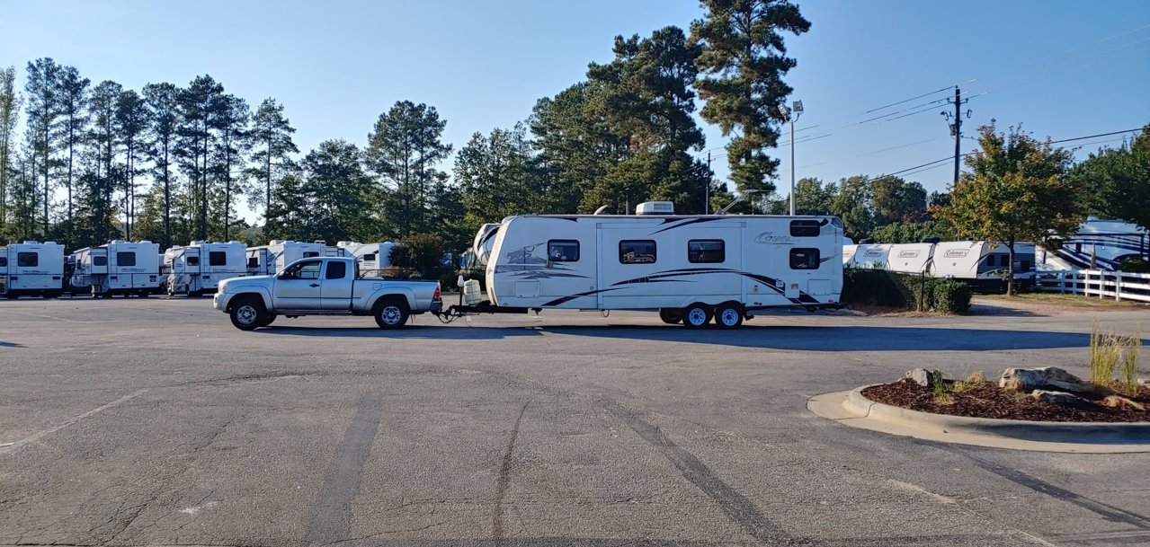

    Forgot about this one, near the end of summer, a friend of our F-150 was in the shop and he needed to get his camper to the dealer. So I hooked up my Taco and delivered it to the dealer for repair and then back to his house. That's a 31' r and with the extras I mentioned, it was a piece of cake. An yes, it is sitting flat with a WD hitch.
