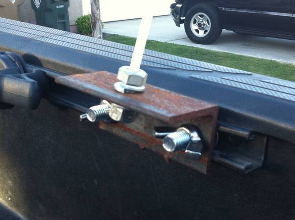

    Scrap piece of angle iron with three (3) 1/2" holes drilled in it and two 1/2" carriage bolts with wing nuts for quick removal
