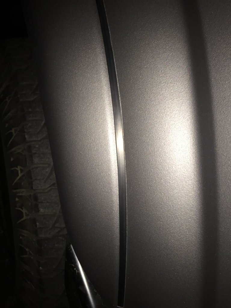

    Got around to doing the weather stripping around the flares with an exacto. Tedious but worth it.

    The area where I went around the fender flare weather stripping started to peel up (the knife pulled it up some then rain water kept attacking underneath it). Thankfully the easy solution for plastidip that's pulling up is just hitting it with some paint thinner. It laid back down. I pulled the flares off before doing that and will probably dip them black, and I need to respray around the area where I used paint thinner on the body just to clean up the texture from me smearing thinner on it. Then I'll reinstall the flares. Also the dip is starting to come up underneath the door handles ever so slightly but I will also make that lay back down with thinner before it gets any worse.

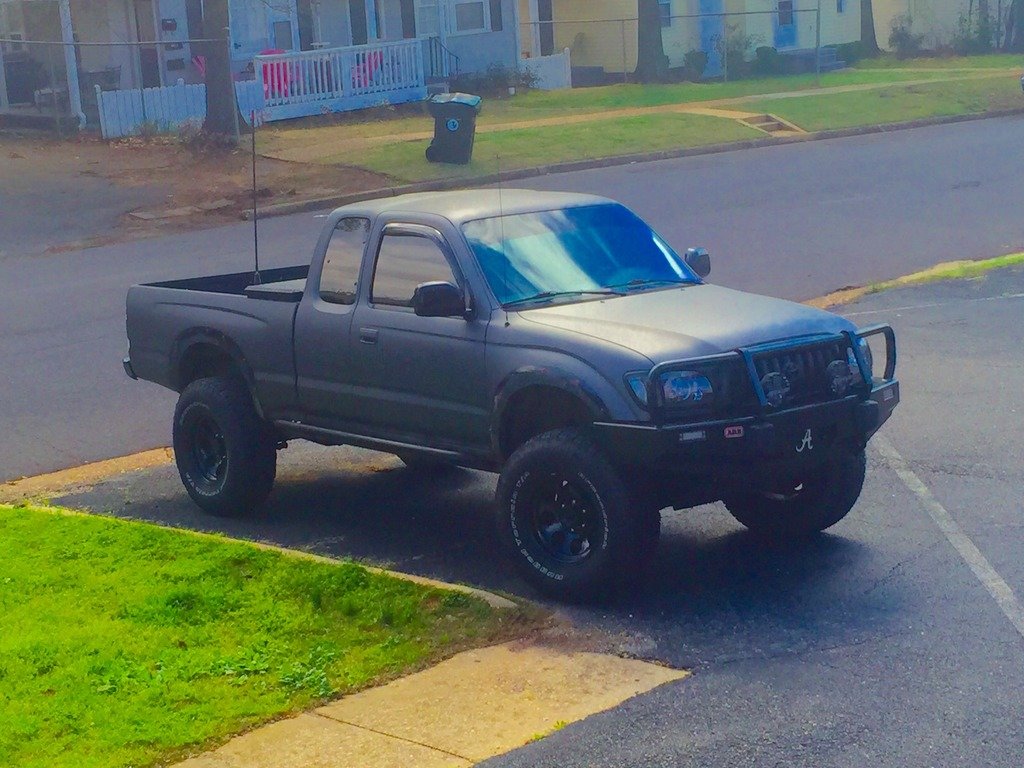

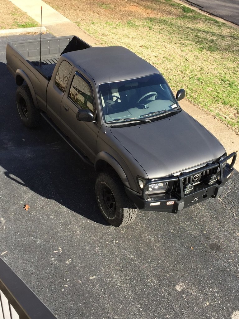

    A3E596A6-1C16-40C2-9394-05908469B135_zps_5f7cd6c6902c8f88b1387d2909b866d107ad8230.jpg
    This was before I pulled the flares.
    This is after (you can kinda see why I want to dip the flares black):

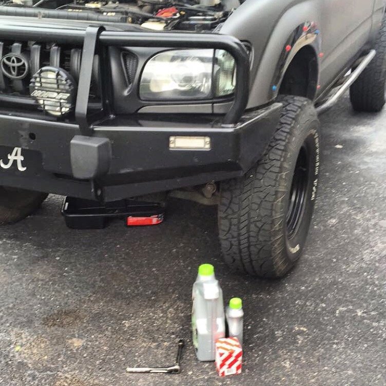

    9CD791AC-2FA8-4C5F-821E-959D479E5238_zps_14729a8bc2aec512e7bf801f39bf9588d6e6ef60.jpg
    71A6810A-3B81-42C3-8D12-37A5C04B02F1_zps_68d6e42935f403fee9f3ef460e1feaec3103b62f.jpg
    59163A63-702D-4256-877E-FA7FB5FA367C_zps_12c3a711b1f0b47d0723640a174de41e193ad469.jpg
