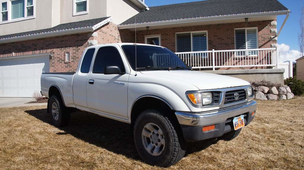

    After
    Before
    You can see the full build thread here. Also, here is my thread on the DipYourCar.com forum.
    The paint is called Super Red. It's created by using a base coat of gun metal gray and then a special red mix. It's a specific ratio of Real Red Tint into Real Red Paint and Real Red Pearls. It gives really great coverage, especially over the gray. I used regular black for the flares, bumpers, grill, cowl and even the windshield wipers.
    Quantity was as follows. These are the pre-thinned gallons from dipyourcar.com.
    - 2 gallons gun metal gray
    - 2.1 gallons super red, (I would have been fine with 2 if I hadn't broken the gun)
    - 3/4 gallon black
    I initially purchased 3 gallons gray, 3 gallons red and 2 gallons black to make sure I had enough on hand and I knew I would have future projects to put the extra paint on. You could do this project with only the 5 gallons. You could do this with only 4 if you were doing everything a single color. At roughly $55 per gallon, it's a $220-$270 project plus another $40 shipping the paint.
    Here is a video of us masking and painting. I forgot to start the camera for the first coat of red, and I missed the last few coats of red due to me breaking the paint gun.
    The final product looks great. The DYC dip coat made a huge difference it converting it from the soft rubber feel to more of a paint-like finish. I have two bottles of that, but we'll try the Turtle Ice Wax at some point for comparison. Regardless, it's probably worth the money for the 1st bottle after the dip.
    I'm trying to dig up a list of lessons learned. I'll post them up once I find it.
