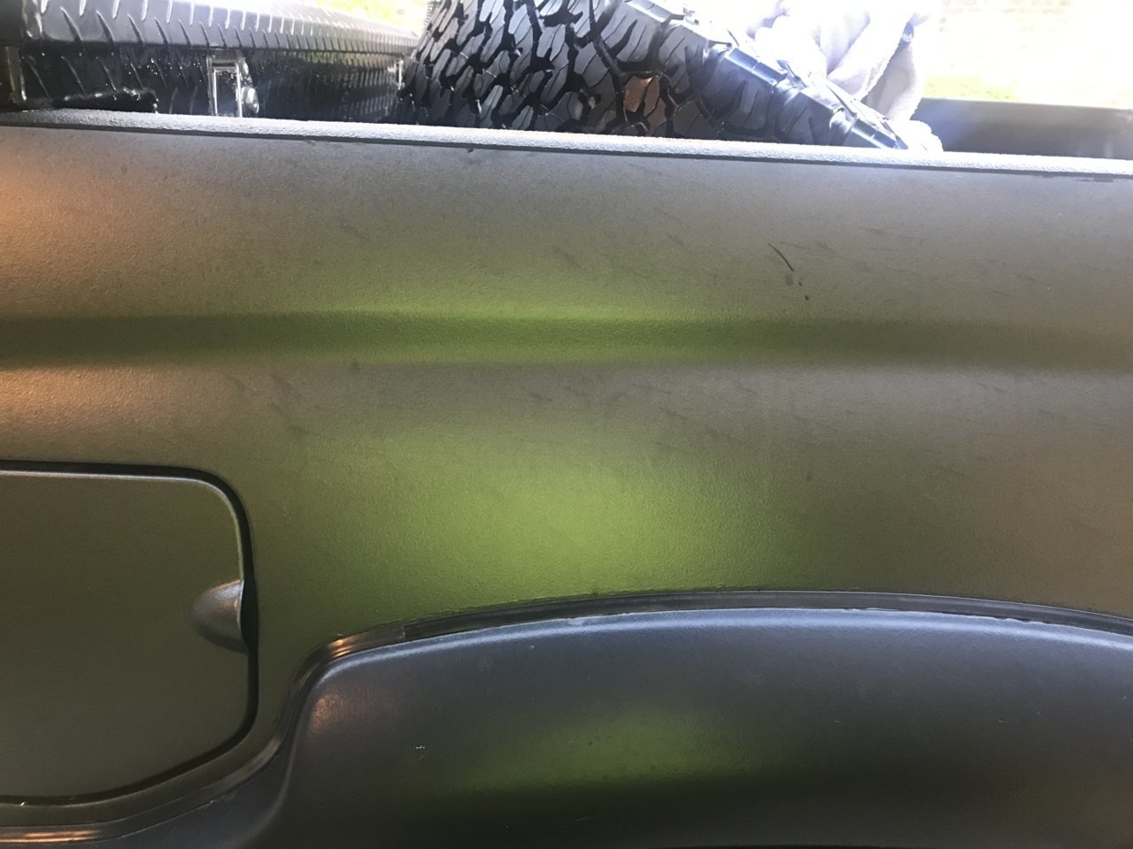

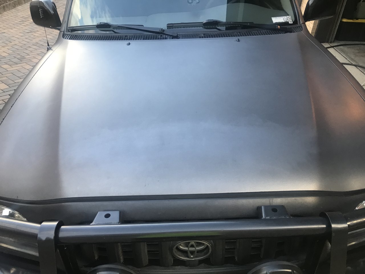

    Here's some pictures
    Weird stains from radioactive dirt (im wearing a hi viz yellow shirt ignore that)
    Stupidly used full strength simple green
    Miguel_prerunner7 likes this.
  2. Aug 29, 2018 at 5:26 PM
    #102
    Spintly
    Spintly Well-Known Member
    Mar 2, 2014
    #124416
    790
    Greg
    Home of the Groundhog
    85 Single Cab Pickup & 2000 911
    I had the similiar mud stains on mine as well. Did well with the salt, but not the mud.
  3. Aug 29, 2018 at 7:41 PM
    #103
    ThunderOne
    ThunderOne [OP] Well-Known Member
    May 20, 2009
    #17473
    10,043
    Mitchell
    Nashville
    1ST GEN OR GTFO
    Toyota NERD
    Which is weird in my case because I covered it in mud and was able to wash it off fine. I think letting the mud bake in the sun for weeks was the problem. Or the dirt was special.. it was Alabama mud that messed it up vs Tennessee mud which didn't.. the jury is out!

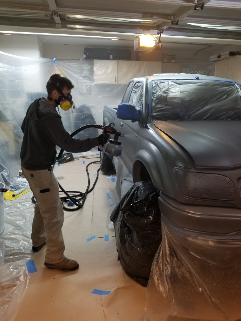

  13. Dec 1, 2018 at 5:06 PM
    #113
    branj
    branj Well-Known Member
    Mar 19, 2011
    #53337
    244
    Nate
    Paso Robles, CA
    '01 Prerunner and '16 TRD Pro 4Runner
    Getting ready to do this to my Taco. Same color. Bought the kit from dyc with the sprayer.
    CusterFan likes this.

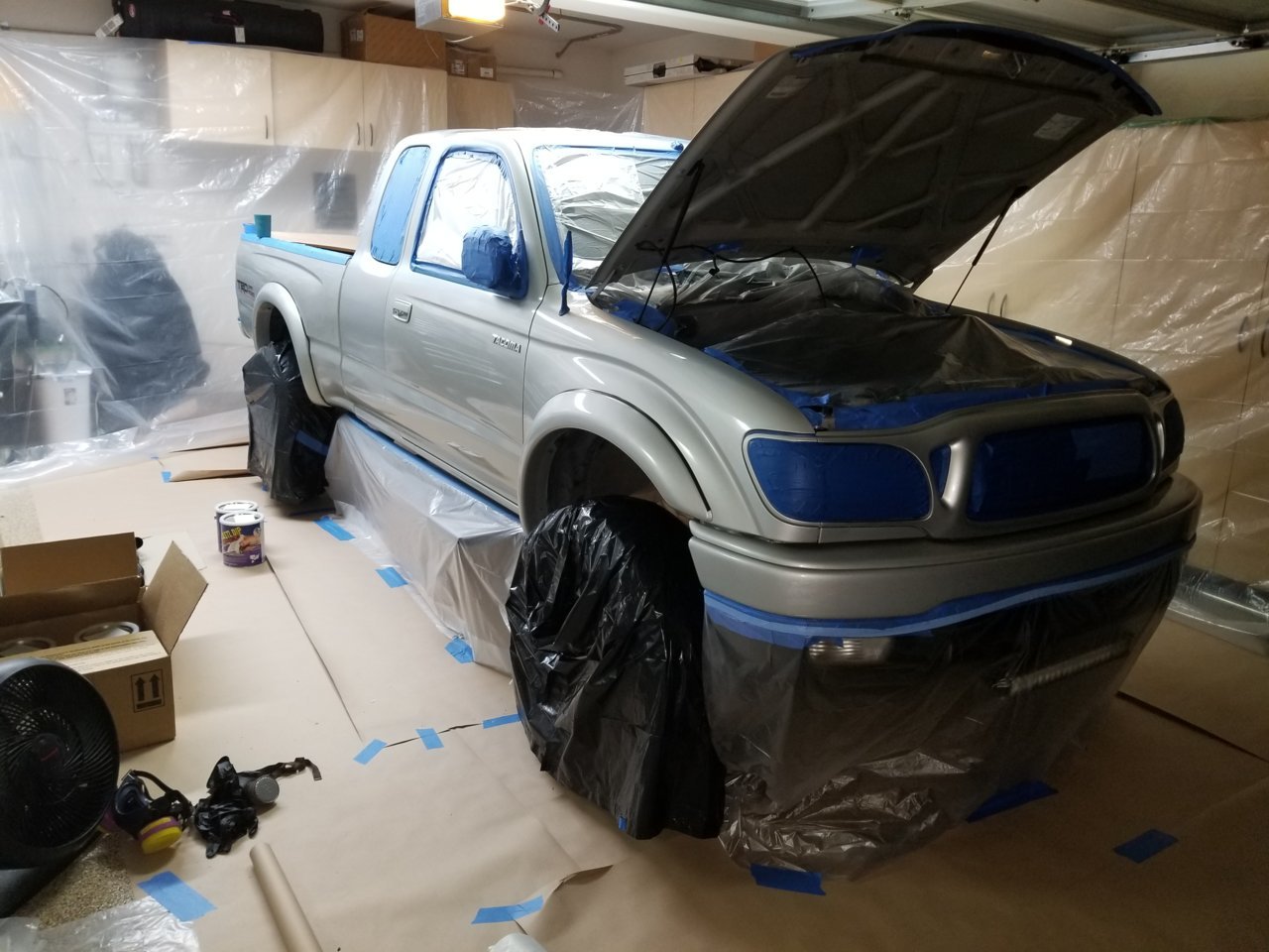

  14. Dec 7, 2018 at 12:34 AM
    #114
    branj
    Mar 19, 2011
    #53337
    244
    Nate
    Paso Robles, CA
    Prepped and ready to go

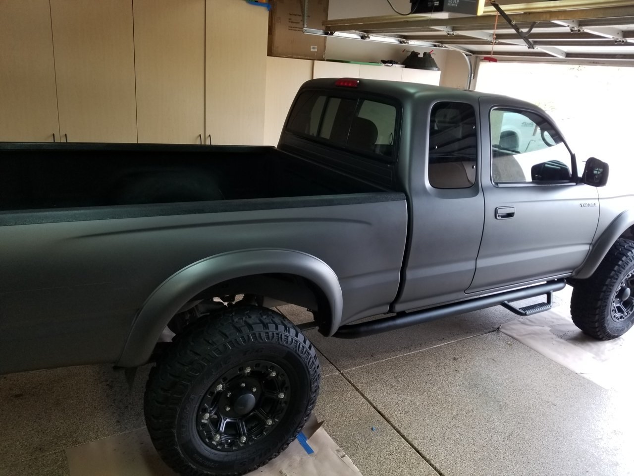

  16. Dec 9, 2018 at 1:15 PM
    #116
    branj
    Mar 19, 2011
    #53337
    244
    Nate
    Paso Robles, CA
    Just waiting for it to cure

  18. Dec 12, 2018 at 10:54 AM
    #118
    ThunderOne
    May 20, 2009
    #17473
    10,043
    Mitchell
    Nashville
    1ST GEN OR GTFO
    Toyota NERD
    Looks good! I would have suggested removing the flares though, the weather stripping between the flares and the body will move around a little and it will make the dip pull up some. I tried to exacto it off, but it was pain. I ended up removing, touching it up and spraying the flares black, then reinstalling. That's the only part that really gave me issues, other than the door handle area.
    What are your thoughts on the DYC sprayer?
    fanchaztik likes this.
