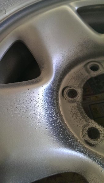

    I've encountered a bit of a dust problem on one of the wheels (or is that chunky spray?)
    Is there a way to remedy this?
  9. Jun 8, 2013 at 4:19 PM
    #69
    Soft Taco
    Soft Taco [OP] Team Oil Drop
    Sep 11, 2011
    #63293
    556
    Tyler
    Colorado Springs, CO
    2016 4WD Auto DCLB TRD Sport
    Chunky Spray. Wipe off. Clean sprayer nozzle/opening using mineral spirits or paint thinner. Shake can well. Continue. Even the chunky stuff dries relatively flat when a fan is used.

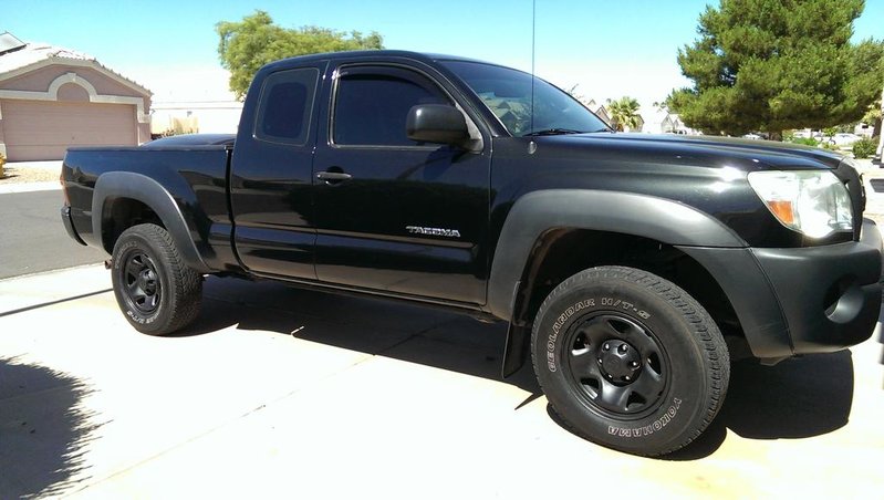

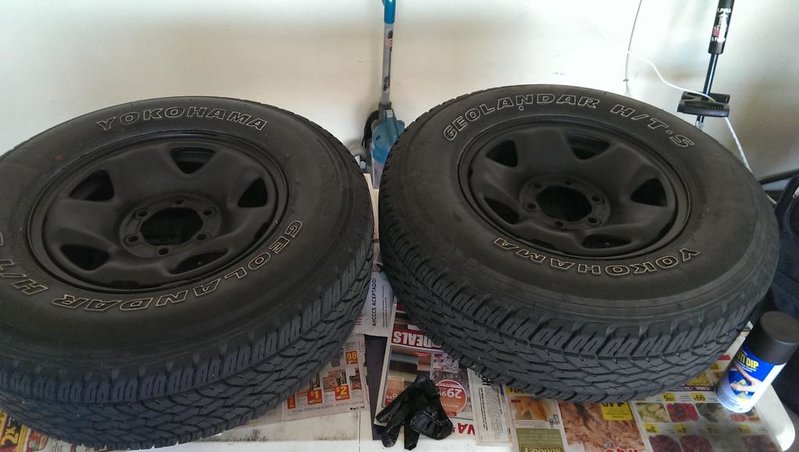

    Finished. :tumbleweed:
  12. Jun 11, 2013 at 10:09 AM
    #72
    Soft Taco
    Sep 11, 2011
    #63293
    556
    Tyler
    Looks great! Enjoy the blacked out wheels.
