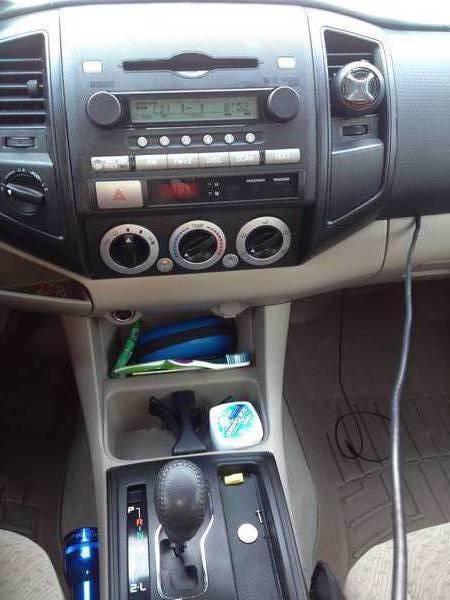

    it goes on easy and doesn't bubble. the more coats the better.. i think i used 5-6 coats on all my interior. The trick is masking everything off; i've found with plasti-dip that you want to mask less on the edges, because you can rub off overspray, but the P-D has a habit peeling off with the painter's tape and coming off of the plastic components. if you over taped and this happens, you can use a razor to separate them, but that's definitely not ideal.
    here's my P-d interior

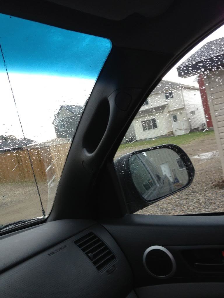

    Steering wheel steering silver handles:
    Oh shit handles.
    HandleandPanel-Black-Installed-Passenger_8ab2011185d150c5fec55522b22c2e986206f98d.jpg

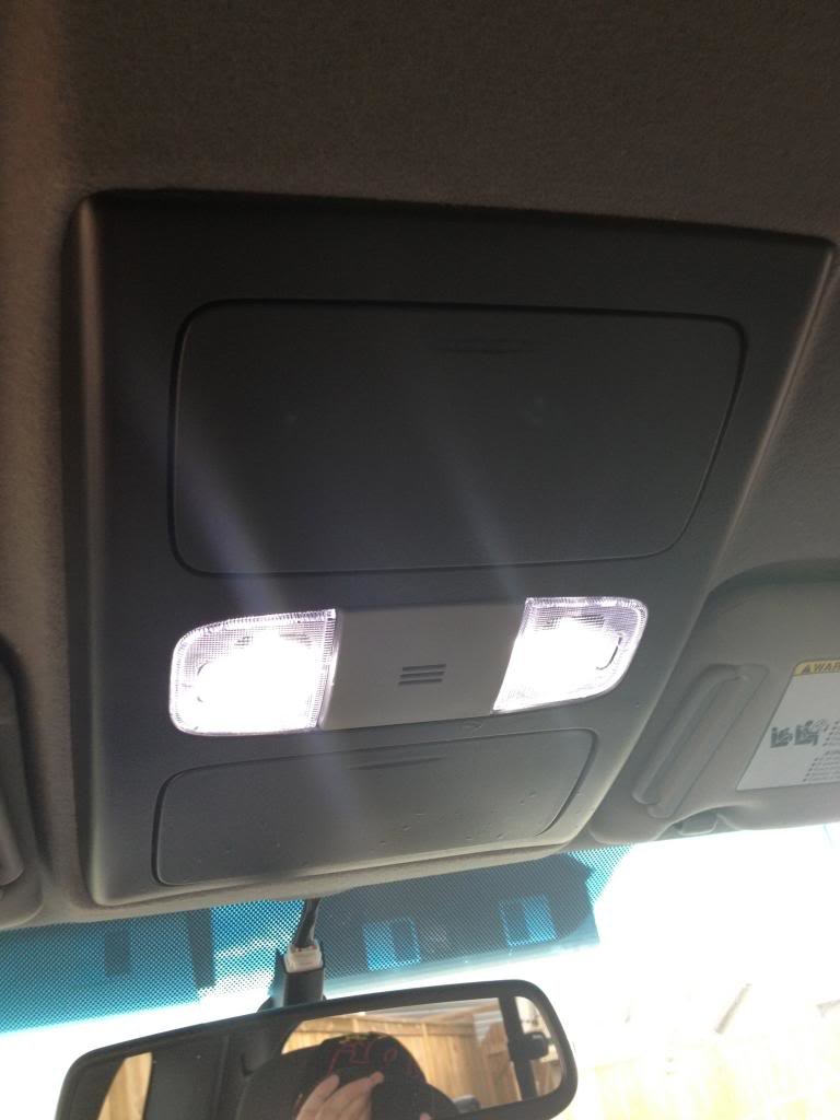

    Overhead console:

    The oh shit handles and console look stock still?
    The steering wheel looks cool though.

    They're actually black. I know it's hard to tell because it was cloudy and rainy outside when I finished the project and took the picture.
    Since that I used a stock nozzle that came in the can, there wasn't enough coats on the steering wheel, even though I did 6 coats. It came off within 2 weeks and I removed it. I am going to redo it eventually and get better nozzles.
