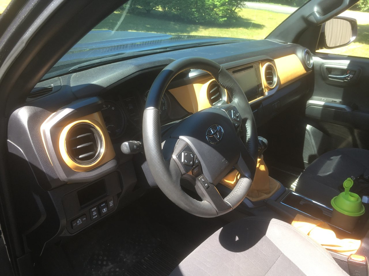

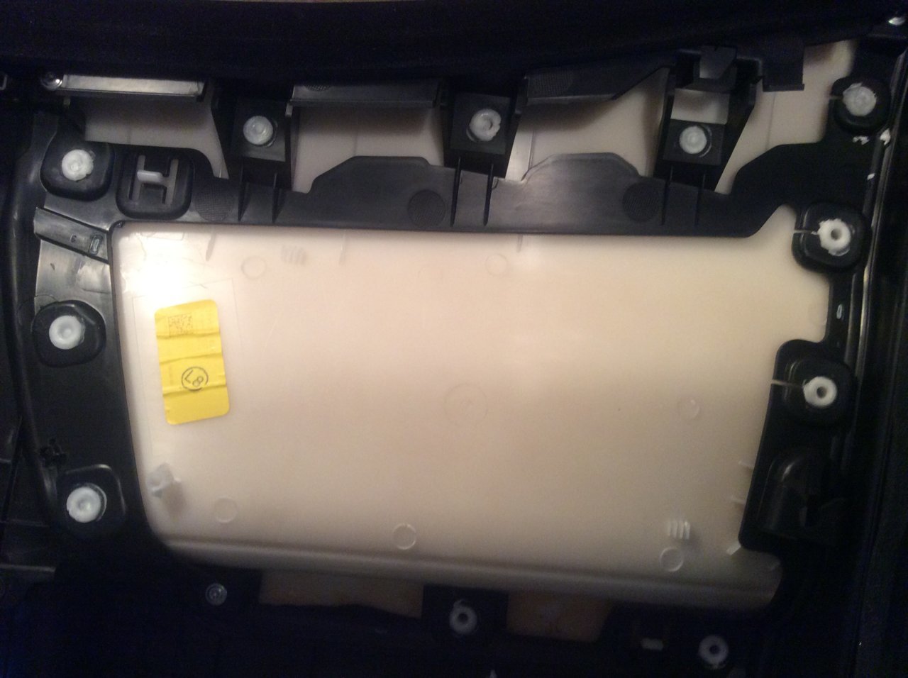

    has anyone dealt with these? Removed and replaced interior trim pieces that have them? This is what I have so far. I want to continue the stripe down the top of the door panels but just the same thickness as the dash stripe with the lower half in black. A harbor freight plastic welder might be handy. Stupid little things are intimidating me!!!F71FA594-686F-40DF-B438-F542215025C0.jpg6EA3D924-4D26-47F0-81E1-3592CC876CA5.jpg

    Typically most just cut the back (melted part) off and then glue or epoxy the tab back in place.

    Does the melted over stud bond with the underlying plastic or just sit on top of it?
  9. Aug 12, 2019 at 8:58 AM
    JaCado
    JaCado Sutton, Popcorn Sutton.
    Aug 29, 2016
    #195947
    25,074
    Jay & Silent Bob
    All weak moderators leave the room, you know who you are.
    Just sits on top from what I have seen when I pulled my dash trim.

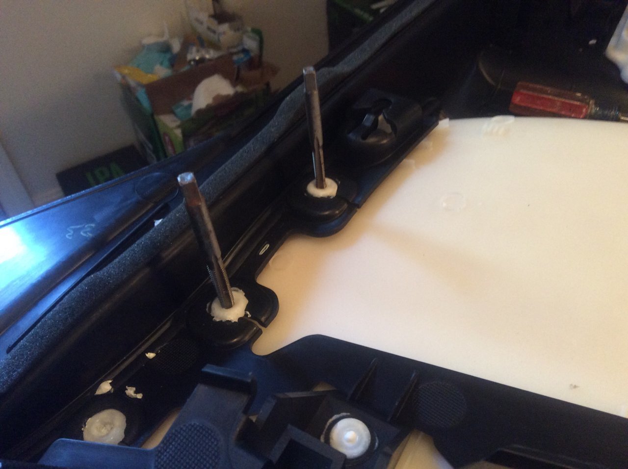

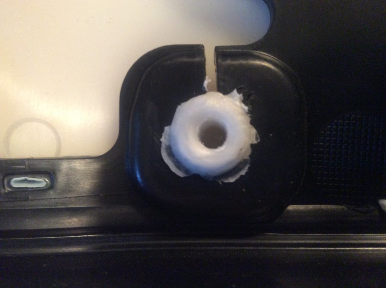

    image.jpg image.jpg These little bastards. If you can’t help keep scrolling!

    I would just pick one to experiment with and figure it out.

    When I do those, I heat them up with a lighter, while pulling it apart. This keeps most of the plastic there when you need to melt them back over. Some trimming will be required to reinstall them, but its minimal.
    Also I use just my soldering iron to remelt them.

    That’s where I am now. 5x0.80 or a 6x1 threading, maybe. Course thread screw like the rest of the interior. It depends on what the mounting hole size is.image.jpg
